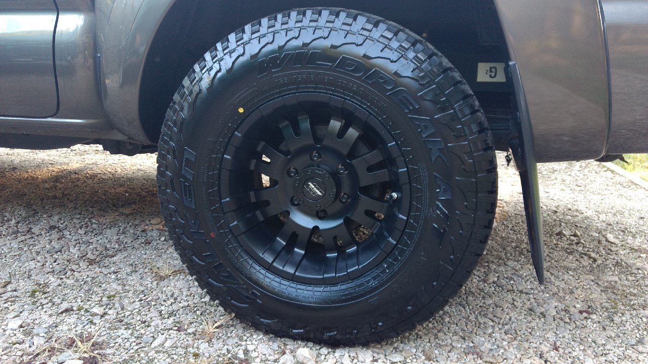

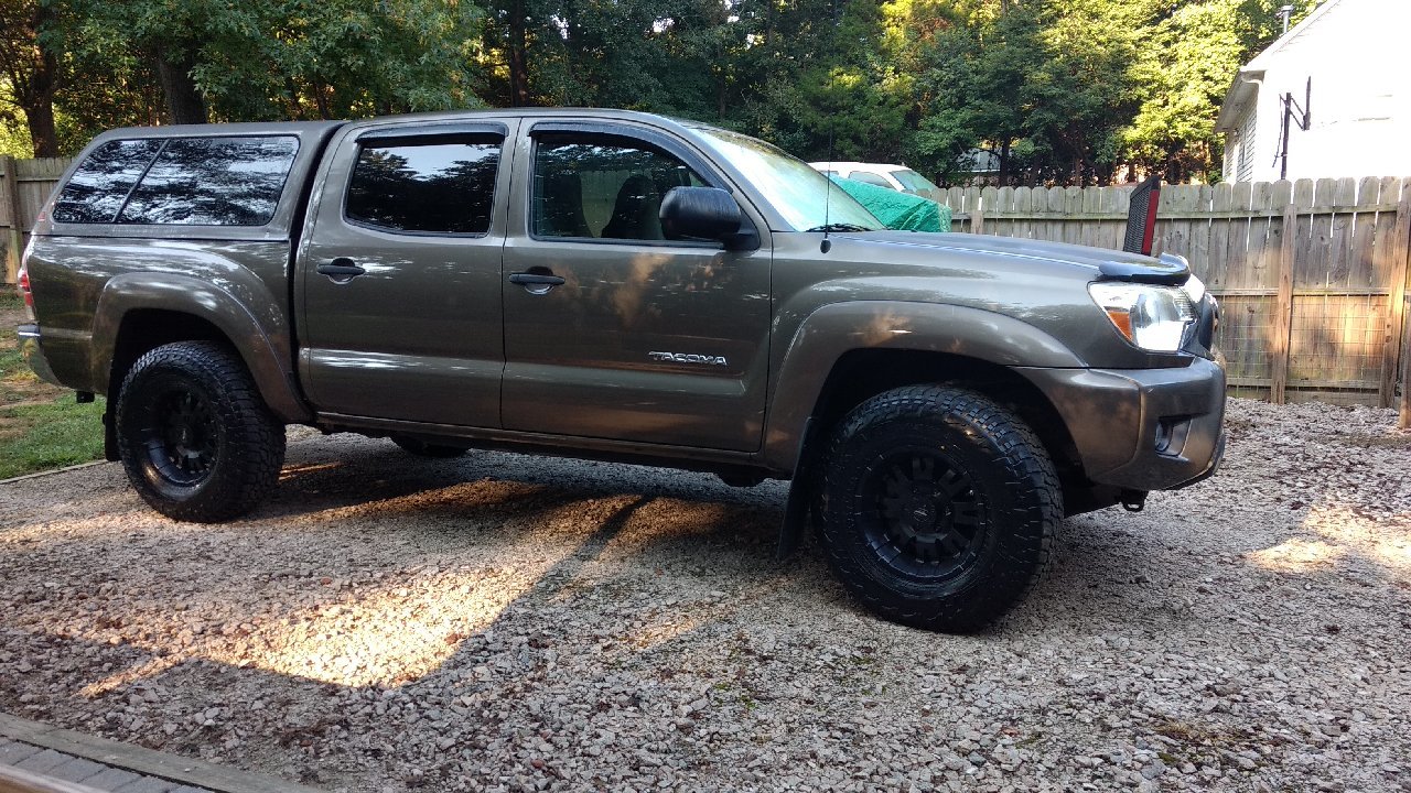

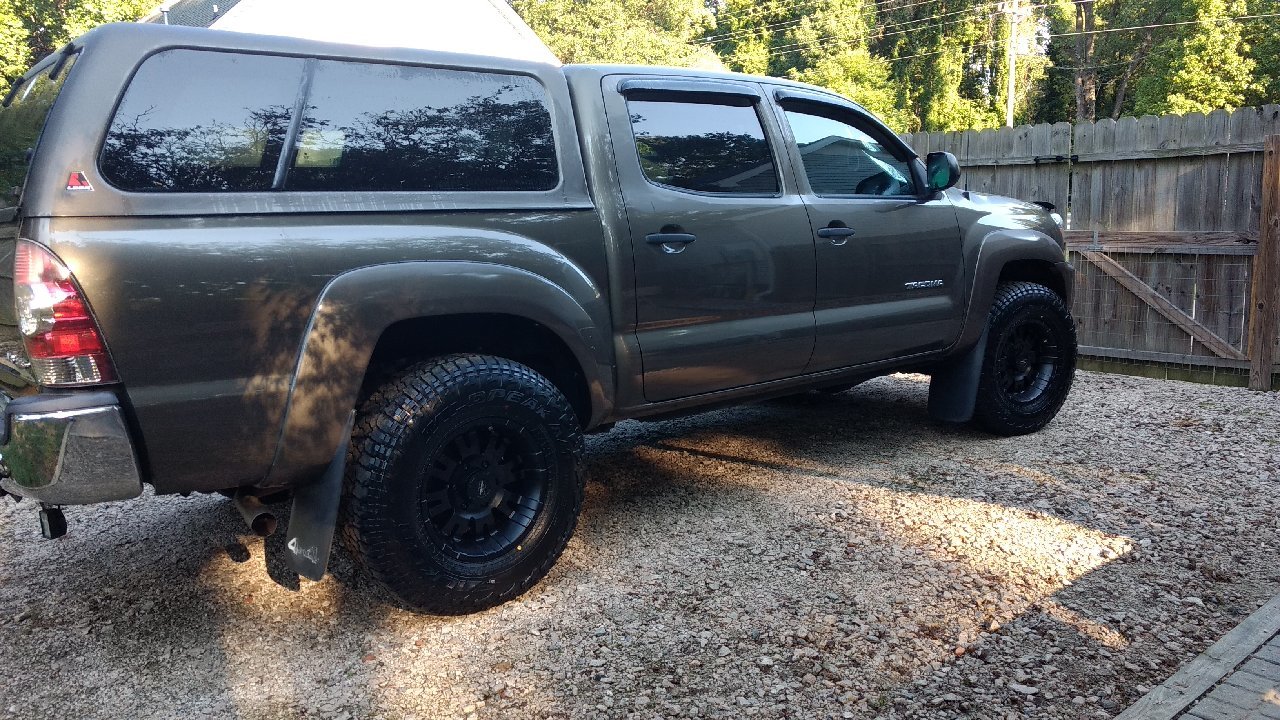

    People are always asking about tire sizes, offset, trimmimg, etc., for a Tacoma. I hope the info and photos I provide can help someone with that decision. I spent quite a while searching for info until I gathered enough info from numerous threads to make my decision. This is just simple info for a simple upgrade.
    Suspension: Stock
    Tires: Falken Wildpeak A/T3W 265/75/16
    Wheels: ProComp 5001-6883, 16x8 Wheel with 6 on 5.5 (139.7mm) Bolt Pattern - Satin Black
    Offset: 0
    The original tires were 245/75/16 Stock steel wheels w/+30 offset
    Here are a couple sites that may help:
    https://www.youtube.com/watch?v=8EvMdbWB6MA

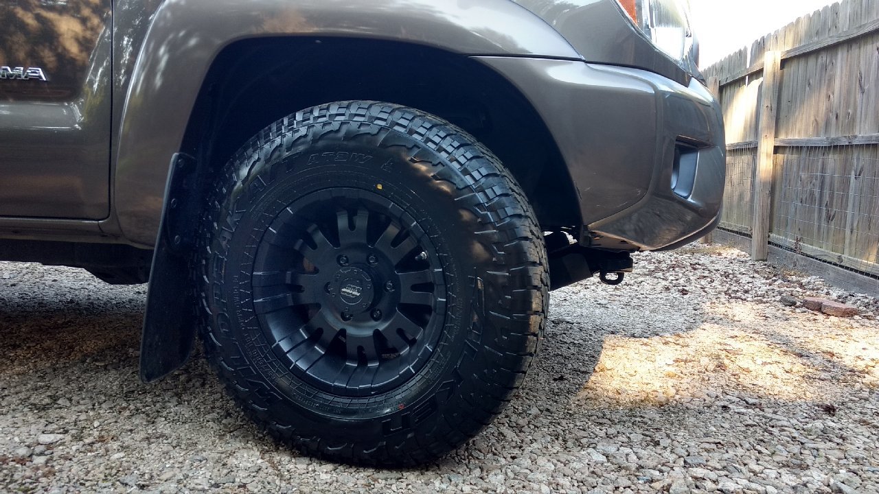

    Tires do not rub since I took off a little plastic guard that was on the front part of the fender. (already removed in photo)

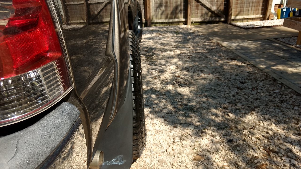

    The back of the truck is manufactured to sit higher than the front so it levels out when hauling a load. The truck cap has lowered the back end a little bit but plenty of space for the tires.
    With 0 offset, tire stick out very little.
    Rear tire clearance.
    Front tire clearance. No rubs
