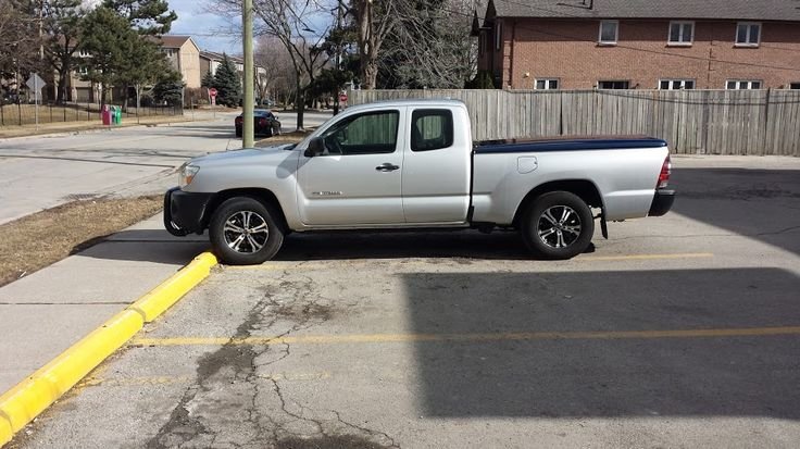

    225/75R16's (29.3") on rims with similar offset / backspace figures to OEM, fit on mine without fender-well black-box removal. In that instance with all factors considered, that was the limit. Any further, the x-acto knife comes out for the black-boxes, and the mod-game begins.
    This was mine, just after putting on the new to me rim/tire combination, prior to shocks or lift going in. It could have run this way as is.
