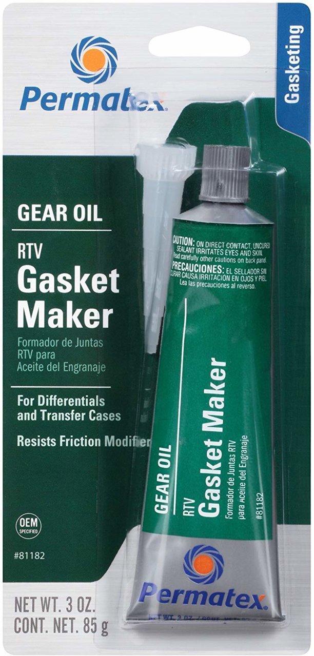

    OP, you might want to do as @nd4spdbh has advised.
    There’s been more than one person fix their leak by torquing the nuts.
    It’s basically a “free” fix if it works.
    If it doesn’t stop the leak, you’ll probably need to reseal it.
    I myself, might even use something like the RTV below. “Just because it fills the gaps better”
