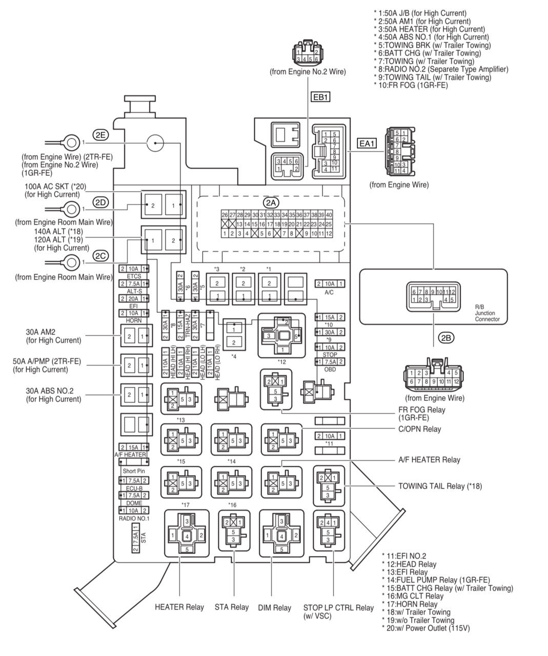

    The horn does work and I believe (but will double verify) that I did swap its relay # 6 with Relay #15 (the Circuit Opening). I am all about this being in the Relay area and need to better test each relay with an OHM meter etc... to make sure each of the pertinent ones (I know they all should be working ideally). The pertinent ones being:
    R10 Fuel pump (1GR-FE)
    R13 Main relay (EFI)
    R6 Circuit Opening
    Fuses (Under hood)
    4 STOP 10 Stop lights, high mounted stop light, vehicle stability control system, anti-lock brake system, shift lock system, multiport fuel injection system/sequential multiport fuel injection system, towing converter
    5 OBD 7.5 2005-2011: On-board diagnosis system
    7 EFI NO.2 or EFI 10 Multiport fuel injection sy
    9 OBD 7.5 2012-2015: On-board diagnosis system
    19 ETCS 10 Multiport fuel injection system/sequential multiport fuel injection system, electronic throttle control system
    21 EFI or EFI-MAIN 20 Multiport fuel injection system/sequential multiport fuel injection system
    28 STA 7.5 Starting system, multiport fuel injection system/sequential multiport fuel injection system, meter and gauge, clutch start cancel switch
    31 AM1 50 "ACC", "IG1", "TGI NO.2", "WIP", "WSH", "4WD", "STA", "BKUP LP" fuses
    34 AM2 30 "IGN", "GAUGE" fuses, multiport fuel injection system/sequential multiport fuel injection system
    35 AIR PMP 50 Multiport fuel injection system/sequential multiport fuel injection system
    IN QUESTION ARE THE FOLLOWING BECAUSE I ONLY HAD THE #38 BOLT-IN IN PLACE ( INV 100 ) AND EVERYTHING WAS WORKING...BUT I HAVE NOT PROBED IT FOR ACTUAL POWER AT THIS POINT AND I DID TRY PULLING IT OUT TO REPLACE IT, BUT THEN REALIZED IT WAS BOLTED IN AND I AM WONDERING IF I DAMAGED IT? TO TEST IT, AM I LOOKING FOR POWER AT ONE OF ITS LOCATIONS WITH THE KEY ON OR OFF OR HOW WOULD IT IDEALLY BE CHECKED? i AM WANTING TO SEE 339 IN THERE AS WELL AS I DO HAVE A TOW PACKAGE BUT I BELIEVE IT WAS INSTALLED AFTER I GOT THE TRUCK...AND #38 WAS ONLY USED?? AGAIN, IT WOULD BE A BLESSING TO STAY UNDER THE HOOD IN THE FUSE AND RELAY LOCATIONS!!
    38 INV 100 2013-2015: Power outlets
    39 ALT 120 without towing package: "AM1", "AC SKT", "HEATER", "FR FOG", "STOP", "OBD", "J/B", 'TOWING TAIL", "TOWING BRK", "BATT CHG" fuses
    39 ALT 140 with towing package: "AM1", "AC SKT", "HEATER", "FR FOG", "STOP", "OBD", "J/B", "TOWING TAIL", "TOWING BRK", "BATT CHG" fuses
    IN THE INTERIOR / FUSE BOX, I VISUALLY CHECKED ALL THE FUSES AND TOOK THEM OUT, REPLACED ANYTHING WITH THE SLIGHTEST CORROSION ON THE LEGS ETC.. BUT I AM ALL EARS TO THE PERTINENT ONES TO CHECK WITHER WITH THE POWER ON OR OFF PER YOUR SAY.

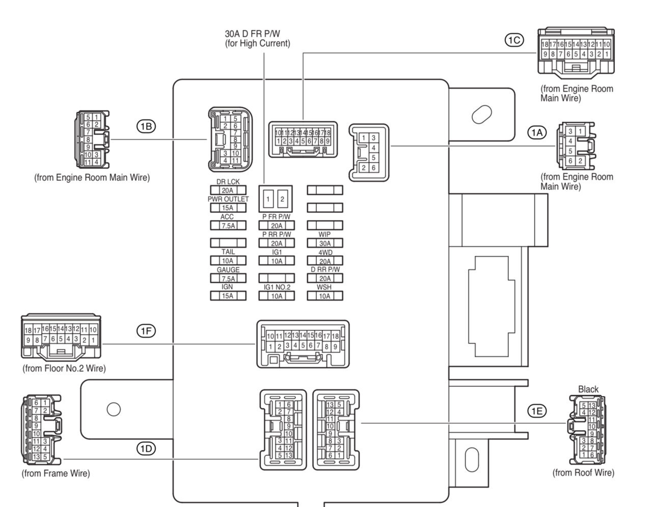

    Hello and thank you for helping out on this, Long story short...been in and out of the hospital with some heart issues. I'm getting back on this today and was going to check those fuses. To clarify, I am going to the fuse box under the hood and checking them out to see if they have power at all times (with key off)?
    THIS IS FOR THE PASSENGERS COMPARTMENT FUSE BOX
    When I looked at the legend for the fuse box, here is what Ifound and am going to check:
    1 IGN 15 Multiport fuel injection system/ sequential multiport fuel injection system, anti-lock brake system, traction control system, vehicle stability control system, SRS airbag system, front passenger occupant classification system, engine immobilizer system
    8 IG1 NO.2 10 Anti-lock brake system, vehicle stability control system, stop lights, charging system, multiport fuel injection system/sequential multiport fuel injection system, air conditioning system, instrument panel light control, anti-glare inside rear view mirror, back monitor, clutch start cancel switch, rear differential lock system, power outlets, tire pressure warning system
    10 IG1 10 Anti-lock brake system, traction control system, vehicle stability control system, backup lights, air conditioning system, shift lock system, audio system, passenger airbag manual on-off switch
    UNDER THE HOOD FUSE BOX
    7 EFI NO.2 or EFI 10 Multiport fuel injection system/sequential multiport fuel injection system
    FOR THE HECK OF IT!
    Assignment of the fuses in the Passenger Compartment
    Name Amp Designation
    2 GAUGE 7.5 Meter and gauge, emergency flashers, front passenger's seat belt warning system
    3 TAIL 10 Tail lights, license plate lights, parking lights, multiport fuel injection system/sequential multiport fuel injection system, front fog lights, instrument panel light control, illuminations
    4 - - Not used
    5 ACC 7.5 Shift lock system, outside rear view mirrors, audio system, power outlets
    6 PWR OUTLET 15 Power outlets
    7 DR LCK 20 Door lock system
    9 BKUP LP 10 Trailer lights (back-up lights)
    11 P RR P/W 20 Rear passenger's power window (right side)
    12 P FR P/W 20 Front passenger's power window
    13 D FR P/W 30 Power windows
    14 WSH 10 Wipers and washer
    15 D RR P/W 20 Rear passenger's power window (left side)
    16 4WD 20 Four-wheel drive system, rear differential lock system
    17 WIP 30 Wipers and washer
    18 - - Not used
    19 - - Not used
    20 - - Not used

    Engine Compartment Fuse Box
    Fuse box location
    The fuse box is located in the engine compartment (left-side)[​IMG]
    Fuse box diagram
    Advertisements
    Assignment of the fuses and relay in the Engine Compartment
    1 A/C 10 Air conditioning system
    2 FR FOG 15 2005-2011: Front fog lights
    2 TOWING TAIL 30 2012-2015: Trailer lights (tail lights)
    3 TOWING TAIL 30 2005-2011: Trailer lights (tail lights)
    3 FOG FR 15 2012-2015: Front fog lights

    Sorry to hear about your health problems.
    I too was just in the ER last night with my grandfather.
    He went in to AFIB, but he’s doing ok.
    Anyways, let me refresh my memory and read over your original post.
    Until then, let’s start with the diagrams for the fuse box I have.
    I think these are labeled better, and include pinout.

  18. Feb 25, 2023 at 5:36 PM
    #18
    TnShooter
    TnShooter The TacomaWorld Stray
    Sep 2, 2010
    #42625
    20,982
    Deogee
    07' TRD Off-Road, Auto
    STOCK
    With ignition to On/Run check the fuses below.
    15A IGN
    10A IG1
    Power at all time
    10A Stop
    20A EFI
  19. Feb 25, 2023 at 5:58 PM
    #19
    deentllc
    deentllc [OP] Well-Known Member
    Jan 29, 2023
    #416654
    54
    Duane
    Eugene, Oregon
    2015 Tacoma 4 cylinder Access Cab Automatic
    none.. on this one : )
    I'll edit this as I go. Real quick, in-cab / passenger compartment... It appears all have power to:
    KEY ON
    #1 15am IGN YES
    #8 10 amp YES
    #10amp YES
    NO POWER TO#5 WITH KEY ON
    Power at all time
    UNDERHOOD
    KEY ON NO POWER TO #1 IGN, 7, 15, 16, 17, 18
    TESTING THE FOLLOWING WITH KEY OFF NOW
    4 STOP 10 Stop lights, high mounted stop light, vehicle stability control system, anti-lock brake system, shift lock system, multiport fuel inject0ion system/sequential multiport fuel injection system, towing converter
    YES
    YES
    I'll update this in just a couple of minutes.
    THANKS MUCH TShooter!
    TnShooter likes this.
  20. Feb 25, 2023 at 6:37 PM
    #20
    deentllc
    Jan 29, 2023
    #416654
    54
    Duane
    Eugene, Oregon
    UNDERHOOD
    KEY ON NO POWER TO
    #1 A/C
    #7 EFI NO.2 or EFI 10 Multiport fuel injection system/sequential multiport fuel injection system
    #15, #16, #17, #18,
    #19 ETCS 10 Multiport fuel injection system/sequential multiport fuel injection system, electronic throttle control system
    KEY OFF - POWER AT ALL TIMES
    YES
    YES
    Please advise me of my next move (or if I missed something).
    I test the two relays for the EFI (I believe both R6 & R10) and then if need be, the horn works, so if I find either R6 or R9 to be bad on a bench test with the OHM meter etc..), I'll try and use the horn relay to swap out (with my fingers crossed).
