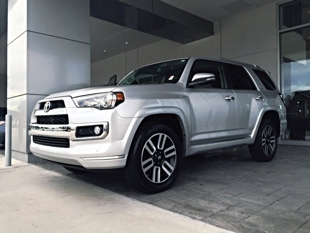

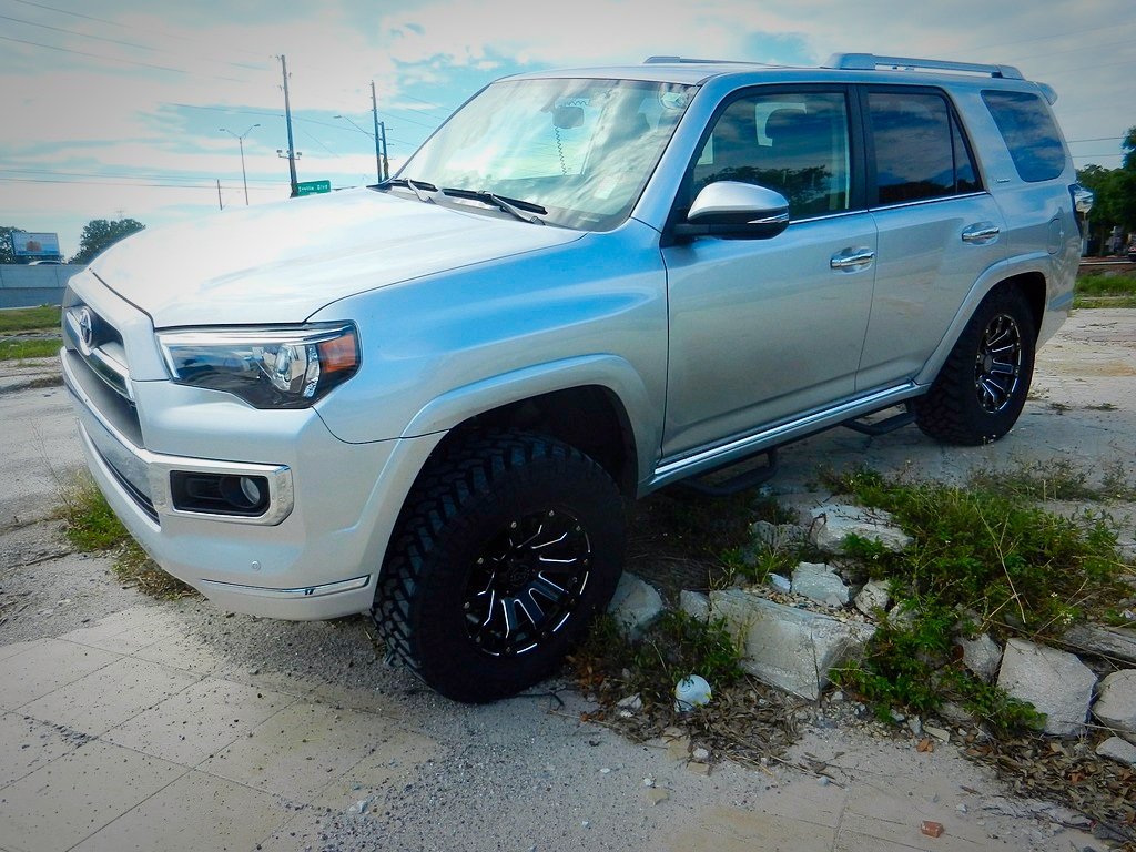

    The obligatory "before shot"

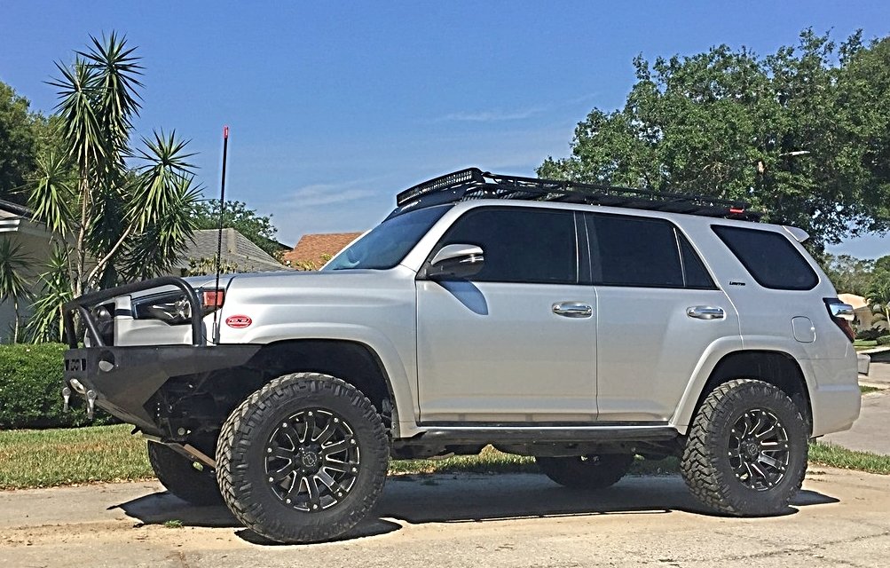

    Intro:
    Purchased for $38k on 6/11/16 with 17k miles. This is my 3rd 4runner. The last two were 4th gen V8 Limited 4wd, and I absolutely loved them. However, my family has expanded so the need for a 3rd row is now a must. I looked around for another 4th gen, but with a 3rd row. They were impossible to find with reasonable amount of miles. So, I did some research and decided to drop some real coin on another Limited 4Runner, but 5th gen this time, and with a 3rd row. My wife and I enjoyed the creature comforts of the Limiteds, so that's what we went with. So far we are very happy with it.
    You might be surprised with exactly what we are so pleased with:
    • Actual knobs for the radio and climate control! Woo hoo!
    • The fuel door opens without having to hunt for a stupid lever. Yeah!
    • Digital speedo! Yup!
    • Interior design is pleasing to the eye and works. Because that's what we stare at the most.
    All the other stuff is expected: Awesome offload capability, truck on frame build, fit and finish, solid construction, styling, aftermarket parts support, Toyota reliability, smooth tranny and engine.
    The goal for the build is to have a usable, comfortable street machine for the wife and kids, but also something for the occasional off-roading trip.
    Anyhoo. This will be my build page. Enjoy!

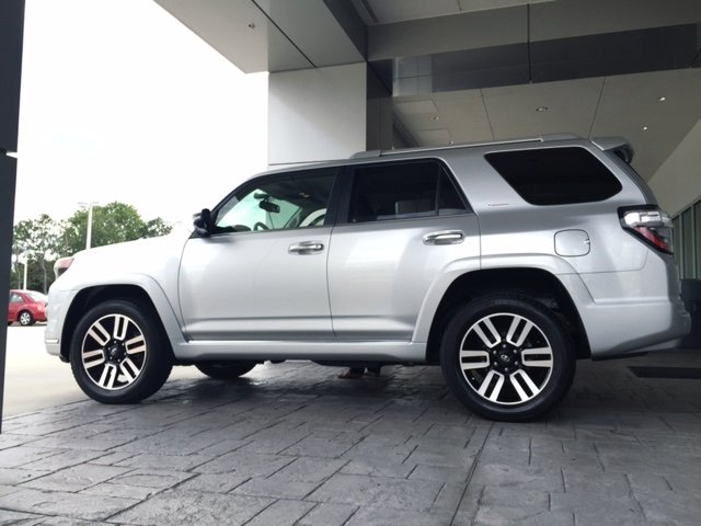

    The day she was wrangled from the dealer's icy cold grip:

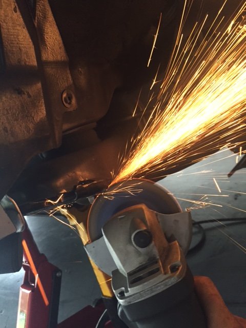

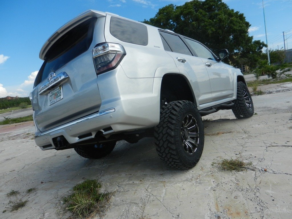

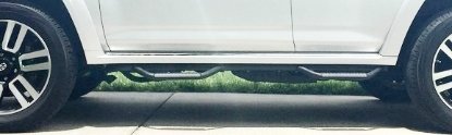

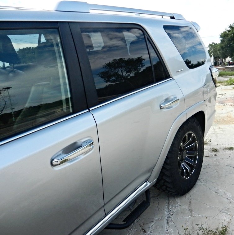

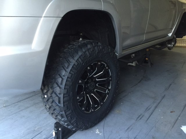

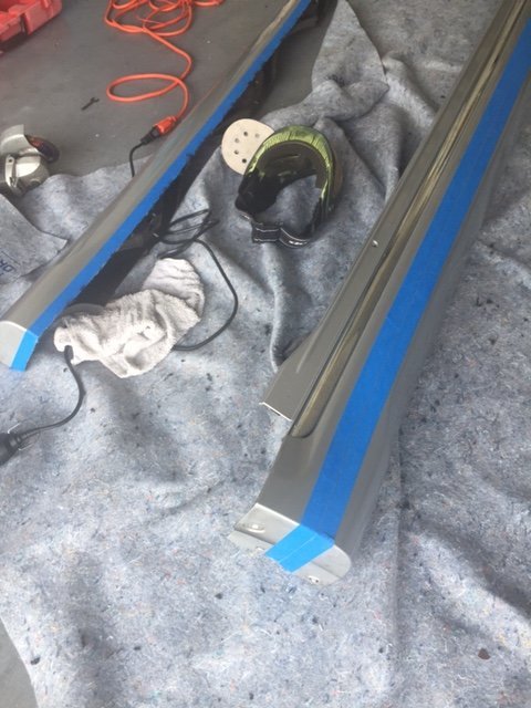

    First thing I did was add some Nfab steps. My preggy wifey needed them ASAP. It was killing me to see her struggling to get in and out.
    After the baby pops, I'll replace the Nfabs with sliders.

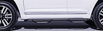

    There are several ways you can go with the Nfab steps on a 5th gen Limited. You can either buy the Limited version Nfabs and they'll mount up and clear the fat Limited rocker panels. The steps however, will hang pretty damn low. The other option is to get the TE version Nfabs, and either remove the Limited's rockers or cut the rockers down. I wanted the Nfabs tucked up and more clearance, so I got the TE Nfabs and cut the rockers. Some guys leave the rockers uninstalled, but that looks like sh!t to me.
    Thank you to on T4R for the 5th gen Limited Nfab write up and measurements! Saved me a bunch of time.
    It was a nail biter cutting through these rockers on my new truck, but I think it came out pretty good and straight:
    With Limited Nfabs and no cut:
    With TE Nfabs and rockers cut:
    Looks lifted, and there is no lift yet.
    and..
    NEXT!

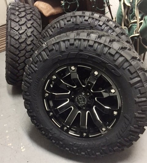

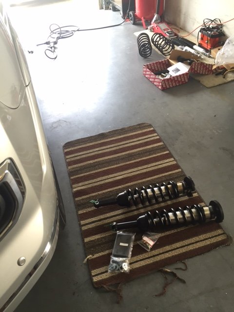

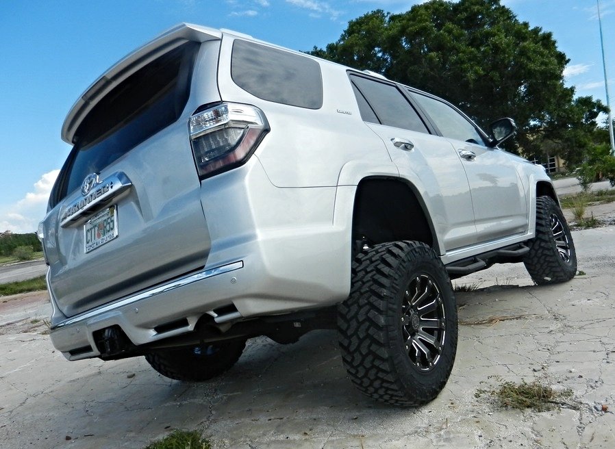

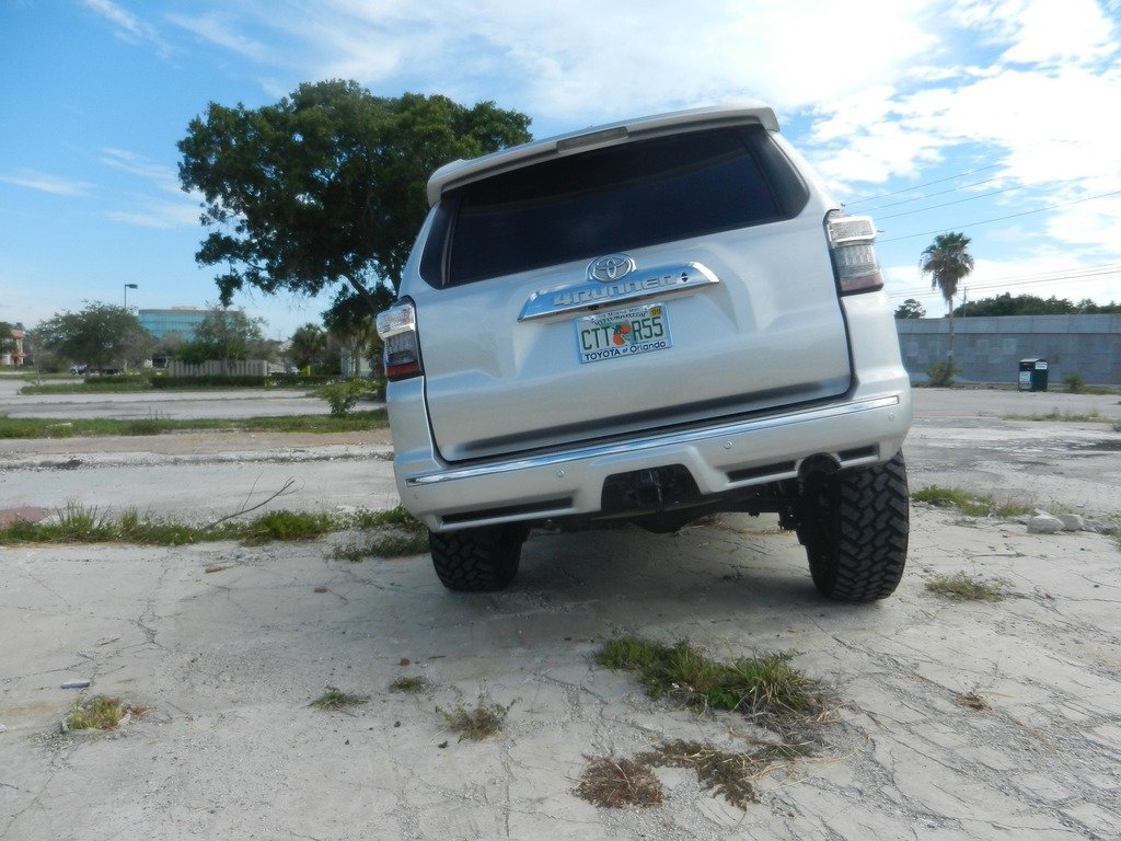

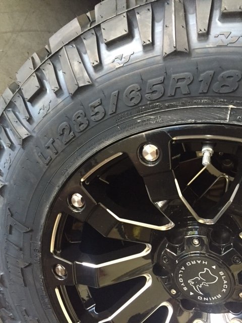

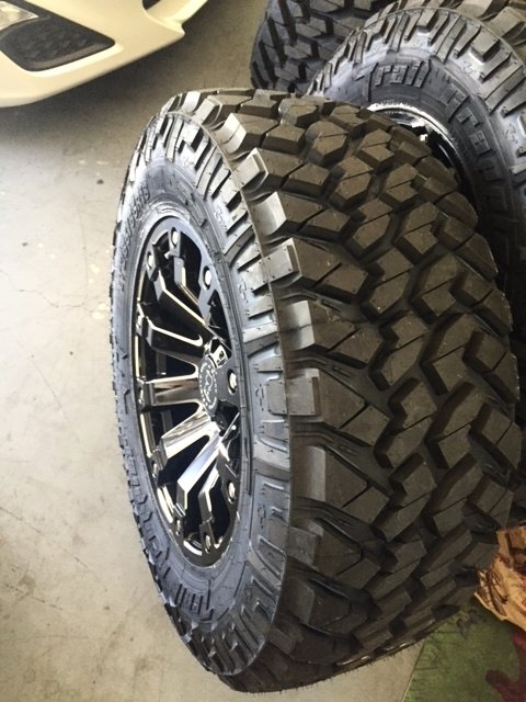

    Sitting in my garage waiting for the Icon Stage2 suspension to arrive:
    Meat!
    I love the dish on these and the angles. I think the angular design of the wheels matches the angular design of the 4runner:

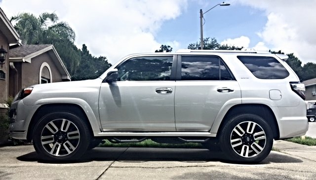

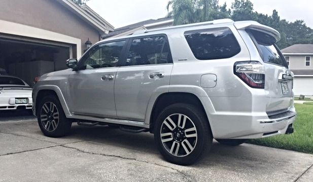

    After the first few mods:

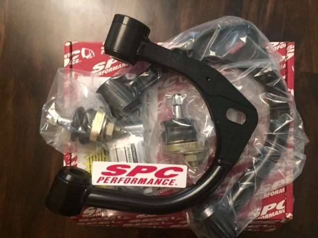

    Got something in the mail today...
    The rest should arrive next week. :bananadance:

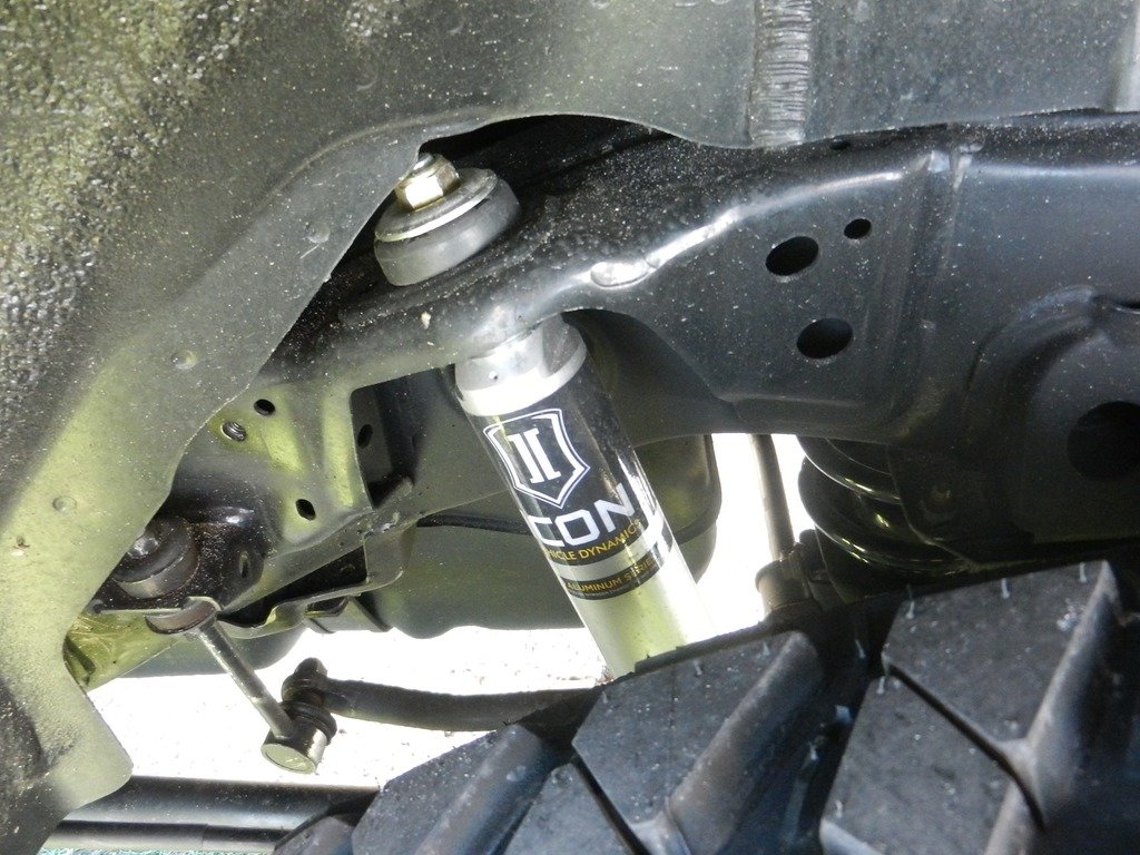

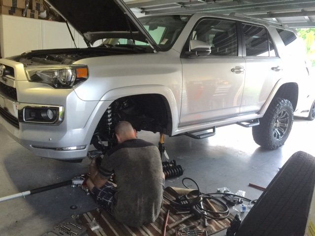

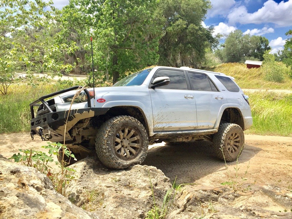

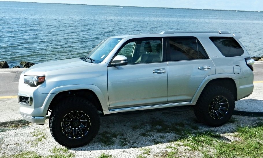

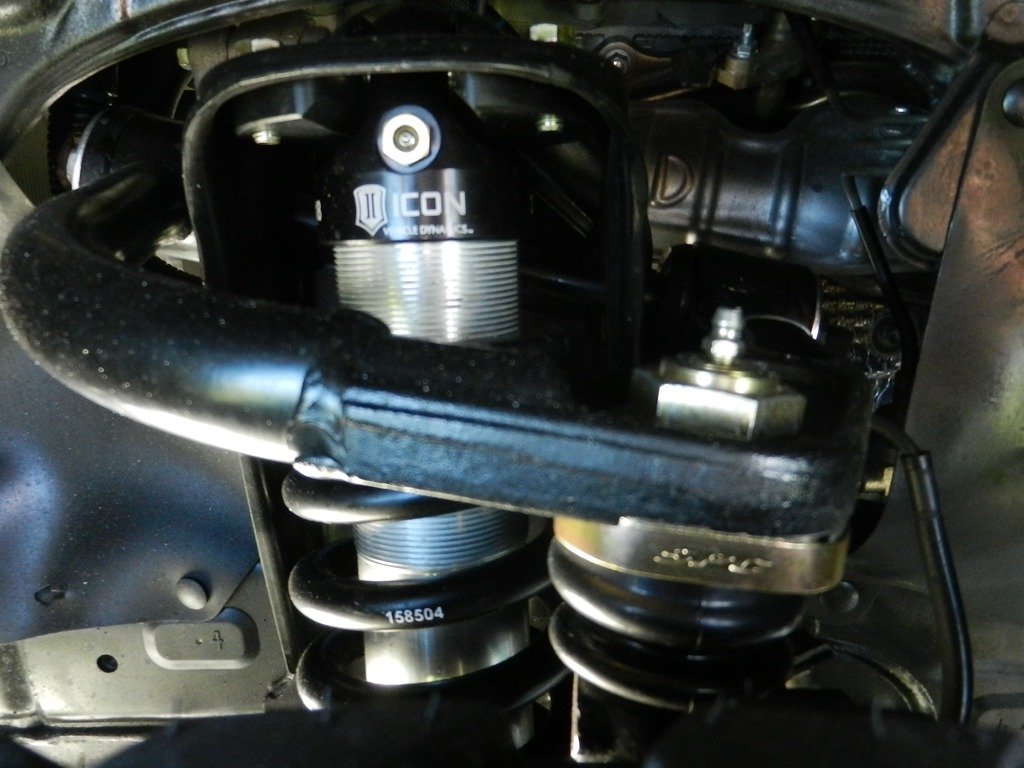

    Install complete. It went very smooth. Everything is solid. The biggest pain was getting the passenger side UCA long bolt out. That damn thing was hitting the body and then once I got it past that, was hitting AC fittings and shit. I re-installed it backwards. :p
    I found a small "feature" near my house to roll up onto. I can tell that with something bigger to flex on, and with the planned longer rear sway bar links installed, it will flex some more.

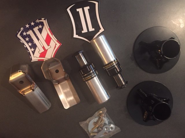

    Got some new Icon stickers today...
