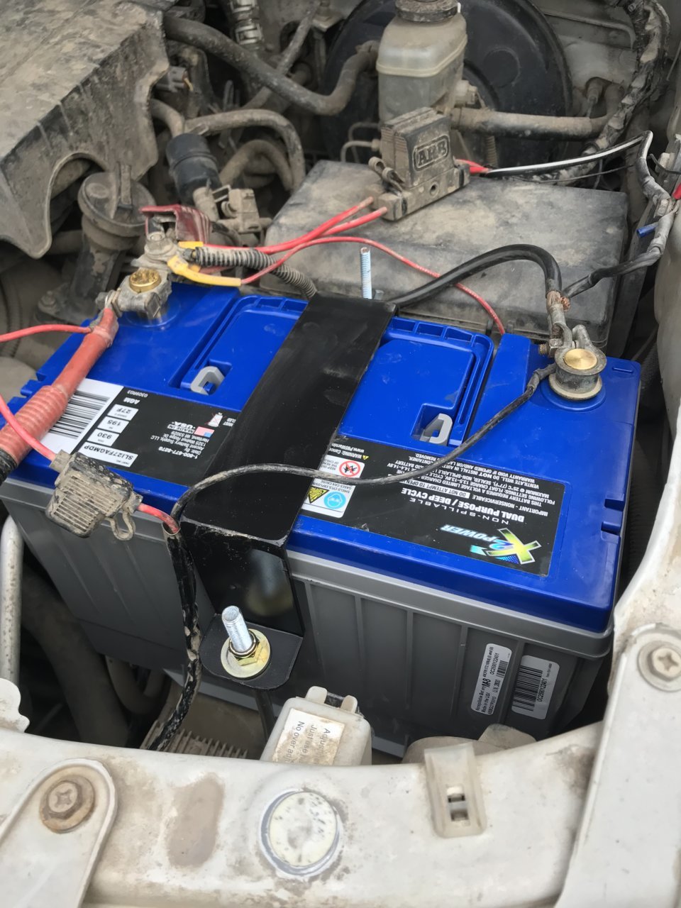

    2019-02-08.jpg A group 31 battery will fit. I installed this G31 X2 battery in my 2015 DCSB with no problems. I needed to change the battery mounts drilled off the welded on J hook on the stock bracket.

    Great first post, welcome to TW!

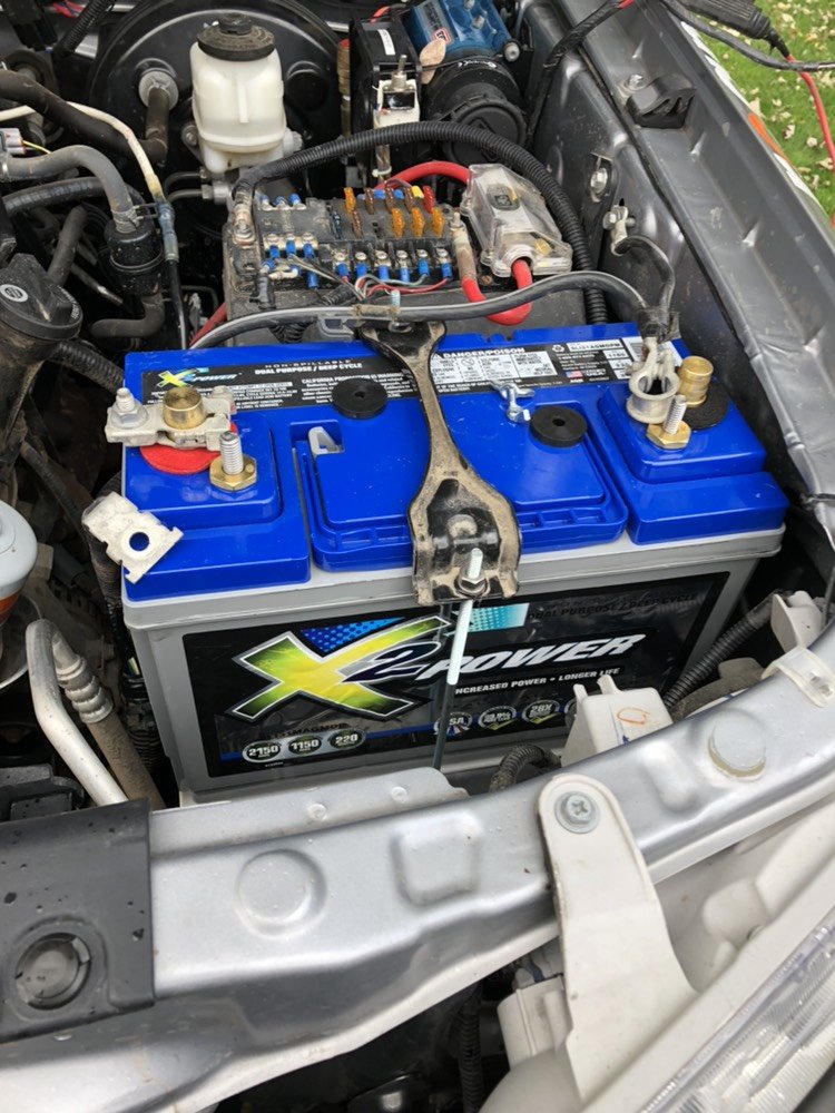

    That looks like a much cleaner solution than what I’ll be able to offer. Though I know I’ll be happy with mine because I’ll really enjoy getting to make it.

    Just for closure from my earlier post, got the bracket built and in. Excuse the rats nest. Have a fuse block that needs to go in. Just need to stop being lazy.
