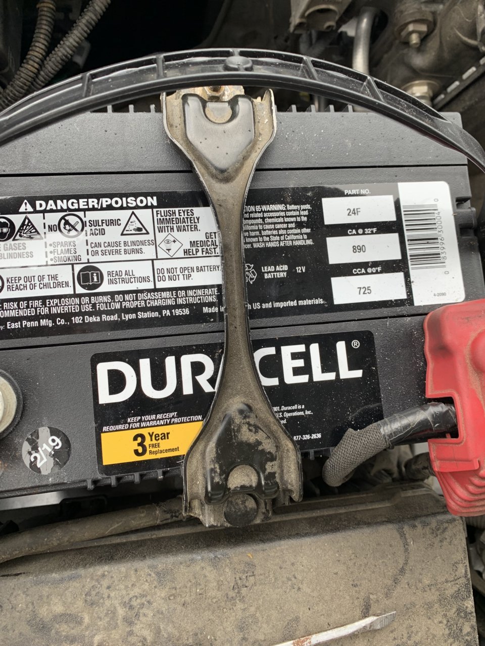

    So I bought a new Duracell battery at SamsClub for 120.00
    3 year warranty...
    What I gleaned from the Duracell book!
    It reads...27F battery for V6 model / 24F Battery for the 4cylinder model...
    I had a 24F in my V6... It's probably common and the norm for Toyota to put the smaller battery in trucks. Either way I spoke with the SAMs Club rep and told him if I was successful at getting the battery replaced for free at the dealership, I would be binging back the Duracell for a refund. He said that was not a problem. So that's the plan guys... I'll keep you posted.

    that DURACELL looks like a winner CCA wise

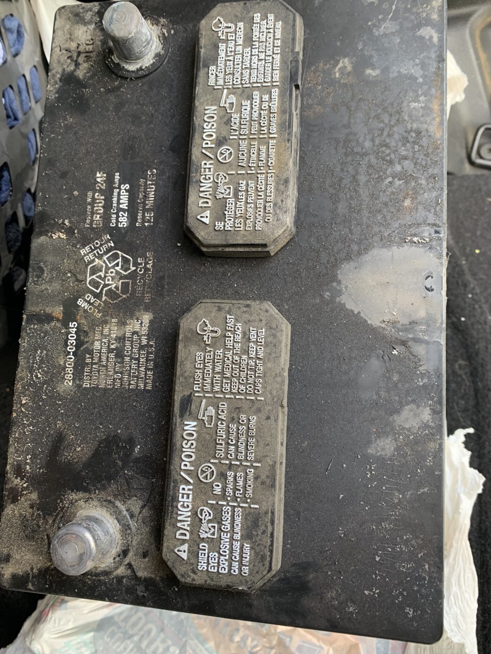

    Did you check the water in your old battery? Was it low?
  5. Feb 10, 2019 at 1:54 PM
    #65
    SCREAMINSAL
    SCREAMINSAL Well-Known Member
    Jun 15, 2018
    #256531
    78
    Two of the cells used about a shot glass each of distilled water. Not terrible but a little low.... Not sure how much that would affect performance....

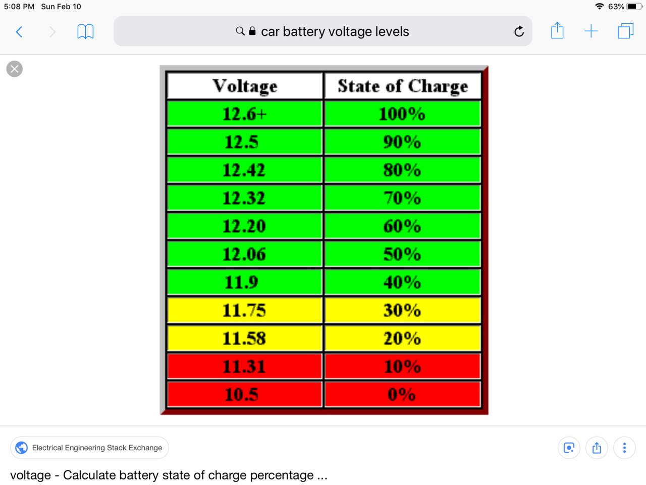

    bill
    2014 SR5
    checked my OEM battery this morning was 12.45 volts is that low
