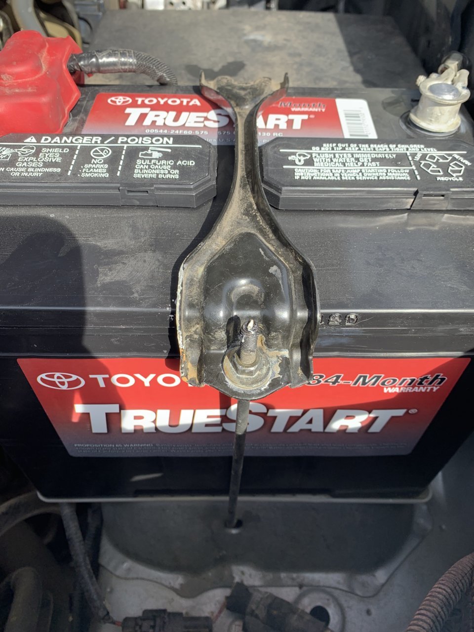

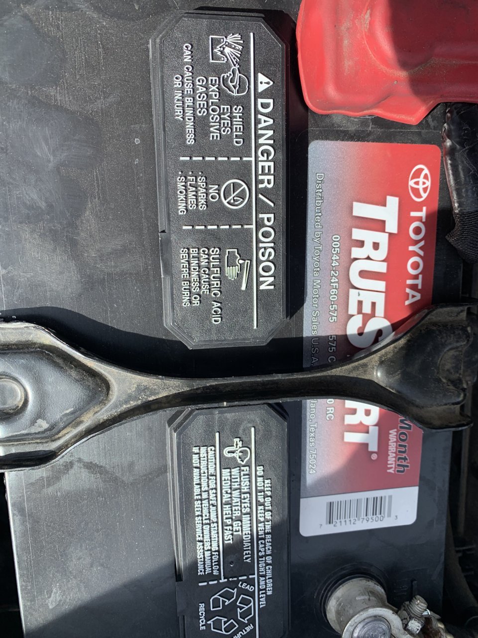

    This is what the dealer installed on my 2017 V6 Tacoma... its a 24F....

    The pictures show a Toyota batt., & it really looks like 575 cca, that seems kind'f low end. The high end 24F, should have 700 to 800cca, the mid range 24F should have 600 to 700cca, & the low end will be less than 600cca. Most Co.,s will normally have 3 levels & that's, roughly, what they will be. I'm surprised the "Toyota" batt. is rated this low.
