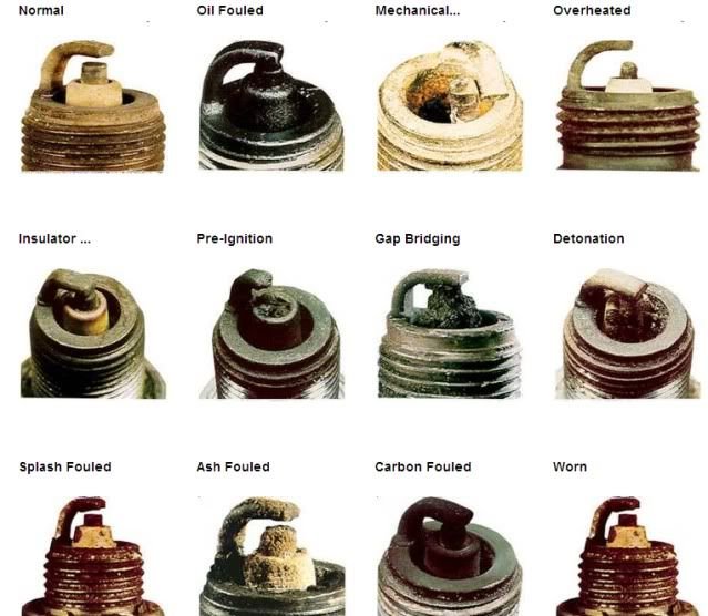

    See the rust at the base of the porcelain? Change the plugs

    Yeah I read the mixed reviews also so I’m switching it back. The cleaning process was kinda annoying having to wait for it to dry. Will def look into cleaning the MAF sensors and go from there.

    I think it means they’re rotting from the inside out

    That's normal. All plugs will have brown around the porcelain it's from the arc and burn in the cylinder.
    Here's a chart. Now this one is missing a few and if that browning on the porcelain is a lot its from hard accel and high burn temps from a leaner mixture. But his seem pretty normal.

    Oh that's just staining nothing to worry with again typical. As long as you don't see any lightning bolts so to speak going on around there or along that part of the porcelain you're good.
