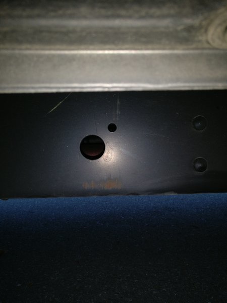

    Mine '12 has rust too, a lot worse than yours. It really started to develop the first 2 years I was in Montana. Now that I'm in dry weather Nevada again I'll grind it down and coat it.

    Looks like you scraped something. As others have suggested sand and paint with por15 or rust bullet or eastwood.

    Soak that frame in the oil of your choice.
    2 days after I bought my 15 I put it up on the ramps and soaked the underbody with no drip oil spray..and I mean completely soaked. Prior to every winter I spray it down again and pressure wash it all off in the late spring. As it stands right now, after 55,000km of driving through salty ontario winters, it still looks new beneath the oil

    You are 100% right xterras are not unibody I had a super charged 04 that was a pig on gas

    What is the first thing i say ... I know it's minor

    This scuff is on both sides it's dead center on the back doors. I think the truck was chained down there for transport to the dealership and the chains rubbed. I haven't hit anything the trucks never seen a gravel road
