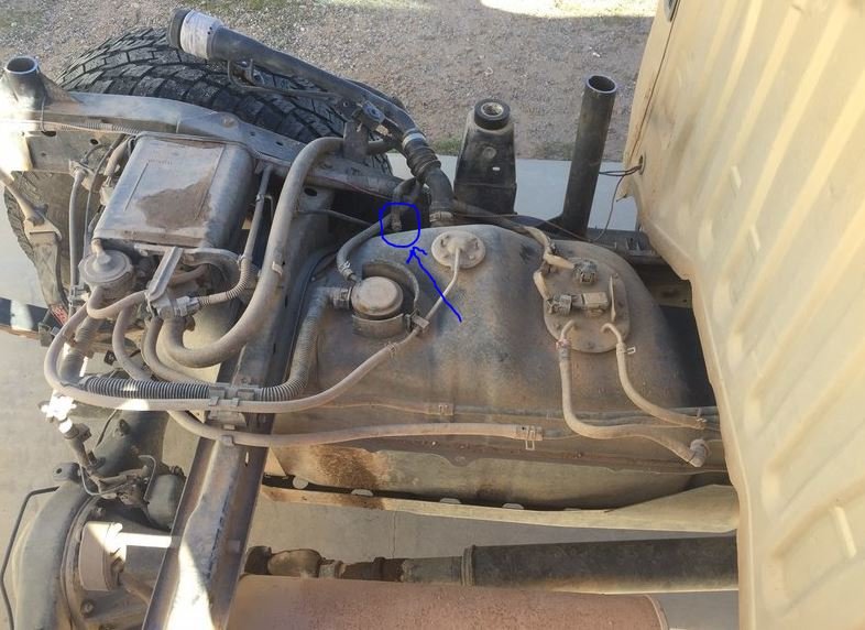

    Not 100%, I have a 2002 but most standard filler necks are the same. Should be #13 in this list (from 2015 tacoma parts list)
    its this one on my '02

    Take the canister out and see if you can blow through it. It may smell fuelly which can be normal but if it feels heavy or maybe some liquid fuel comes out then it's saturated. You can blow through the vent valve line too. It should be statically open, it only closes when commanded too for a leak test. Sometimes spider nests and crap will plug the line.

    Near the gas tank.. in cr250's pic with the bed off it's above the rear of the tank /above the axle. It's the square-ish box with the plastic vent/vapor lines going to it
