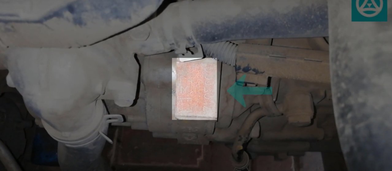

    the engine # is stamped on the (prob. front) block. The last 5-6 numbers will match the last numbers of the VIN.
    If no match to the serial part of the number, it's been changed.
