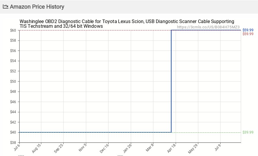

    As far as the key (or rather the immobilizer inside the key), that needs to be programmed as well. It's a little more in-depth (but not much) and requires some extra hardware/software. I detailed my search for a brick and mortar locksmith in my area that would be less than the dealership in this thread: https://www.tacomaworld.com/threads/good-brick-and-mortar-locksmith-in-oc.697763/
    In my search, I discovered this thread on programming the remote yourself: https://www.tacomaworld.com/threads...-programmed-and-coded-for-2015-tacoma.690027/
    Using this cable+included Techstream software: https://smile.amazon.com/dp/B084H75MZ3
    The programming process is pretty straightforward. I used Techstream version 14.30.023 (which was provided via a link by seller of the above cable). I successfully programmed two new "G" code keys to my truck (I believe yours is the same "G" key). I had the keys cut at the dealership, got them to cut both for $10.
    That being said, the price of the cable was $40 when I bought it on Amazon. Looks like it went up to $60 back in April, so you might want to wait until it goes back down (but who knows if/when that will happen).
