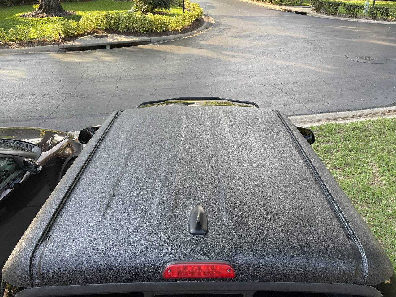

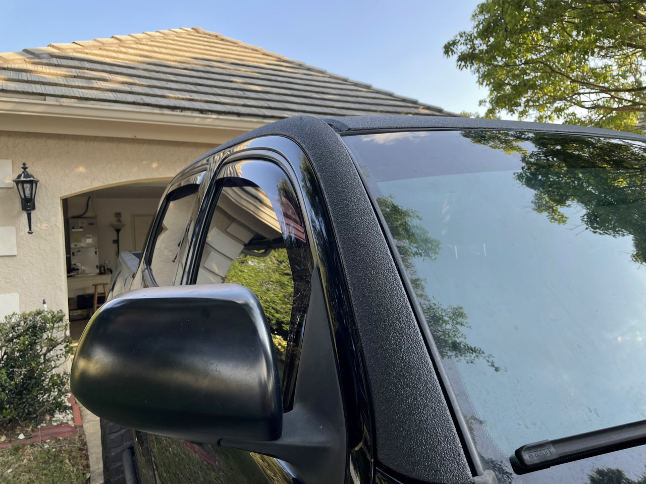

    I had two small spots on my roof that turned into rust. Since I am installing a Prinsu rack soon I wanted a permanent solution. I paid Line-X $700 to paint the roof and a-pillars around the windshield. I paid a little extra for the premium version so it doesn't fade so quickly in the sunlight. I'm very pleased with it and hope to never have to worry about rust again. IMG_0256.HEIC.jpg

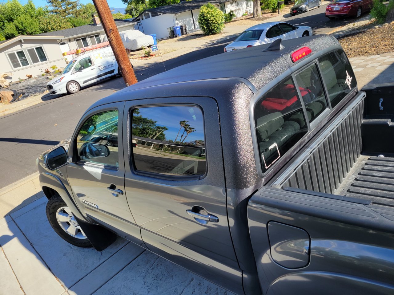

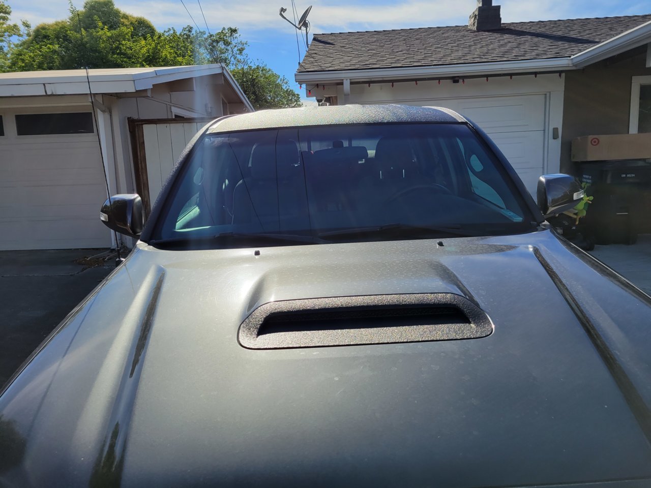

    Had LineX cover up my toyota issues too! UV coating makes it shine! I had paint failure along the window line belpw the rubber which is why we went an inch below the window. Wasnt my first choice but repair was just too expensive and who knows where the paint is going to fail next 20220610_172719.jpg 20220610_172634.jpg

    Wow that looks really cool. You got a good bit more covered than me. I think I am going to have them do my hood too. They said it would be $400 with the premium line-x.
    What product did you use to get your weather strips put back in? The factory double sided tape won’t adhere to the line-x for me.
