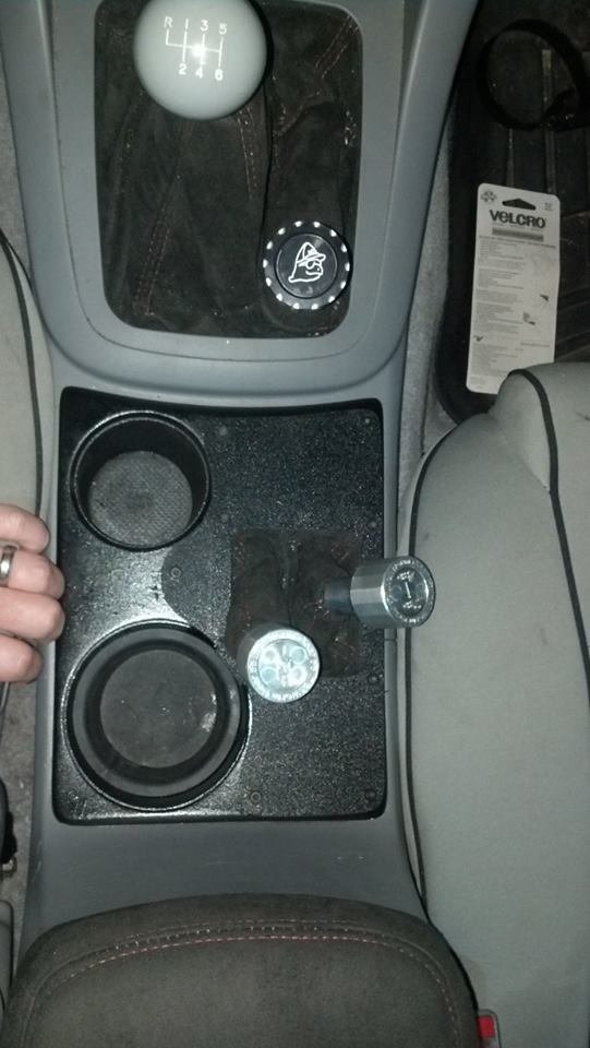

    Yup...it's a nice setup with the FJ case but you loose all but one cup holder...which I can't do.
    The setup I want one has one extra stick that can go just to the left of the shifter leaving all cup holders and a very clean look IMO.

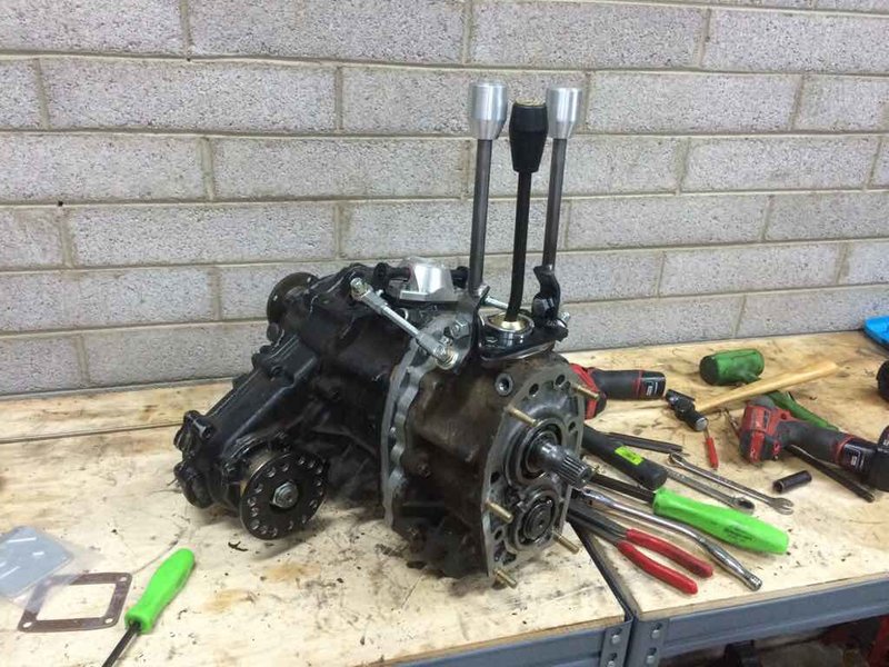

    twin stick relocate:

    So shiny!

    But yours is backwards :p

    lol - compared to yours, yes. But the taco is drivers side drop. ;)

    What a second...where do you plan you bring those sexy sexy sticks through? The normal shifter boot?
    Who built that setup for you?
    Need info....right now...

    u saw mine. thats how mine is setup. and i only lost one cup holder so its not that big of a deal. not like the truck doesnt have 8 more

    I remember your setup Ryan. I just want that one single little handle you have up there next to the shifter...

    The triple stick conversion is a kit I purchased from Dave'z off-road.
    I have the Hurst/core short shifter assembly which allows me to easily change the location of the transmission shift stick.
    I have a twin stick short shifter installed on the FJ case from NWIFab.
    My goal is to have all four sticks coming up through the stock location, it will have to be made wider, however in theory it should allow me to retain the stock center console cup holder area. As far as I know, no one's done it yet.
