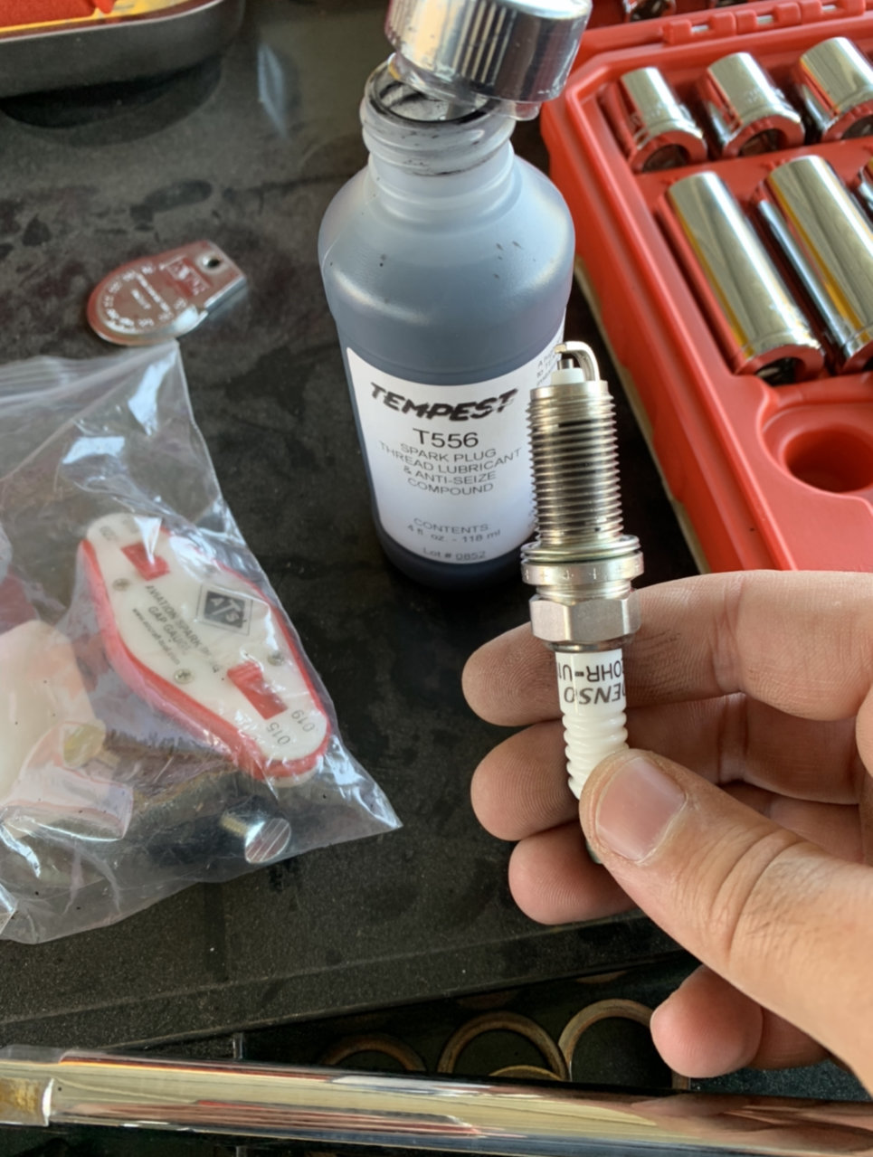

    I use tempest spark plug anti seize, works great.
