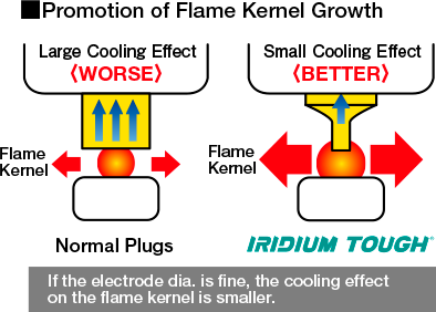

    So I was trying to dig up a little info on the different plugs per bank as OEM but didn't come up with much. I asked Toyota Parts Department Manager that has been a very large dealer for 20 years and is equally as nerdy as we are. Still nothing. BUUUUT I did find some interesting info from NGK and Denso's Websites.....
    This is from Denso. You can see an illustration between the difference in how the flame front is created. As you can see flame front is much larger, IE creating a faster and more efficient burn.
    This is also from their site comparing their Iridium Power and Iridium TT (Twin Tip). The ignition source is more focused and much stronger. Thus more efficient burn and stronger flame front than even a standard Iridium plug.
    Then I was at NGK's site. This compares Nickel (what everyone refers to as Copper), A standard Iridium and their new Ruthenium plugs. You can clearly see in high speed photos the differences int the flame front. The more Red, the "hotter" the flame front. This is important so ALL the fuel is burnt. You want that to increase energy from your fuel AND it helps reduce carbon build up because carbon build up is unburnt fuel, plain and simple.
    Now... After doing some stupid amounts of reading trying to find the answer to why NGK and Denso is on the same engine from OEM I found a lot of information. From what I have read from many sources, including 3rd party sources. There is no reason not to use an Iridium Spark Plug unless you simply want to save a BigMac McDolads meals worth of food. The only reason you wouldn't use Iridium is engines that are proven not to run well on them. Old cars (pre mid 80's for the most part), many early 2000's Fords were particular about the plug used and others that use "non-resistor" plugs (pre-1960's-ish). IMHO I will always recommend using Iridium if possible. I will always recommend NGK and Denso. Tank from this what you will.
    Monkeybutt2000 and JimIowa like this.

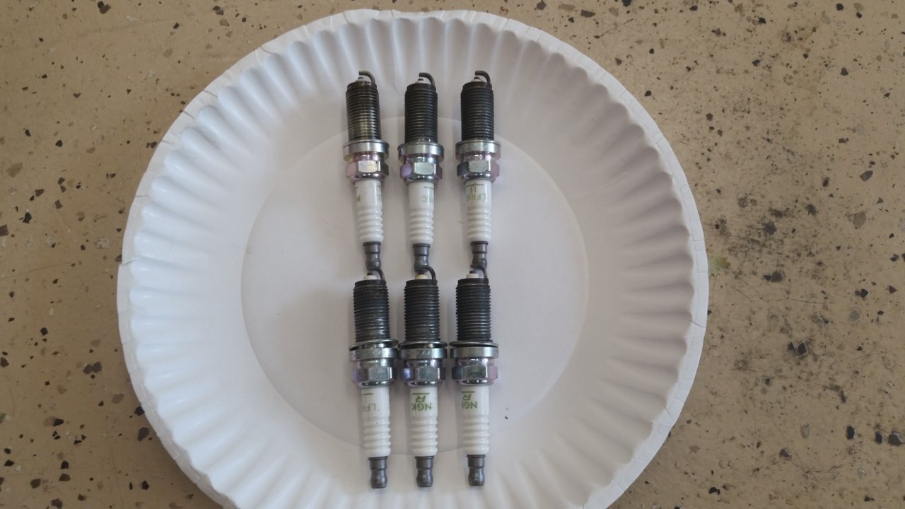

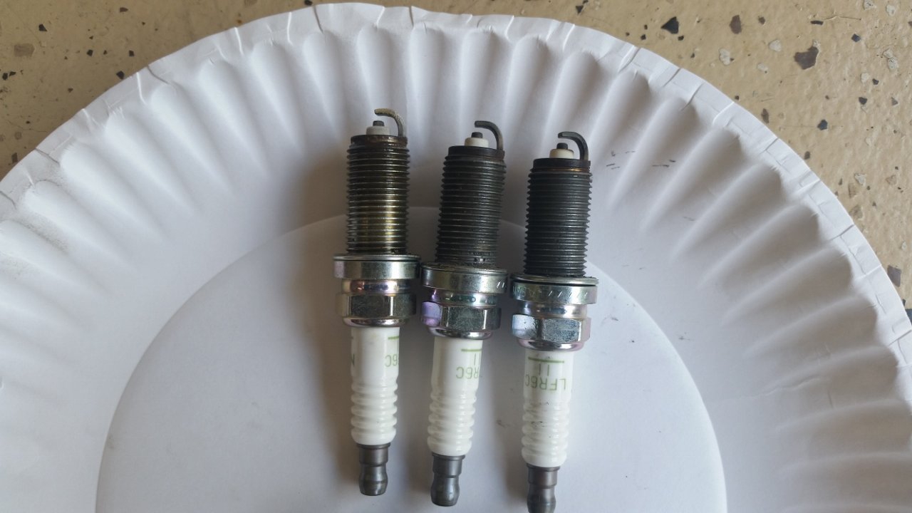

    This has not been my experience.
    I've changed my plugs every 30k miles since I bought my '07 new over 13 years ago. The first batch that came out was the typical 3 x Denso + 3 x NGK. Unlike most on here that seem to favor the Densos, I've stuck with the NGK plugs (p/n 7787 V-Power).
    I just changed my plugs again today @ 150k miles (so the plugs that came out had ~30k miles on them). The plugs that came out looked like this:
    They all looked reasonable, and the gaps were still reasonable as well:
    1: 0.044"
    2: 0.045"
    3: 0.044"
    4: 0.043"
    5: 0.044"
    6: 0.046"
    Original gaps were 0.040" when installed; all of them came out of the box gapped that way. I'd hazard a guess that if your gaps are opening up as much as you are suggesting after only 30k miles, you may have something else going on. It could be use related as well - I'm not hard on my truck by any stretch of the imagination, and the engine is completely stock. My truck is mostly used for my commute to/from work.
    The only thing that concerned me a little this time was that plug #6 was not tight when I went to remove it - it wasn't exactly loose, but it took pretty much no effort with a ratchet to start unscrewing it. It is the plug on the left in this pic:
    It is also the one with the largest gap, and the ground strap was substantially lighter than the others. I have a feeling that may have happened due to my torque wrench clicking before it should have when tightening it down the last go-around.
    After doing a lot of reading on here and elsewhere, I decided to change my approach this time. I've always used anti-seize on all of my plugs in the past, but as you can tell from the pics above, I put it on a bit too heavy. Due to that, I decided to chase all of the threads in the heads with one of these to clean them up:
