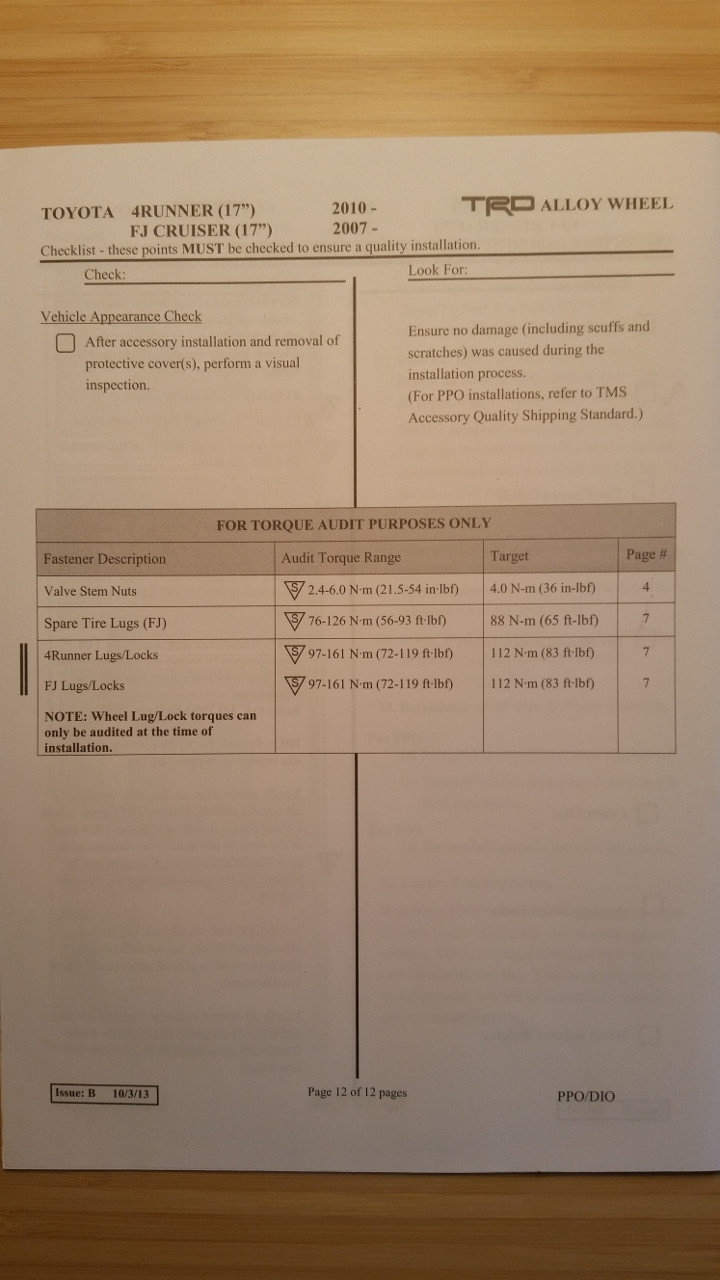

    Found the answer to this one (since I now have 4Runner wheels on my Tacoma):

    Meanwhile the professional mechanics would give them 3 ugga-duggas, hopefully with the yellow torque stick instead of the blue one. :laugh:
    By professional I mean doing it fast enough to beat the book time and earn a living.
