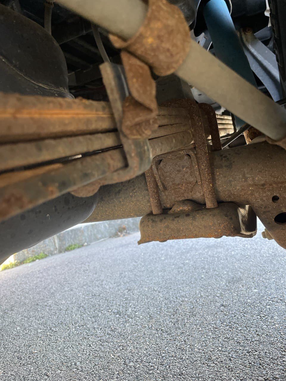

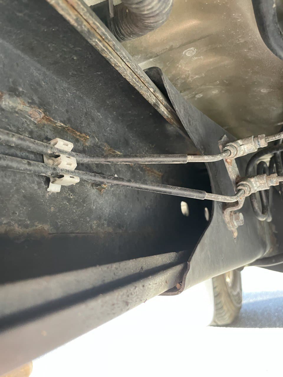

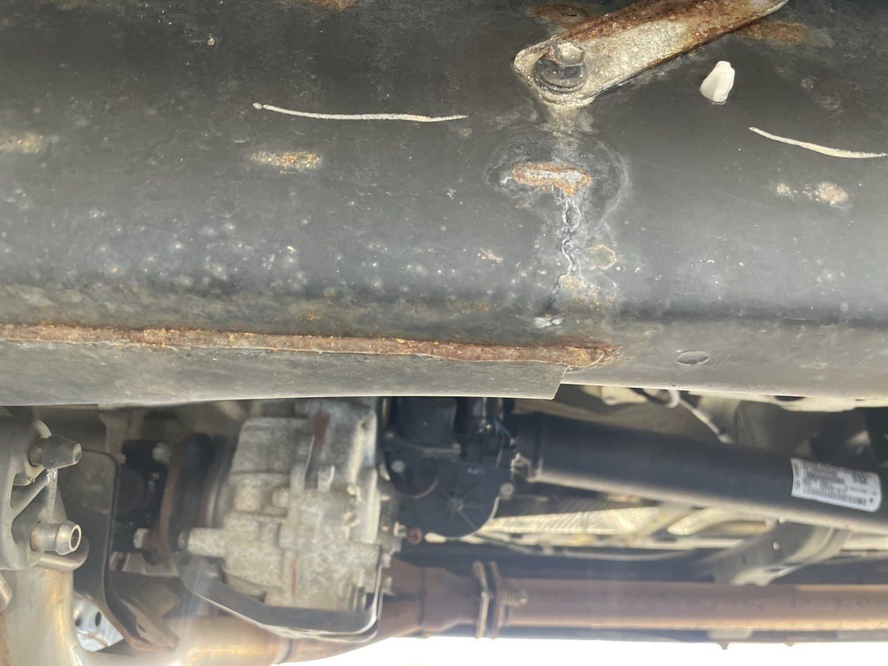

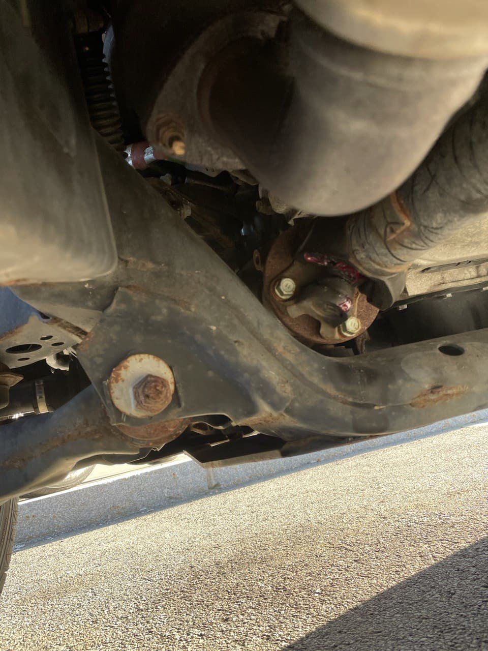

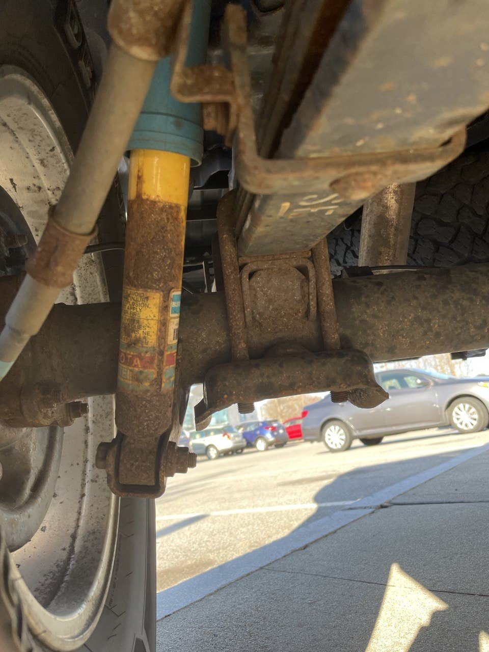

    So I checked it out today, honestly not even interested anymore once I saw the rust, they were asking 27.5k. I said I wouldn't even go higher than 21k looking at the rust that was there. I also wasn't seeing the CDC coasting from toyota that was stated on the carfax? no "oozing" from the frame. The trucks engine and interior was spotless but thats not what kills tacos as we know. It also was a 2015 OR DCSB with only 59k miles and in the pyrite mica color which looks great. I'm wondering now if I may have to go to the south or west to find a good truck if the rust is this bad...

    Doesn’t actually look like the frame was coated. The plugs aren’t there and the inside of the boxed section doesn’t look coated.

    Looks like a typical New England truck to me. Frame looks fine it’s just the rear end and shocks that look rusty.

    Looks good to me. I’d actually expect it to be worse. All of the photos you posted is just normal surface rust.

    2023 TRD OR DCSB MGM
    I agree the frame could've been sanded out with a wire brush and then repainted but the rear suspension components were wrecked. They looked like they had 12years of rust on them rather than 6
