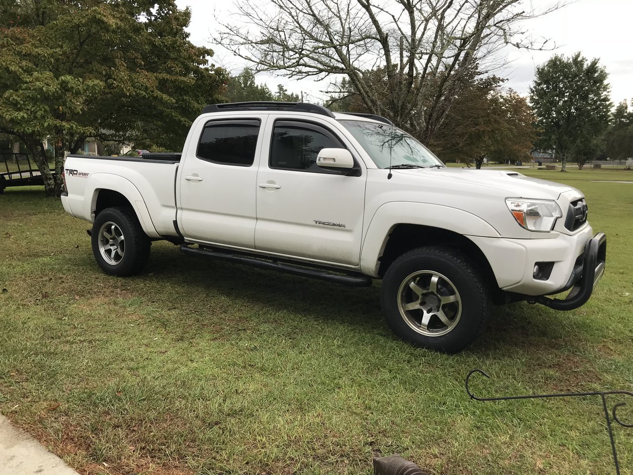

    The truck looks pretty level to me as is.

    I guess what I'm trying to say is would a 2" spacer make it that level with the 1" block in the rear. From what I've read a 2" spacer up front will make the truck level so if you put a 1" block in the rear wouldn't that make the front a bit lower?

    I saw this truck in another thread but there was no info on it but would really love to know if this truck is lifted and what possible size tires are on those 16" rims? I think I'm set on these OEM TRD black rims but not sure if they are 267/75 or 285/75 and if they are the 285/75 I would think you would need a lift in front and back to level it out.
