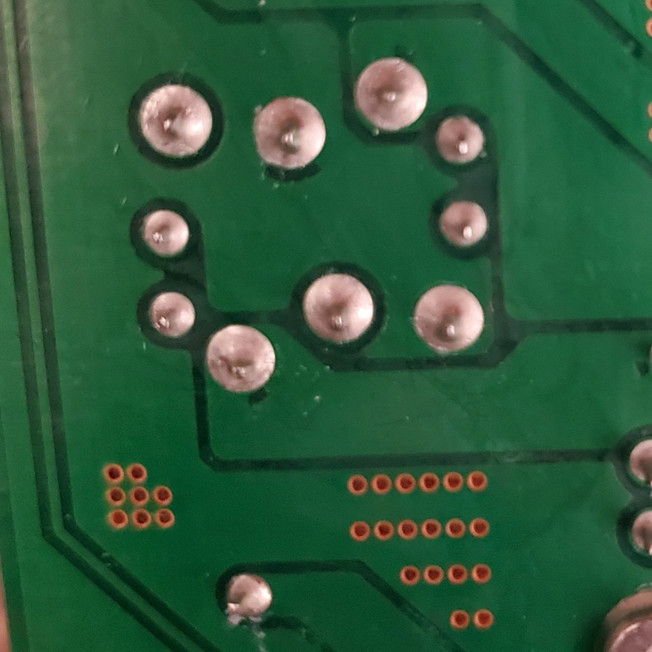

    The clicking noise is in the front end from like 15mph and under, goes away after that, like the front axles are not fully disengaged,, like I said new add,,,, they said the clicking noise was in transfer case,,, caused by me not putting it into 4x4 enough,,,,,, I would put back into 2wd, and the dash "ecu" would click a bunch struggling to disengage, I would unplugged battery, plug back in and it would be back in 2wd,,, I had to do this prob 5 times,,,, then one time it just clicked amd clicked and even unplugging battery didn't disengage, that's why Part of me thinks the relays are burnt, so the new ADD installed doesn't matter

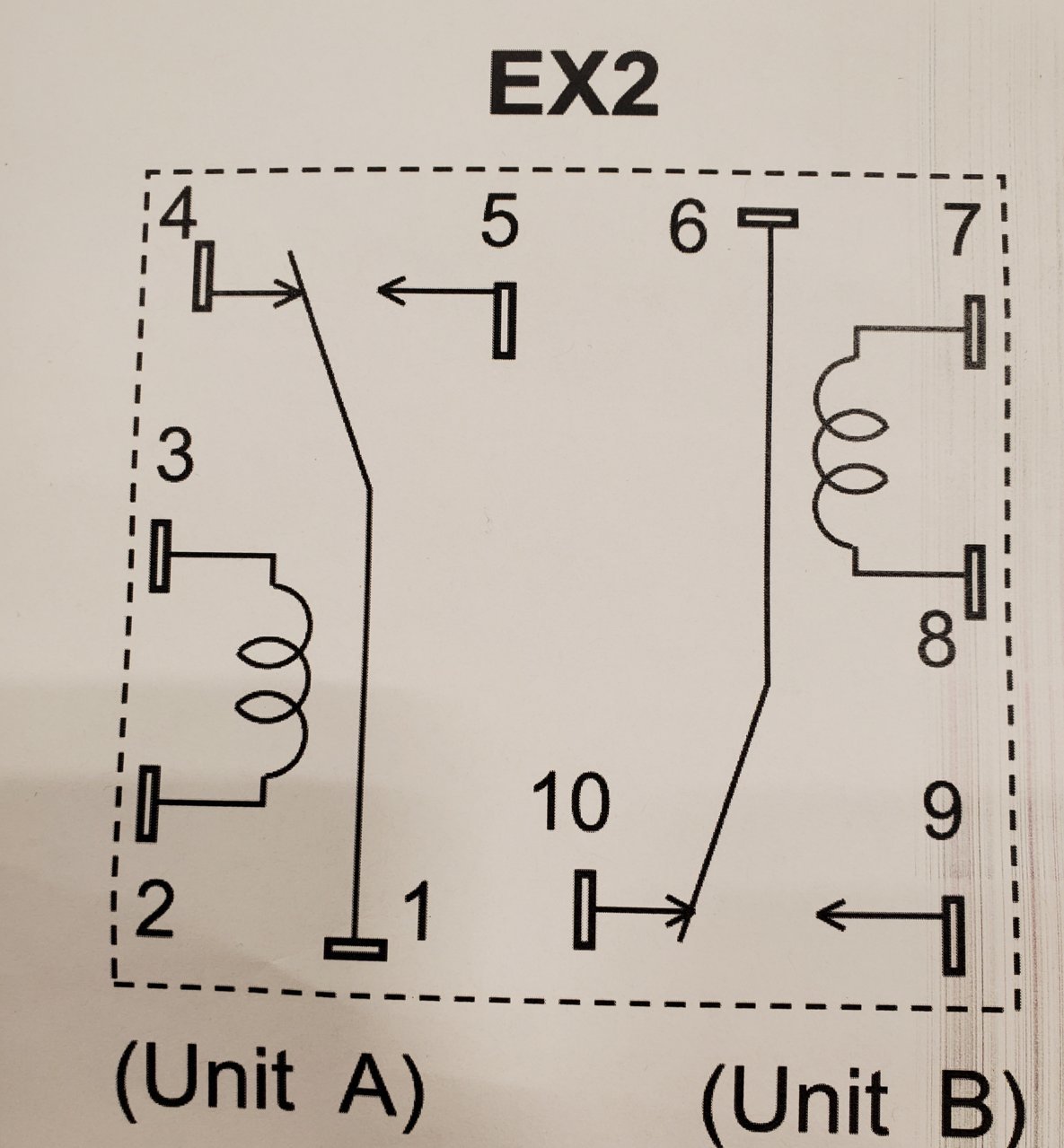

    Update, tested the 2 relays at work today and RY2 has a short/issue, added power and it shifted to NO,,,,but it's showing continuity at NC and slight cont at NC without power, guy at work who electronics guy said it's worn out
