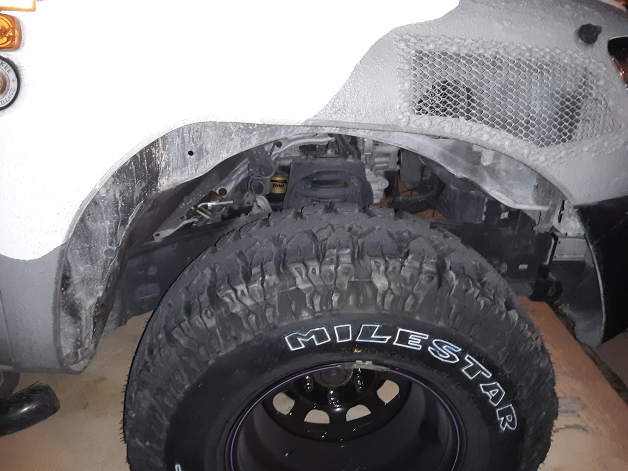

    Hoodscoop is fully functional.. Along with the side vent is directly to the intake box.. I have the original box just ported on the bottom part with mesh lol

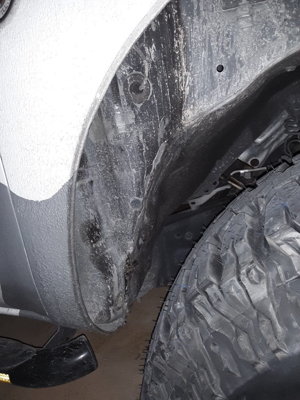

    This is how you can fit my wheels and tires by cutting the front fenders only.. I had 15x10 3.75 back space on 32x11.50r15 before and had no issues.. 32's without a lift is the max I believe with 15x10.. It's possible with a 15x8 on 33x10.50r15 to fit

    I cut it myself but you can do it also.. I just followed the original line it had on the fender but you can take it to a shop to do so..

    15x10's with 2" Backspace sticks out a lot.. The turning ratio is very wide.. I had very little clearance but no rub
    Casper66 likes this.

    Trim fenders, flatten pinch weld, edge guard on cut fender, I can't quite make out what was done with the cab mount
