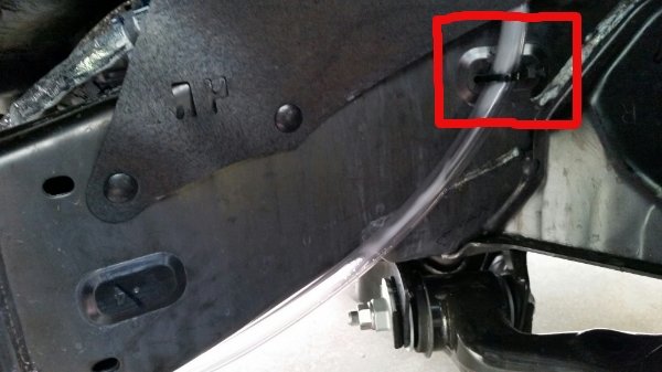

    I was contemplating on going this route as well, but my instinct told me to route it outboard away from the exhaust.

    i did that. I went down through the cross member and out right inside centerline of the passenger rear lower control arm bolt. Exhaust is plenty far away and have not had any heat issues.

    I thought about that and have been checking it throughout the day driving around. It stays up against the frame and didn't melt.

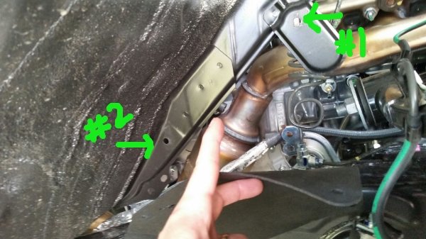

    When I look at these pictures, I am unable to determine where to afix the extension tubing. Any assistance?

    affix it anywhere you feel comfortable doing it. As long as it doesn't move or fall off and won't rub with any moving parts..

    On the 2014 if you look up from underneath there is a metal tab that is part of a bracket that the wires are attached to that is affixed to the frame. I just zip tied to that.

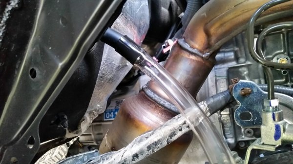

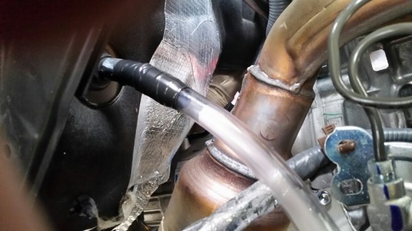

    There's obviously a few ways to do this. This is my version:

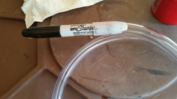

    I bought 5/8" OD x 1/2" ID tube, lubed up the end of a super Sharpie and jammed it in there to stretch it out a little.
    c6d30168-0fdf-41a3-8320-dda94d1dff8e_zps_a6317b75beb3ed502ec65791493b7f4db9447b53.jpg
    With a little lube on the tip of the drain hose, I quickly pulled the marker and slid the clear hose over the factory hose. (Note: in this pic you can see the crusty white stuff that was getting all over the wires and frame from the ac drain water)
    d73c81c0-74c3-4760-bb2b-cd69b0247d57_zps_1e2edf0264d44e295cbf64bf27a737253d48036c.jpg
    Wrapped it in quality 3M electrical tape.
    baaef7cc-4056-4ab5-b5db-eef83b80c5d7_zps_79a7ce3a60d46d3707d0d981580e11891233c4ff.jpg

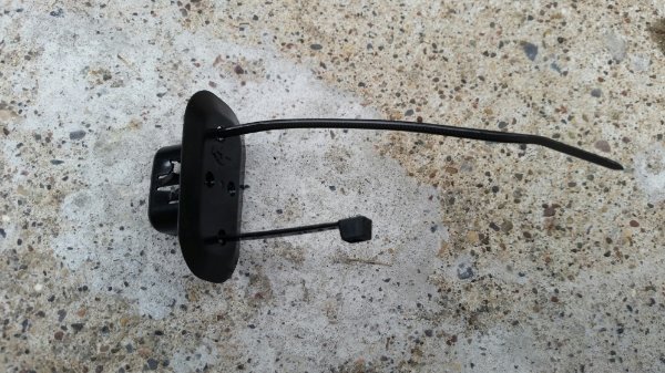

    I ran the hose to the outside of the frame. I pulled the rectangular plastic plug that is just below the rubber shield and drilled two 3/16" holes in it so I could run a zip-tie through it. Ignore the other two holes I drilled. I drilled them first and then realized I needed the zip-tie to go the other way. Filled -em with silicone before reinstall.
    3b2ea369-cc0b-46e4-922a-f7445613475d_zps_cb94a8f727f537d2fa5bbeb5c58583ea3f8a1141.jpg
    65f4f63d-4979-4925-9d51-fabce801a3d1_zps_7397736fd7601d5cdf4ef1a8350d876ce0b6d754.jpg

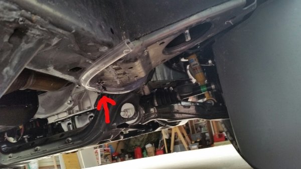

    Went along under the frame and put another zip tie through two bolt holes in the underside of the frame (this was tough, had to use a pick and flashlight to get it pulled back out). Hose ends a couple inches outside the frame.
    e1d44ff1-f35e-4a0d-a073-33ba420933f7_zps_6e65a0a70e8651a564d820a75ac6b502a63c9e45.jpg
    I may shorten it up in the future, but I'll roll with it for now and see how it goes. I don't off-road so I'm not worried about it getting crushed between a rock and the frame. My only concern at this point is freezing up in the winter.
    By the way...this was my first mod as a new Tacoma owner. I'm sure there will be many more to come.:cheers:

    I extended mine thru and just below the frame, hangs down about 1"
    I bought a brass coupling and some rubber hose, works great.
    I secured the hose to the coupling with hose clamps.
