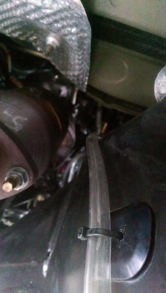

    You don't think that plastic will melt being next to that cat?

    Ive been running it for several days now, and no melting or distorting of the tube. I may pull out the plastic cover thing in the frame that you can see right next to it in my pic and drill and zip tie it to that as well like Notoneiota did. That will move it farther back away from the CAT.

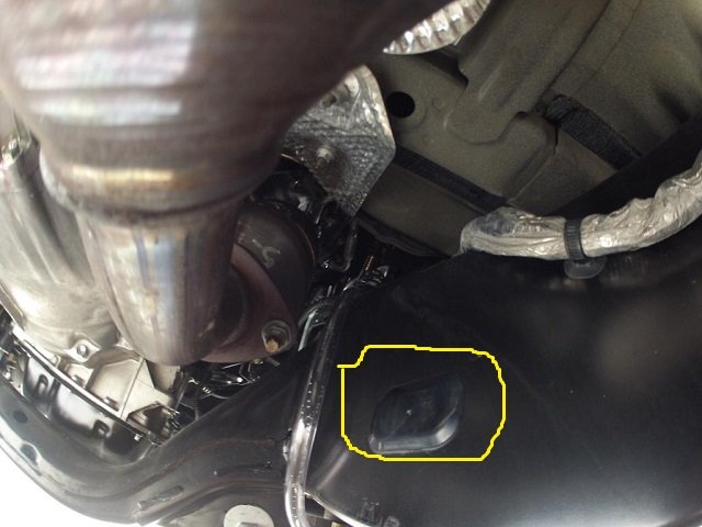

    If you happen to get under your truck again, would you mind telling me the number on the frame plug in the lower right of this pic? Looks like a 7 or 2, but I can't tell for sure. Thanks! :)
    In regards to the drain mod, does anyone else think that the hose being extended down/zip tied to the frame might cause stress on the line leading into the firewall from the truck body moving up and down with the suspension as one drives?

    dont zip tie it to any moving parts..

    The frame isn't technically a moving part, but when driving the body of the truck is going to move up/down and flex with the terrain.

    So far mine was still the same way when I zip tied it. Just keep an eye on it. Maybe check it once in a while just to make sure that it is not moving or have fallen off.

    Modded it again to ensure no heat damage to the hose.

    Pretty sure the plug on the inside of the frame is a 7.
    The drain comes out of the firewall. the firewall/body is attached to the frame. There should be minimal movement if any at all. Maybe if you're flexing off-road, but not for everyday road driving.

    It is #7. I took a pic just didn't remember to post it.
