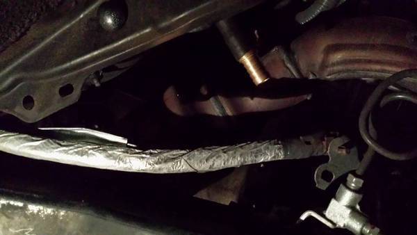

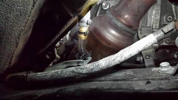

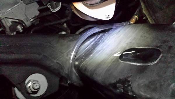

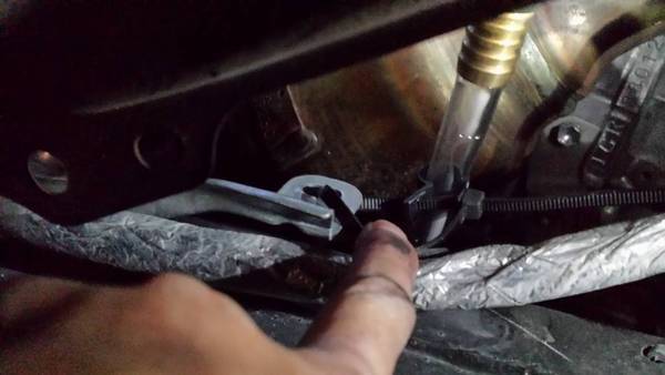

    Thanks for all the great pictures, so I'll send mine in and hopefully it will help the next person. :kona:
    1/2 inch fitting used and I had to really muscle it in.
    There is an already gray latch for the electrical wire with a hole in it, so I used it.
    I chose to let the hose drain directly straight down, so I can easily inspect it from the front passenger side wheel well. With the 4 zip ties used there is no movement for the drain hose to move around. By the way the hose says it can handle up to 175 degrees.
    The finished product.
    4 zip ties
    2 rubber coated clamps
    1 1/2" hose
    1 1/2" brass hose barb.
    Brought it all from the local home depot for about 7 bucks.

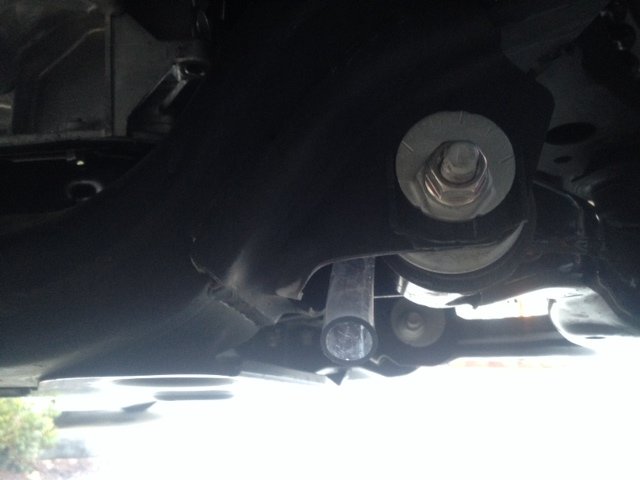

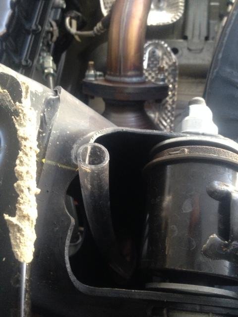

    Same here, so I said eff-it and ran it through the A-arm portion of the frame. I didn't use any zip ties or anything, as the hose simply isn't going anywhere like this.
    I started to pry on those frame plugs, then quit when it sank in that I might not be able to get replacement ones.
    Anyway, here are a few shots of the line feeding through the existing holes in the lower control arm, with this method there is zero reason to zip tie it to anything, as the line simply isn't going anywhere, and it is no where near the exhaust or electrical zones.
    *Please excuse the mud, took the truck on it's maiden Off-road voyage yesterday*
    Here's how it looks, hanging from the bottom of the A-Arm opening. I have since trimmed about 1 1/2 inch from the amount visible, so the tubing is level with the A-Arm. I didn't like seeing the clear tube visible from under the truck. Nobody else would have noticed, but it bothered me.
