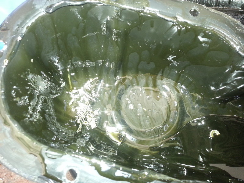

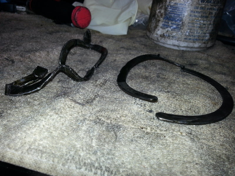

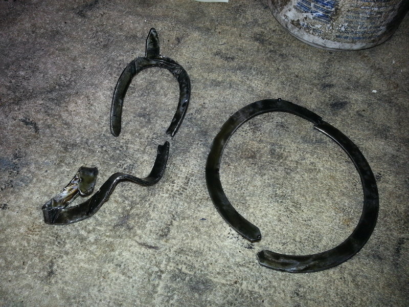

    This happened on one of my engines....
    Ran for a race and few months of dailying, an engine swap found it. All bearings were still in perfect shape.

    What is that?
  10. Jul 15, 2017 at 10:55 AM
    #50
    opg4
    opg4 2015 TRD Double-Cab Short Bed
    Feb 22, 2015
    #149317
    104
    Beautiful Land!!
    2015 Tacoma Prerunner Double-Cab 4.0
    Looks like oil-pan and the debris/parts in it....

    I mean where did it come from? What let loose?

    Thrust bearings. Crank was hangry. Chewed them up, and spit them out.
