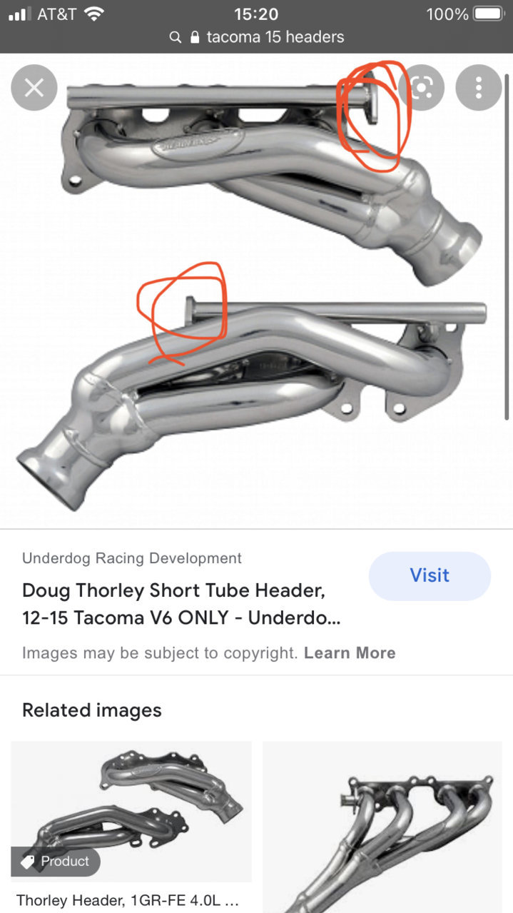

    Alright the motor is in the truck, I used block off plates. Truck will turn over but won't start, what can the issue possibly be????

    You fully deleted the SAIS, correct? Did you use your 2005 harness and ECU? Is everything hooked up? Battery charged? Fuel lines all hooked up? Is the fuel pump kicking on? To me sounds like something isn't plugged in or a fuse is blown.
