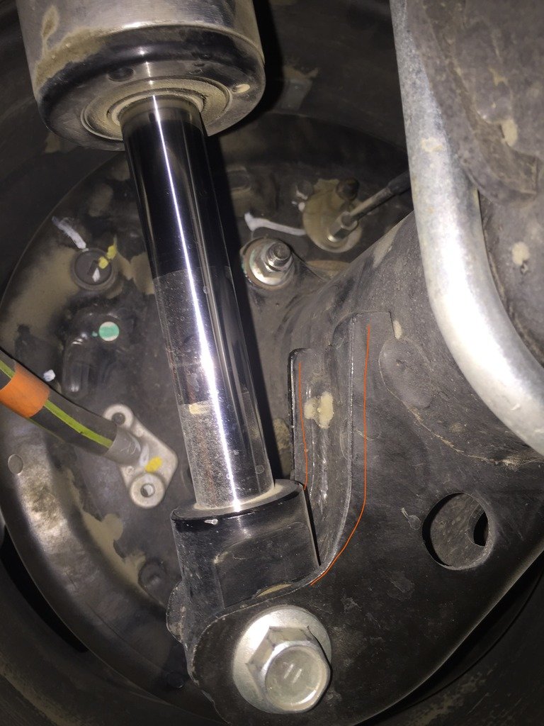

    It's difficult to see here because I had already wiped the dirt off, but my icon 2.5s will contact the shock mount in the last 1-2" of compression. 2" body icons MIGHT fit.
    Look, the problem is just a stupid design. It works for OEM shocks, and that's what the factory cares about. They are fairly stout shock mounts, but if you use the full suspension travel with most any performance rear shock, you might as well have a grinder on hand before installing the new shocks. I'm going to have to pull mine and cut the schock mounts more. I already had to clearance inside the shock mounts to fit the rod end of the shock.

    alright I'm officially lost where are you trimming I see enough space on the right side of the shock with no interference or is the trimming done near the bolt?

    It's pretty obvious if you look where everything would be if the shock was fully compressed. I've circled the contact areas in red. Due to the thickness of the shock mount on this area, and the angle of the mount, the shock body contacts the mount on compression. It is hard to see because I've only allowed it to compress and touch once, and there is still nearly an inch of compression left in the shock.
    Additionally, the area in yellow is where I already had to trim to fit the the shocks at all. There is sheet metal inside the shock mount, that is parallel to the shock bolt. It comes very close to the shock bolt and had to be trimmed to fit the rod end in theate and get the bolt through.

    Here is another very crude iPhone sketch of where I would like to cut my mounts.

    I was one of the lucky ones to have my OME rear shocks not fit. It wasn't a big deal. I ground off about 3/16" and was good to go. Before and after pictures.

    There you have it, an actual picture. ;) thanks for posting

    Your welcome not the best pictures but you get the idea. ;) Also sent a bunch of pictures to Marie at Headstrong in case any customers had question regarding this. Sometimes a picture is worth 1000 words.
