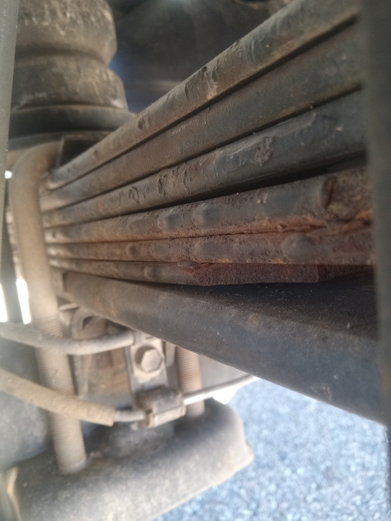

    Here's a better pic if the 3 leaf add a leaf

    The fronts are installed correctly and the stock coils are preloaded to give lift.

    265/75/16 S/T Maxx 16X8.5 Level 8 Trackers 5100 1.75 HID, LED interior, 3" N-Fab step bars
    What tire pressure are you running? Should be around 30-32 for a soft ride. My Dads runs his tacoma tires at 40 and you can feel every bump.
    You also have 7 leafs, I cant tell if you have a completely new leaf pack or they added some. 12-15 tacomas came with either 3 or 4 leafs (Most had 4).
    I suspect you have some of stiff leafs or some sort of homemade leaf pack that was not designed for smooth ride in a a tacoma but for carrying a heavy load. Might be able to remove a couple and see if it helps your ride
    Looks like they may have added 3 leafs to the top of your factory leaf pack, but I am not 100% sure.

    Primo 95. It was done by a well known shop. It's a 3 leaf progressive add a leaf. It's the two skinny ones on bottom and the real thick and straight half inch one on very bottom I believe because the top 4 are painted black and have a shackle around them

    See shackle around top 4
