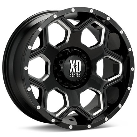

    As far as wheels, I was thinking of getting these a while ago, before I went with what I have now.
    [​IMG]KMC XD813 Battalion
    These are one of the only black wheels I've seen that I really like. Plus I haven't seen one Tacoma online with these wheels yet. You could be our test dummy.
