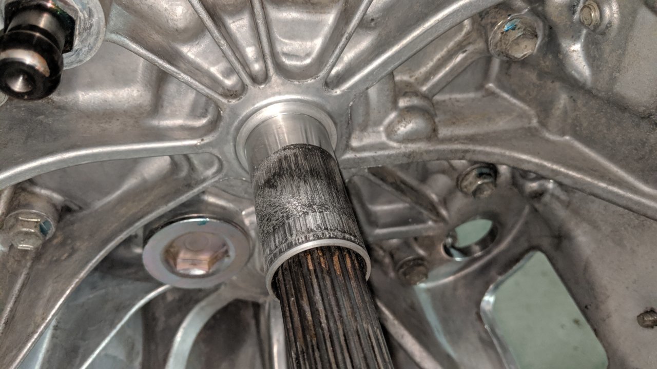

    Traded the 2015 TRD Pro 6spd Supercharged on a PowerWagon and could not be happier. My 2011 Tacoma with the TX Baja package (Added by me) is still treating me great. My 1985 Toyota never skips a beat.
    2nd gen is about the same, except 1st gen is likely more rusted lol.
    1st gen trans is easier to handle, the RA60f is a fat pig.
    There is no pilot bearing in the 2nd.
    I also run the heavy flywheel from URD.
    If you do the URD clutch, you will want to clean the powdercoat out of the bolt holes and holes for the dowell pins, it messes with the torque on the pressure plate bolts.

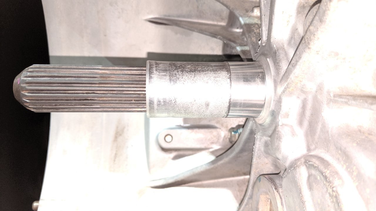

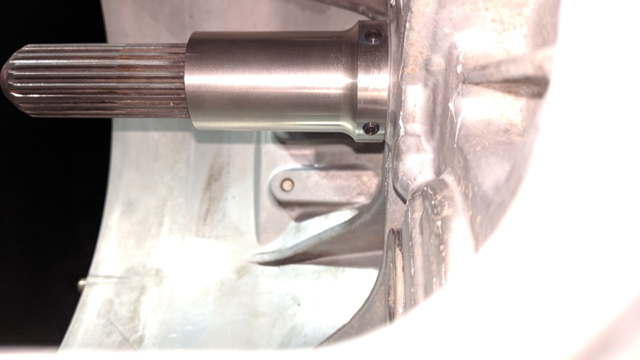

    The 2nd gen throw out bearing is a different design, and it sucks.
    Also, the quill it rides on is Aluminum (it was steel in your first gen)

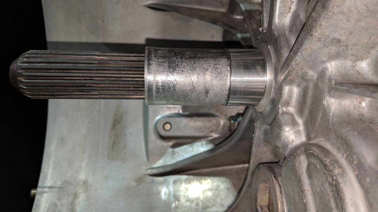

    Yup thankfully mine wasn't gouged out yet so I did the sleeve. I wouldn't have minded doing the Hydro but I was barely comfortable changing this much with the help of Josh as neither of us have mechanical backgrounds and lacked a solid guide.

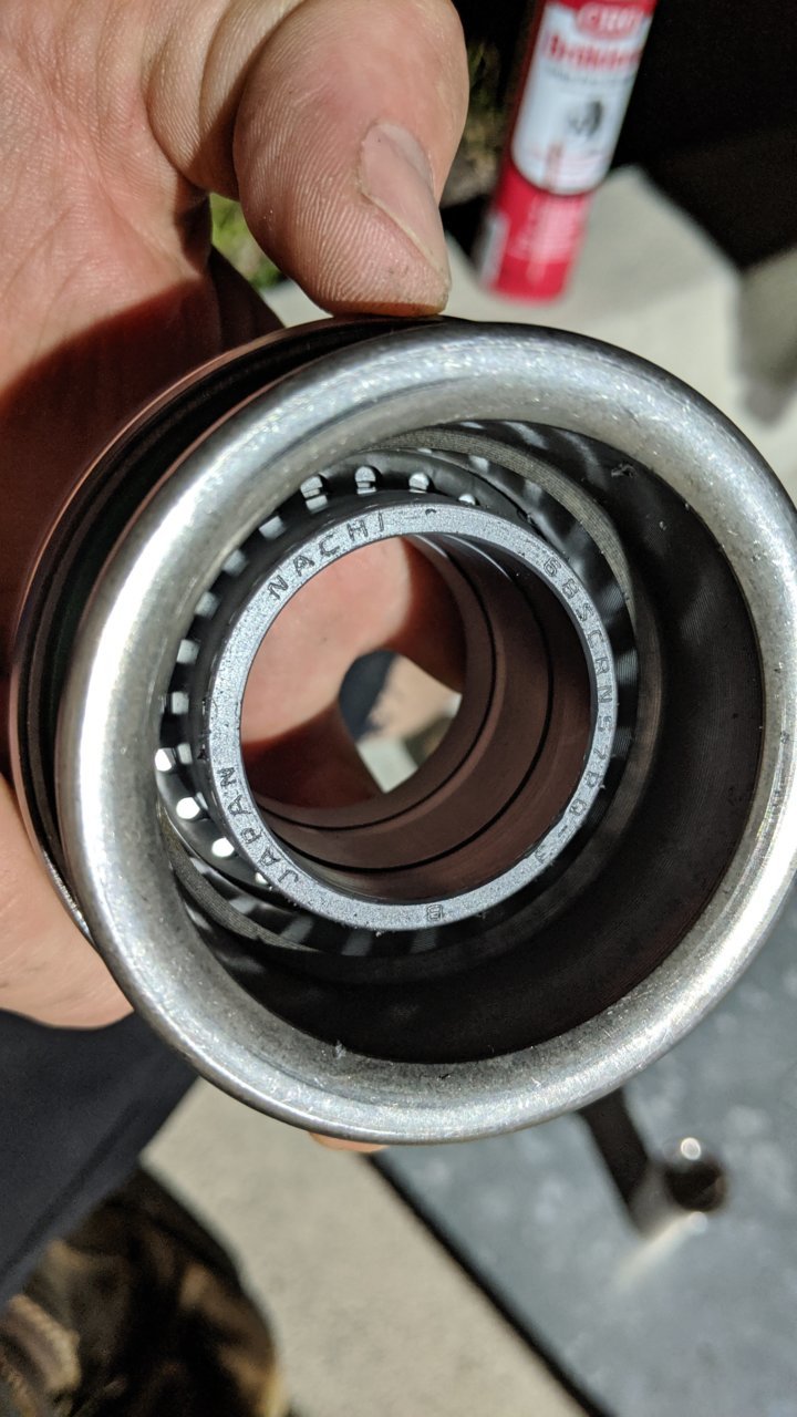

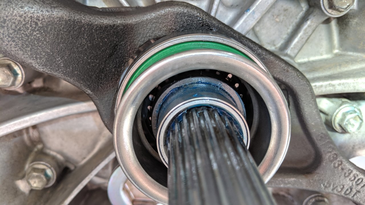

    Key-Rei Well-Known Member
    Jun 20, 2017
    #221942
    7,863
    Key
    Florida
    2010 TRD Off-Road 6Spd 4x4 209BSM
    Locker anytime Fog Lights anytime Full LED light conversion TRD cat back Rear cat delete Exaust Y reroute away from actuator Alloy Clutch master 2000 4Runner "Dog Leg" shift leaver Marlin shift seats and bushing Rear seat delete Rear diff breather extension Chrome grille swap Debadge Rear seat delete Honda blower motor beefy plug and wire mod Anytime 12v and USB with volt gauge in bed Blue Sea fuse box Hella AND 70's Caddy horns Low profile recessed hex drain plug swaps Alluminum battery strap 7pin relocated Backup cam on anytime Various other creature comfort and personal taste mods.

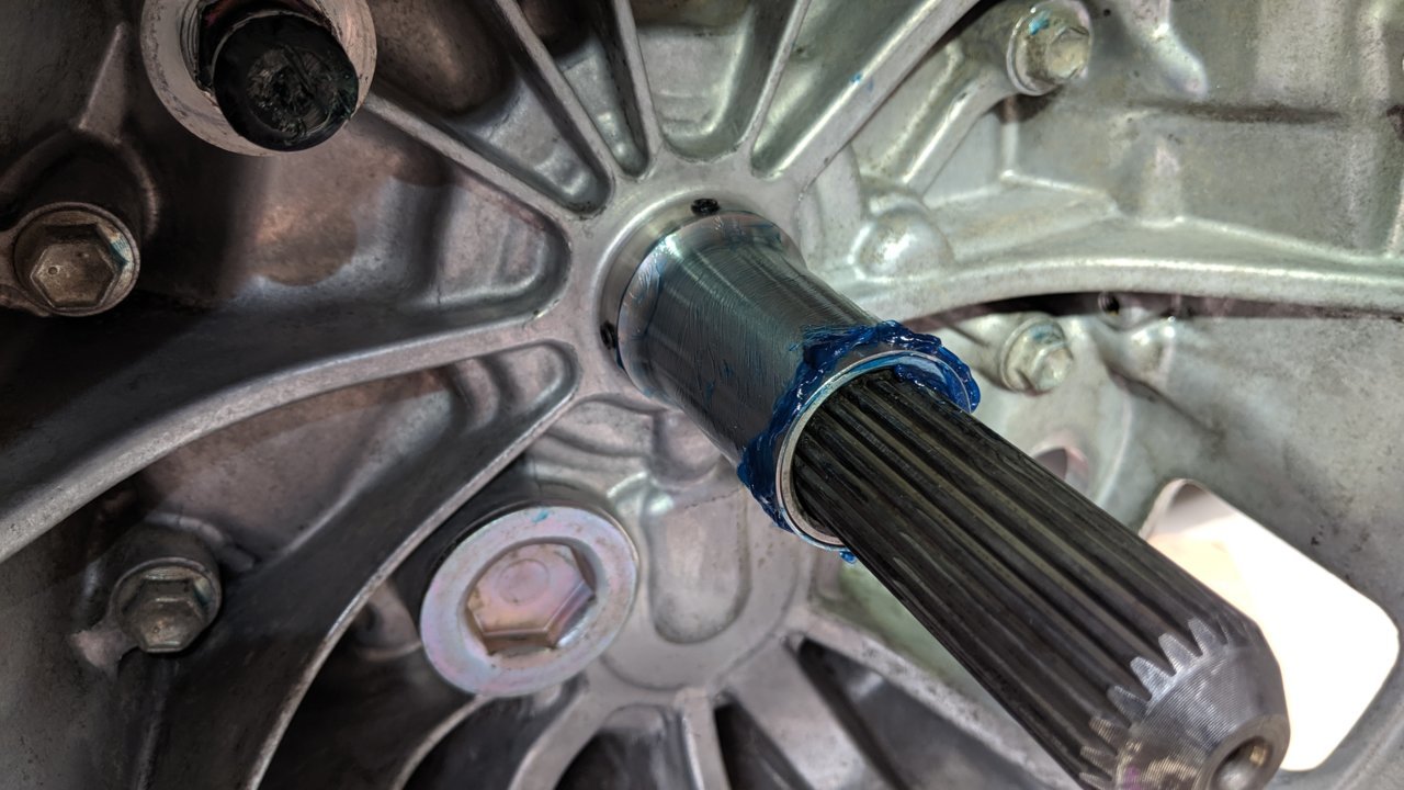

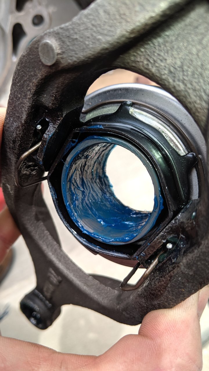

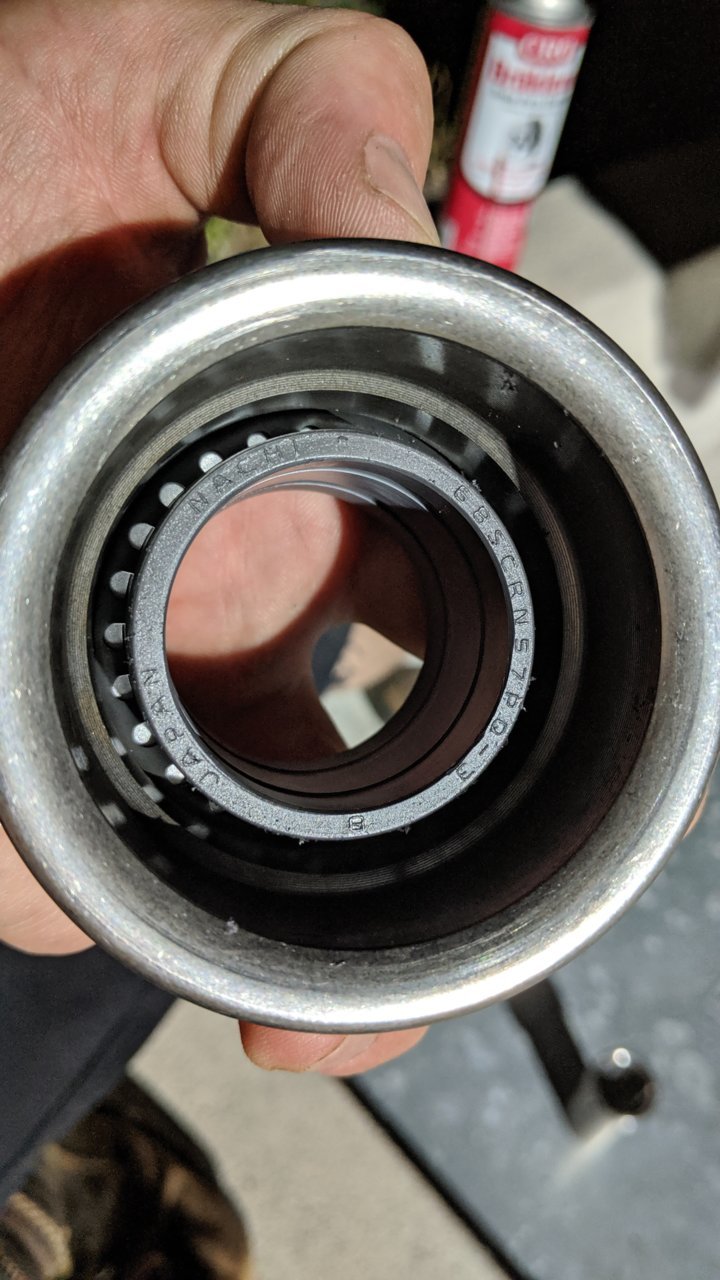

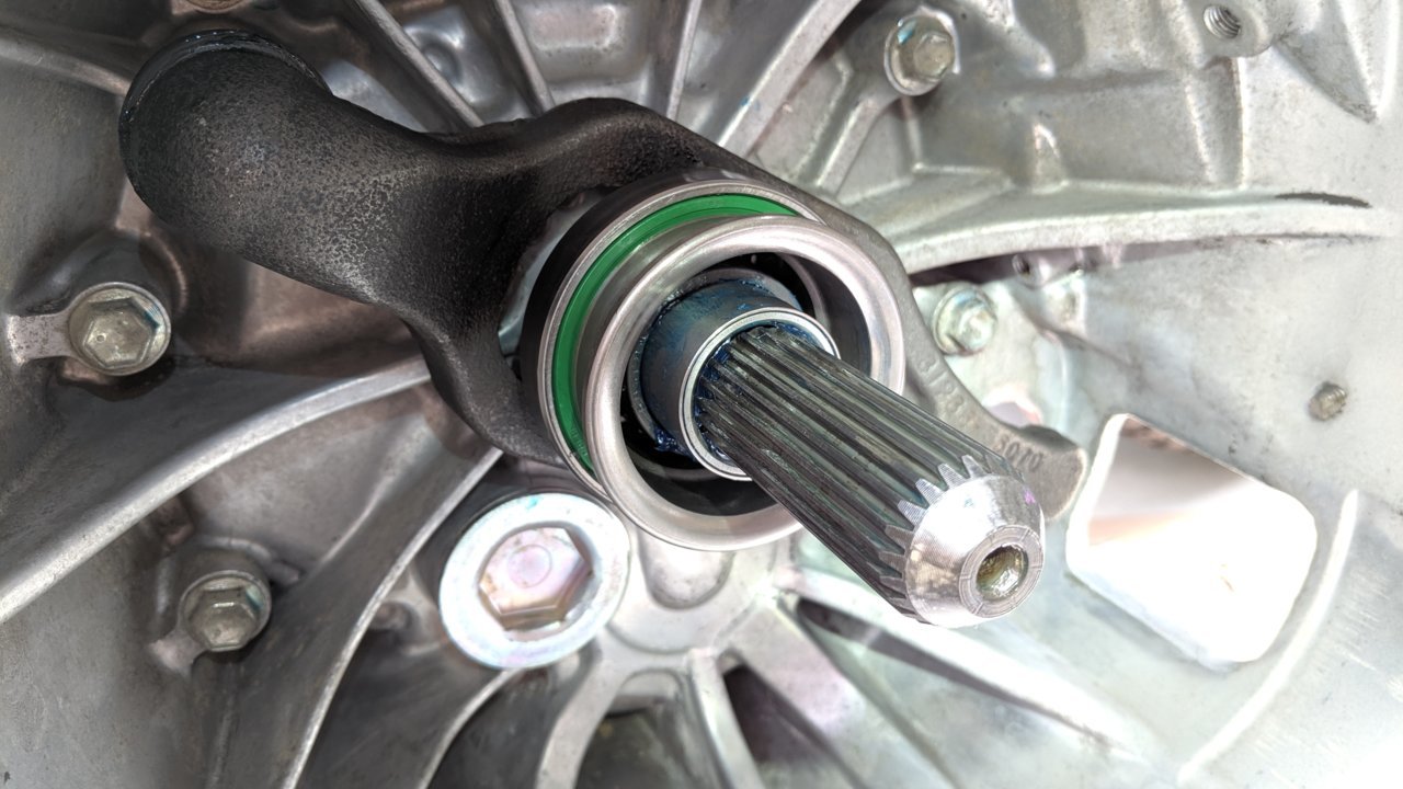

    The FSM states the throw out bearing itself is permanently lubricated and doesn't need nor have provisions for lubricant in the bearing, the inside sleave however DOES need grease and has channels cut into it to hold the grease.
    Where did you find directions to pack it into the holes in there?
    I'm confused and concerned as I'm in process of replacing my stuff and I did NOT put grease in there.
    My OEM bearing that came out did not have any signs of grease in there and the Nachi part number is the same as the one on the URD bearing which leads me to believe they use the same bearing and simply mill the inside a few thou to clear the stainless quill sleeve.

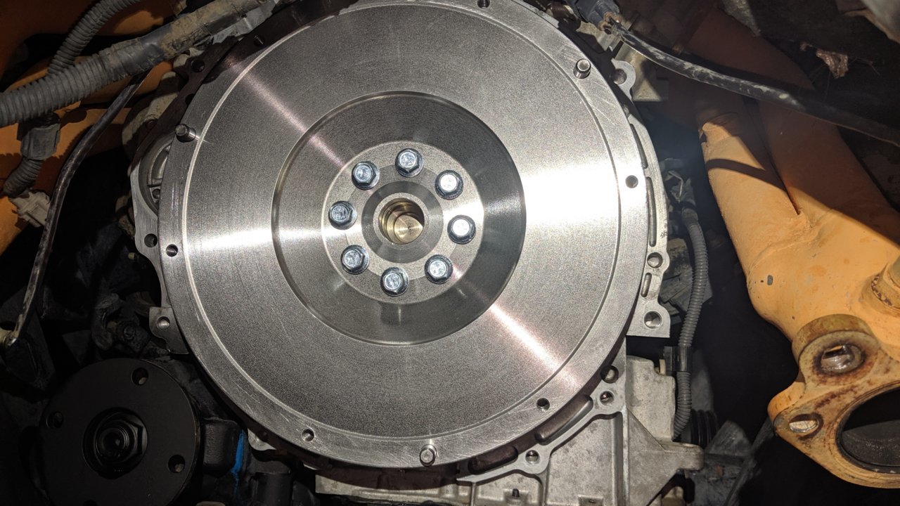

    Lastly I used the washers that came with the URD bolts for the heavy flywheel, the bolts are not ARP. Was I not supposed to use the washers? I read somewhere to not but they were installing the light flywheel with the ARP bolts.
    This project had been an absolute fuster cluck from go and has had me second guessing and running out for more parts and in general just running me ragged. The URD "instructions" are so general they only helped me have more questions and confusion.
    I just want my truck back it's been down for two weeks. Currently waiting on a part Toyota ordered and then somehow it never showed up.
    Sorry for the picture spam but I kind of want someone who's been through this to double check me here.

    Interesting the the inner sleeve on the TOB is gray plastic. Seems weird to have all the grease exposed to collect clutch dust. I guess at lease it will be slippery dust. :thumbsup: I just put a new kit in my 05’ that has 206000 on the original clutch and TOB. The TOB was only bad part but might as well do it along with the rear main.

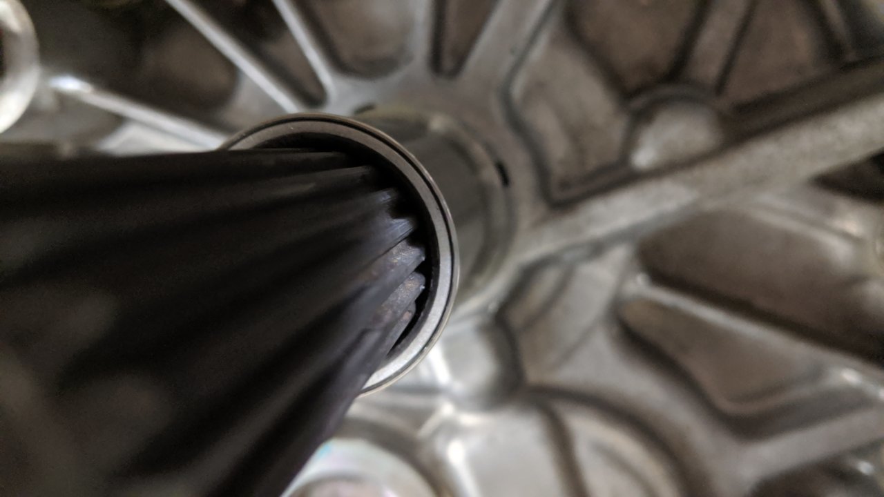

    I’m doing this on a 2WD version trans. The center hole of the pressure plate fingers looks off center to the pilot bearing on the crank and clutch disc. Is this normal? I’m pretty sure I got the alignment tool all the way in.

    There is no pilot bearing on the 6speeds, so yes it's entirely possible your alignment is off by quite a bit, in this aspect the alignment tool is much less an alignment tool and more simply a device to move the clutch disc while installed behind the pressure plate. I suggest eyeballing as best you can using a tape measure or calipers to fine adjust and hoping it's aligned well enough before torquing the pressure plate bolts down.
