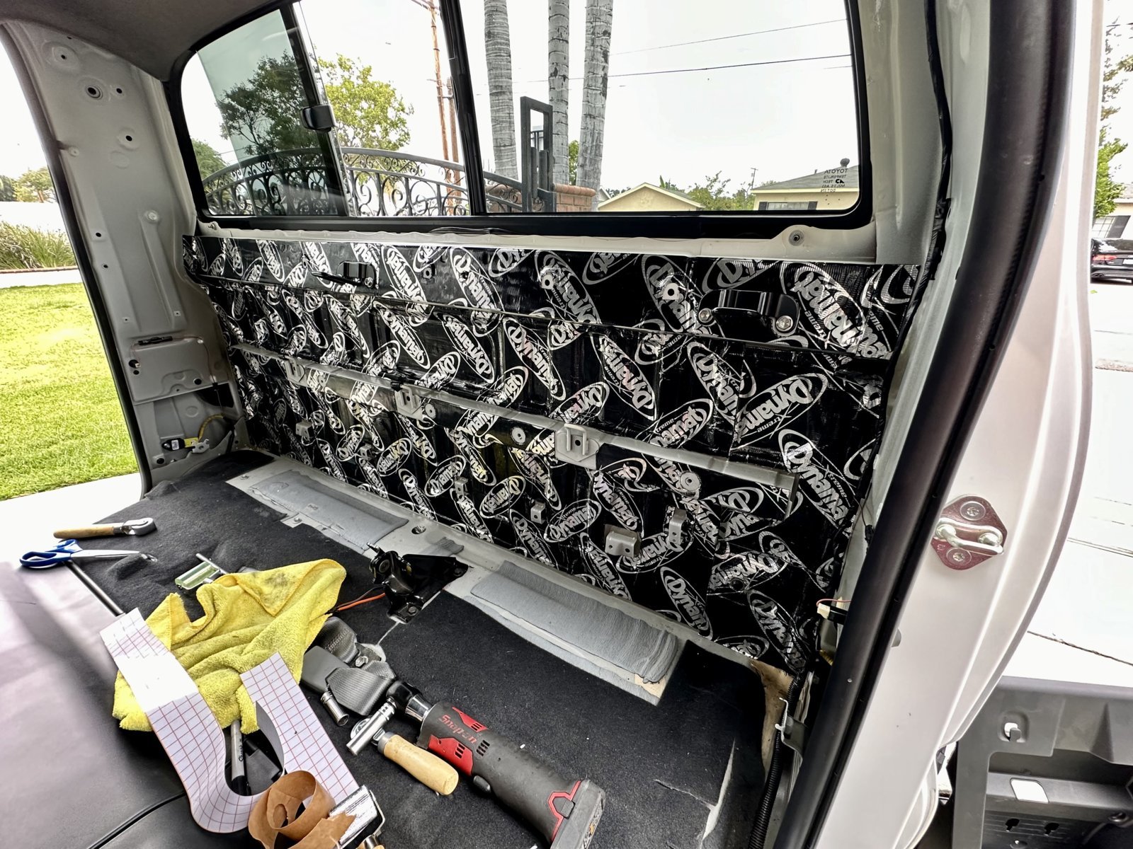

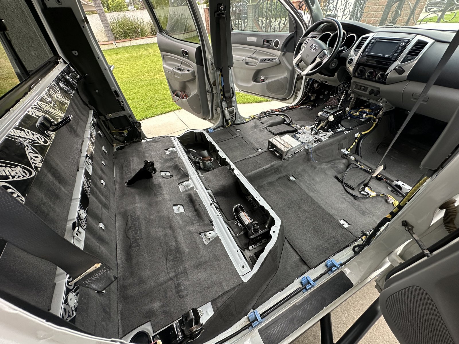

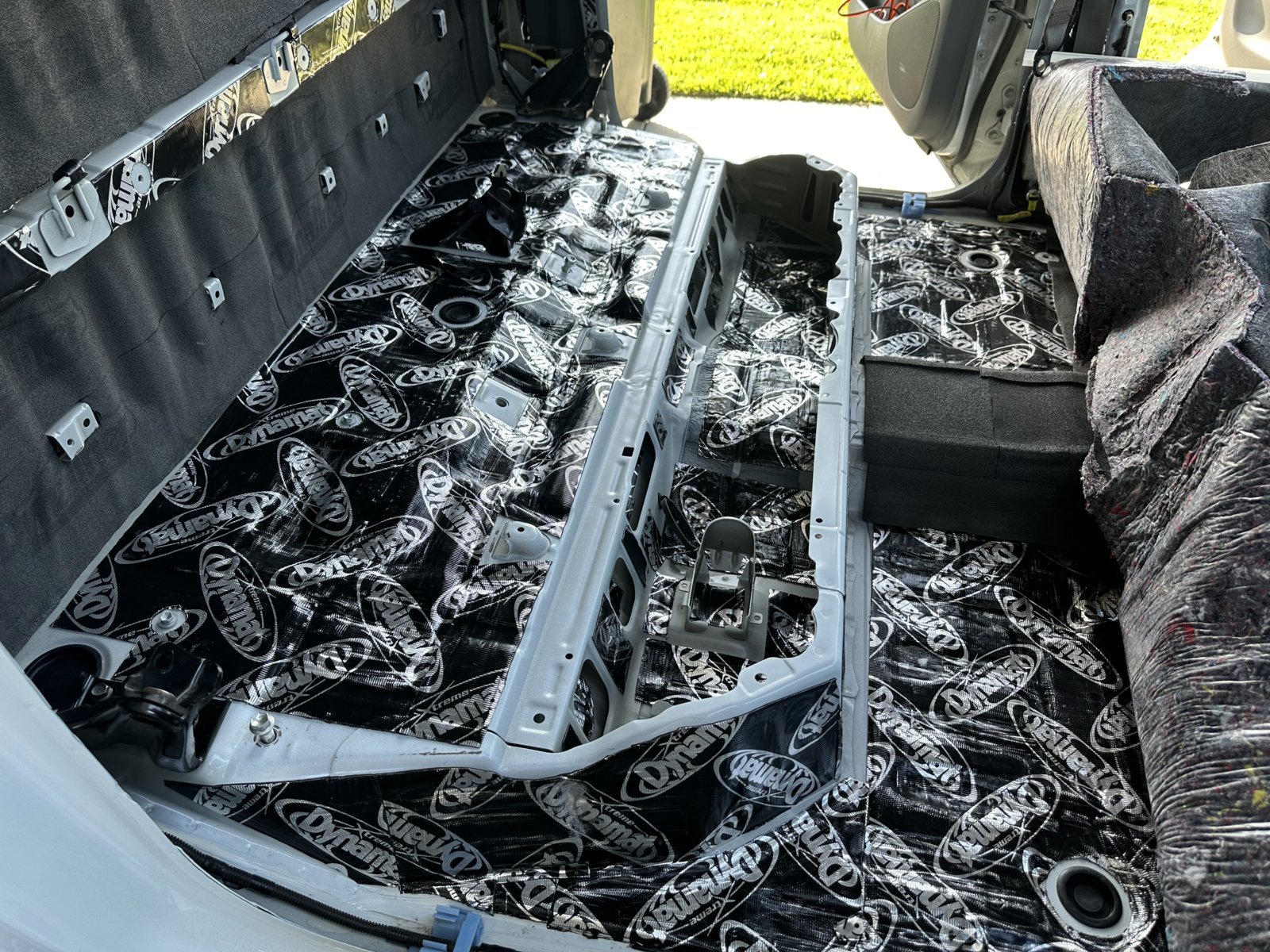

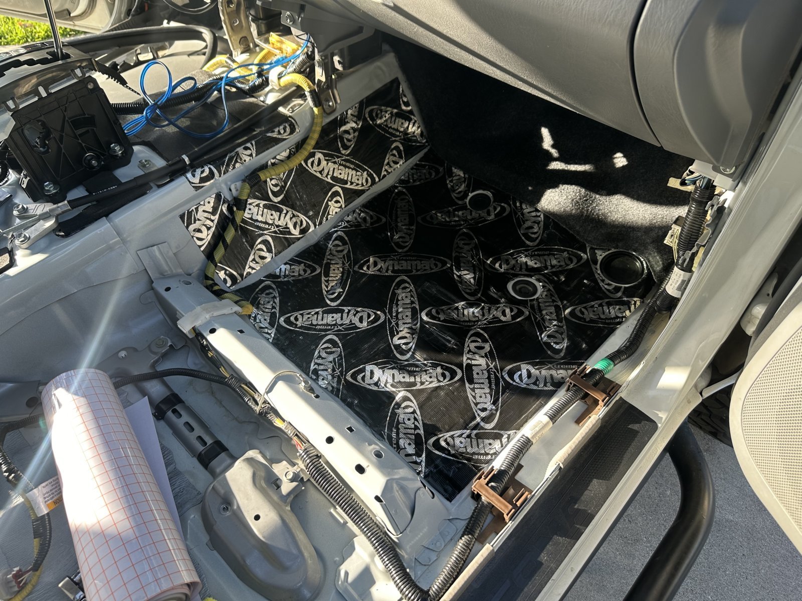

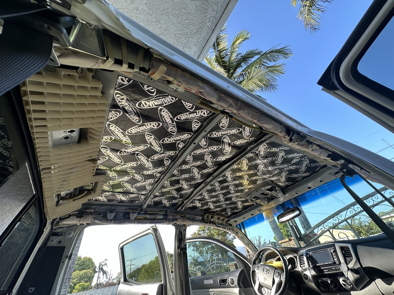

    Here are some pics of the sound proofing process. It took 12 working days at 6 hours per day for the cab, and I still have not done the doors.

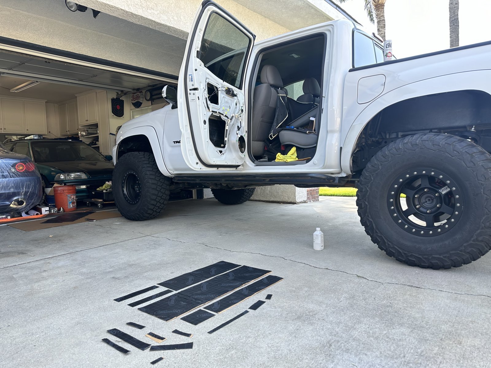

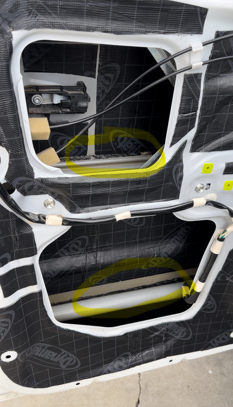

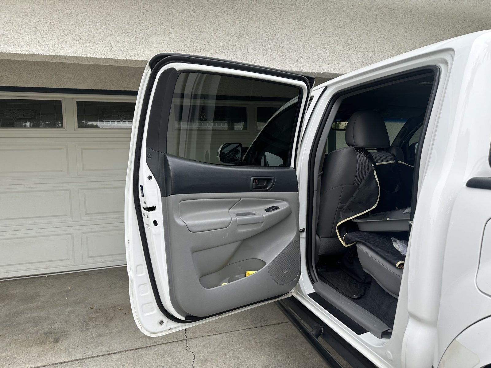

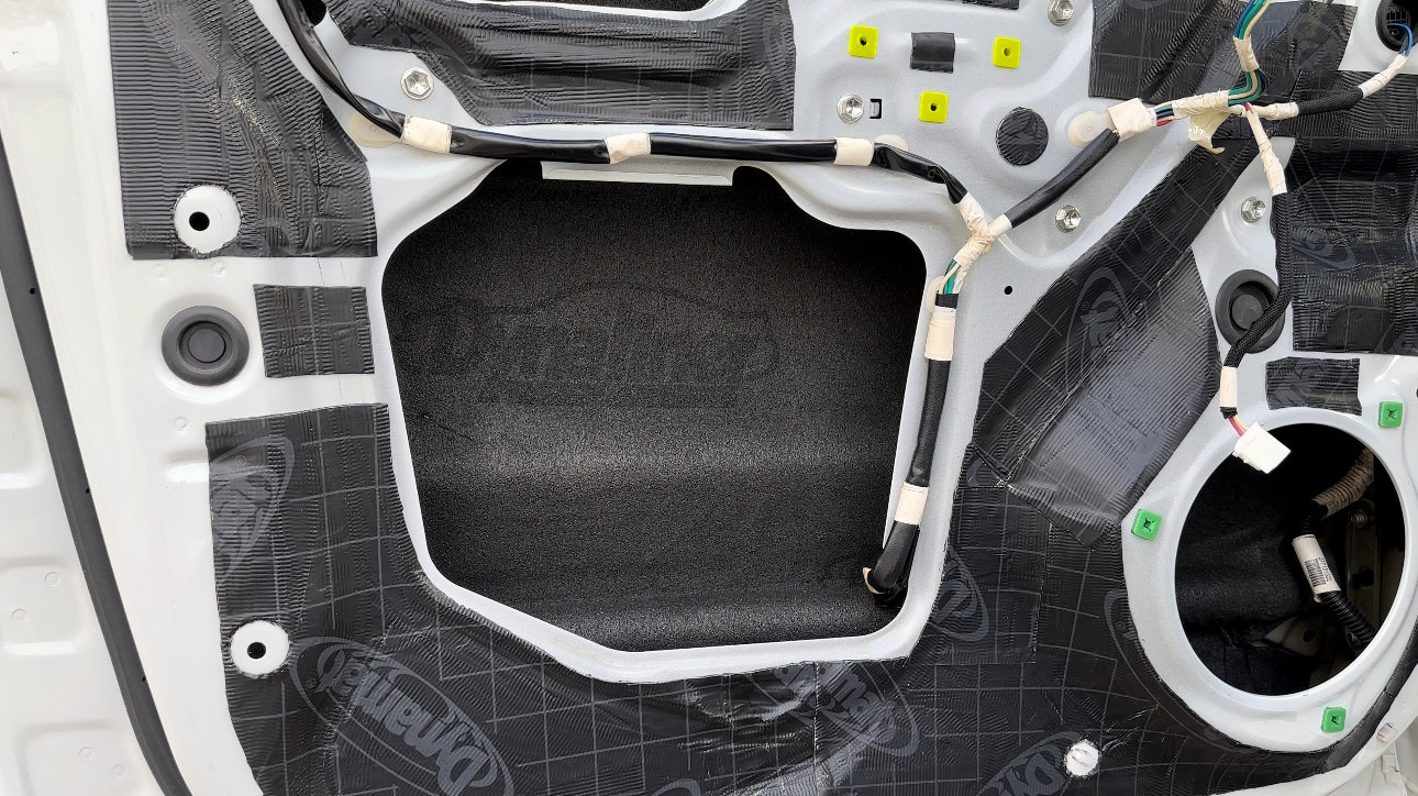

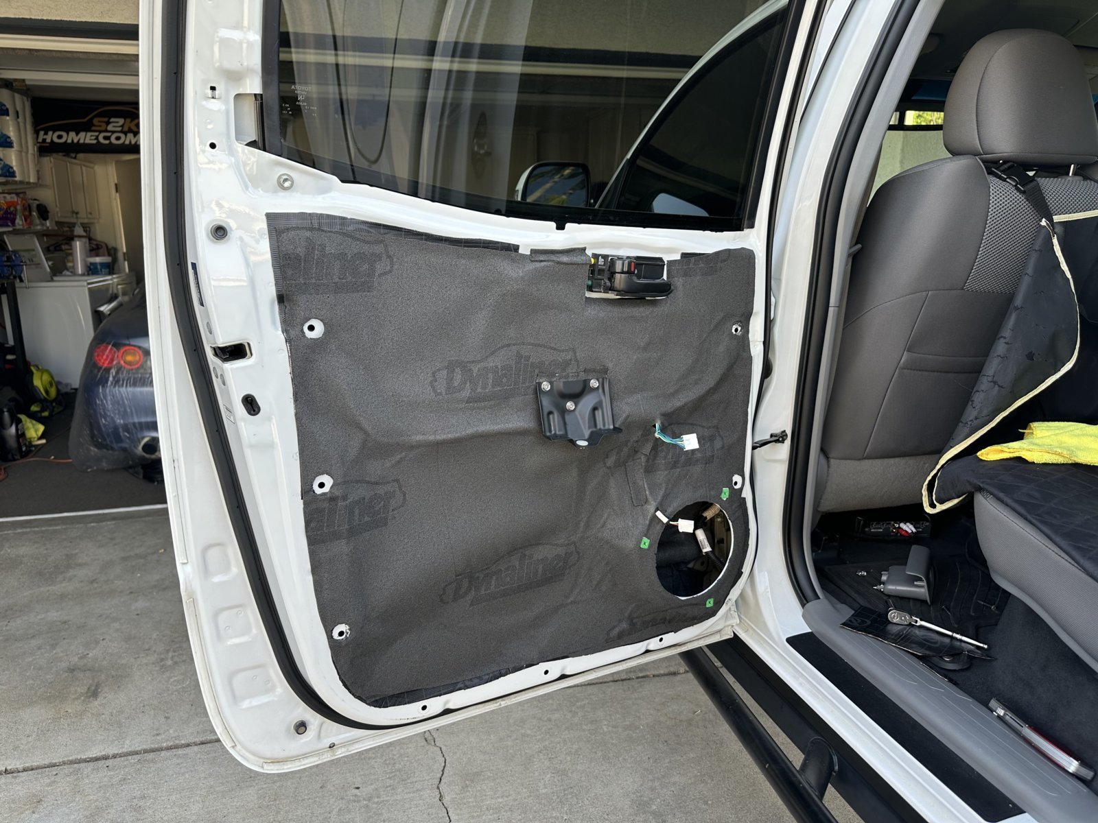

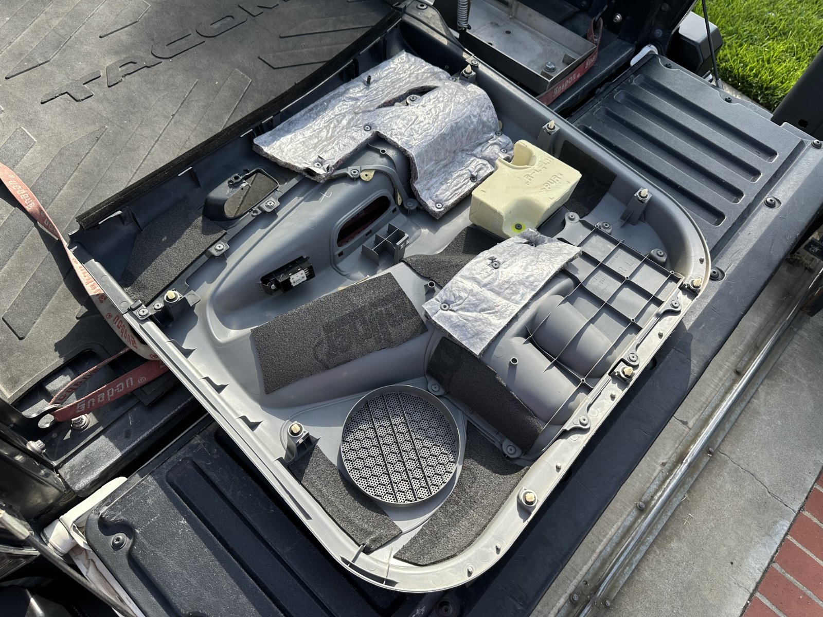

    Still working on the full Youtube video for the door sound deadening, but here are some progress pics of the rear door.
    Pieces on the floor are copies of what I put in the driver rear door skin for the passenger side.
    Butyl rope in between door bars
    Door skin covered with dynaliner
    Final dynaliner layer
    Door panel treated with a few bits of dynaliner
    One down, three to go
