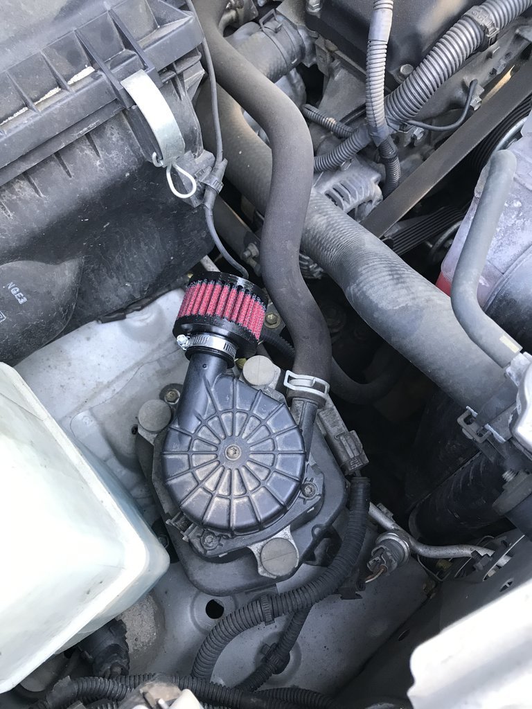

    Love the truck! I've been having some trouble finding how to do the uni air pump filter mod. Any links to a step by step?

    Thanks @ConnorO, you basically pop off the cover and remove the torx screw in the center, pry the upper half off and remove the factory foam filter. Put the upper half back on and take off the cap where the uni filter needs to go, then slide on the uni filter and tighten it down :thumbsup:

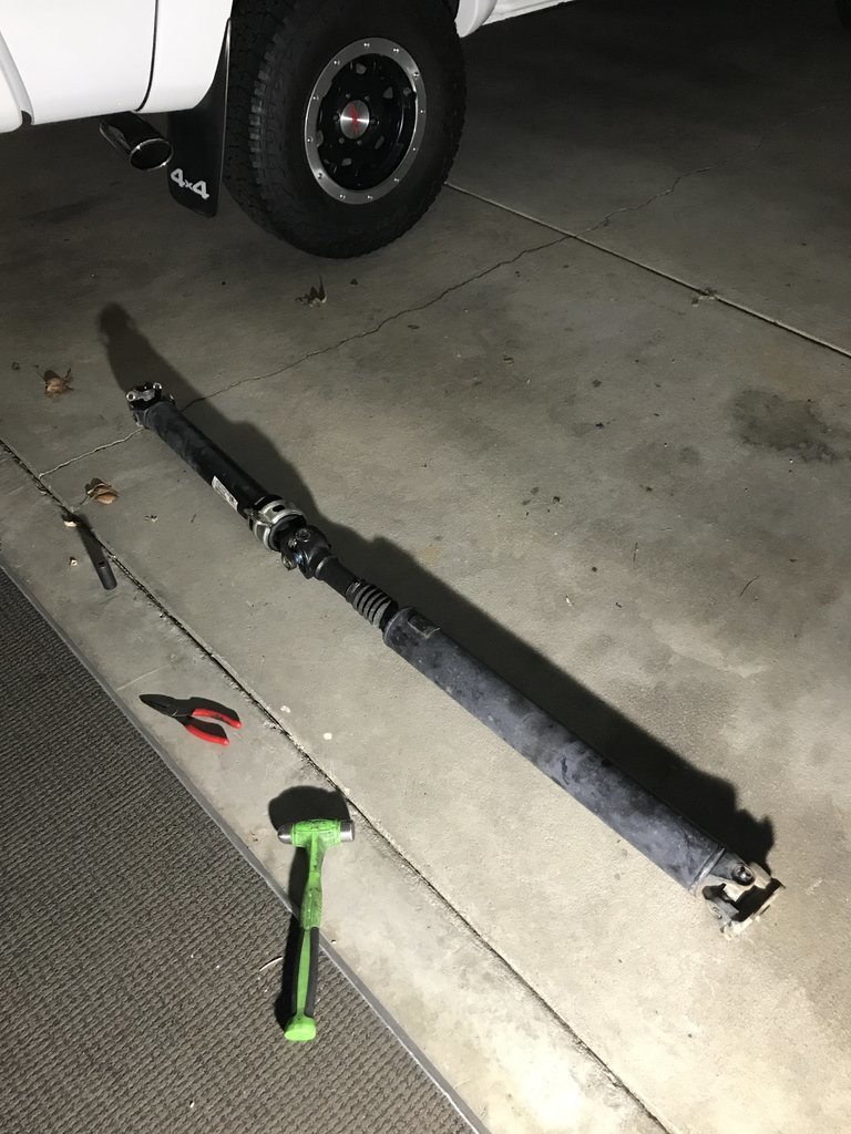

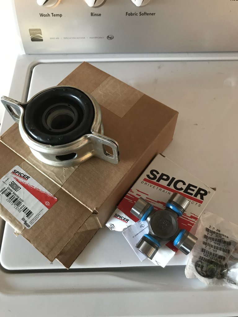

    Cut out the middle man and called Dana with the part number off the sticker on my driveshaft. Got the part numbers for the carrier bearing and u-joint. Trying to get the truck 100% before Trail Rehab in Calico next weekend

    Probably the hardest thing I've changed on the truck to date. Fixed 99% of the vibration, going to change the front and rear U-joints next!

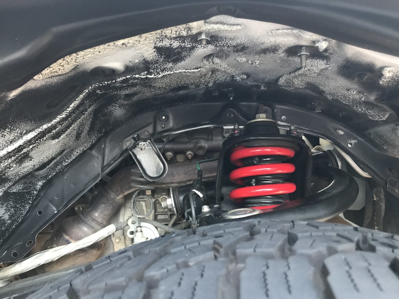

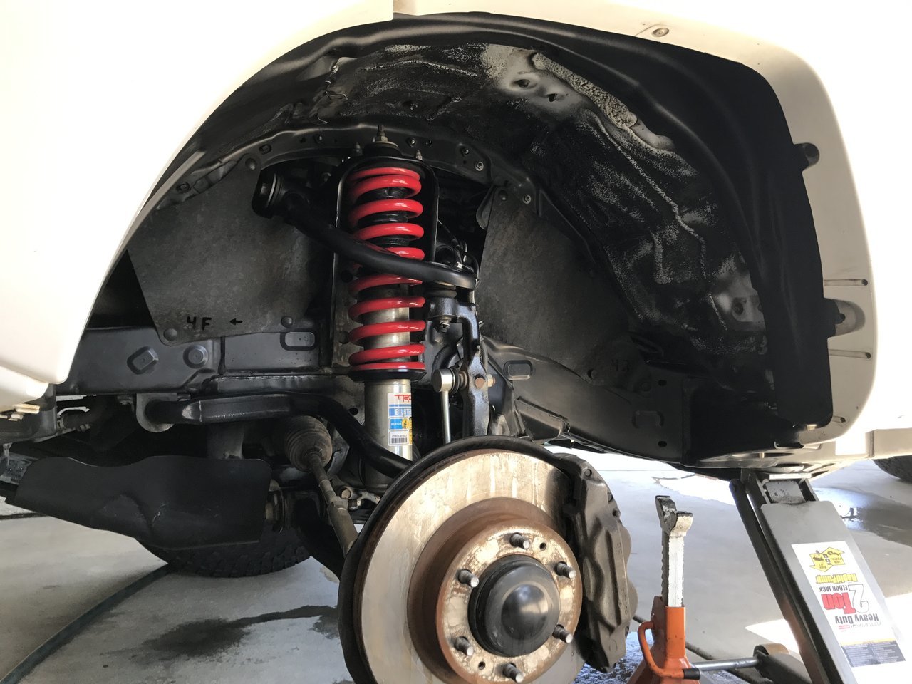

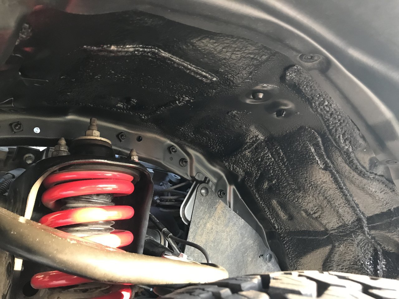

    After cleaning the wheel wells the other day a bunch of white started showing beaneath the black. Cleaned it all again and laid down a coat of black

    Got it thanks! Only thing that was odd was that my truck doesn't have the plastic cover but I'm not going to sweat it

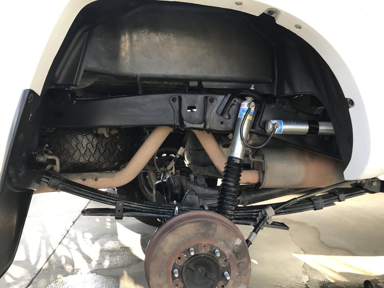

    Thank you! It should be on in a week our two and yes there will be a progressive add-a-leaf along with the kit:)

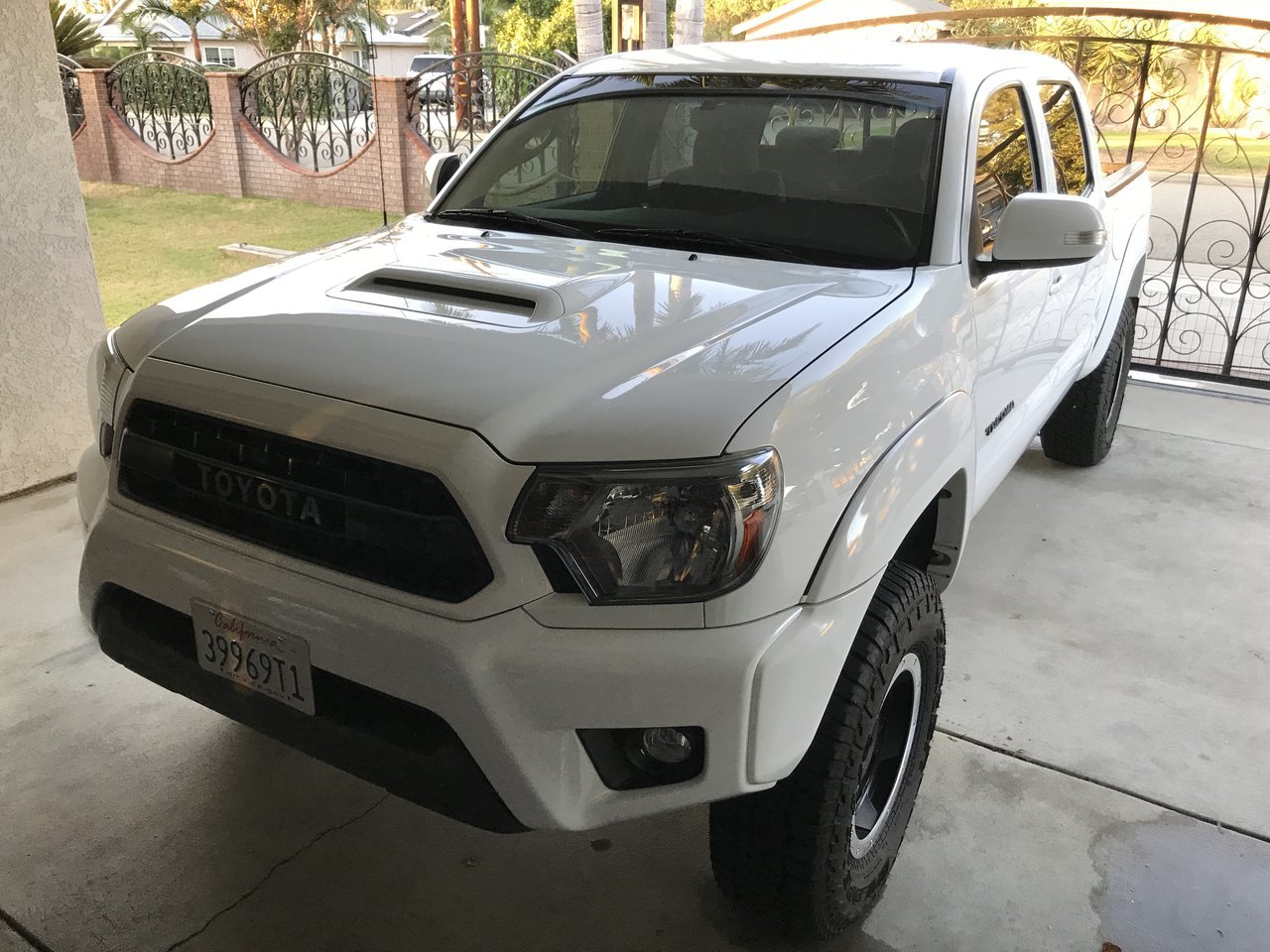

    Had a blast in calico with everyone for Toyota Fest Trail Rehab Days! Just waiting for my sliders and new lift to do some harder trails, but the truck did great.
    IMG_3278.jpg IMG_3220.jpg IMG_3231.jpg IMG_3253.jpg IMG_3250.jpg IMG_3294.jpg
