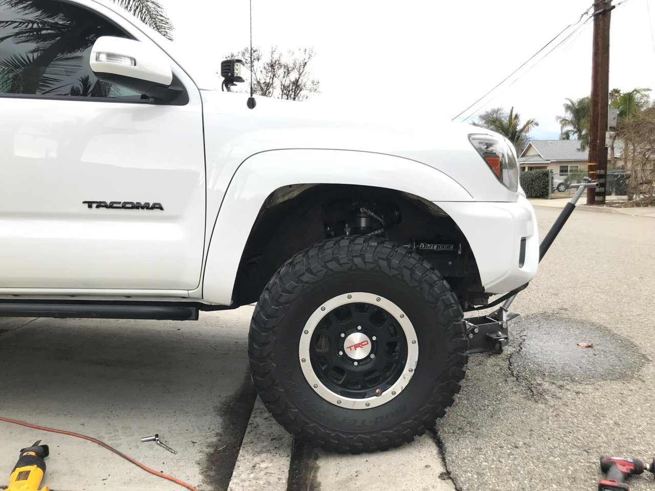

    The KM3’s are awesome! Aired down feels like riding on clouds, still lots of work to do to get them to fit properly. I stuffed the front tire all the way and couldn’t turn at all or the flare would have ripped off. Time to take the flares off and cut :sawzall:

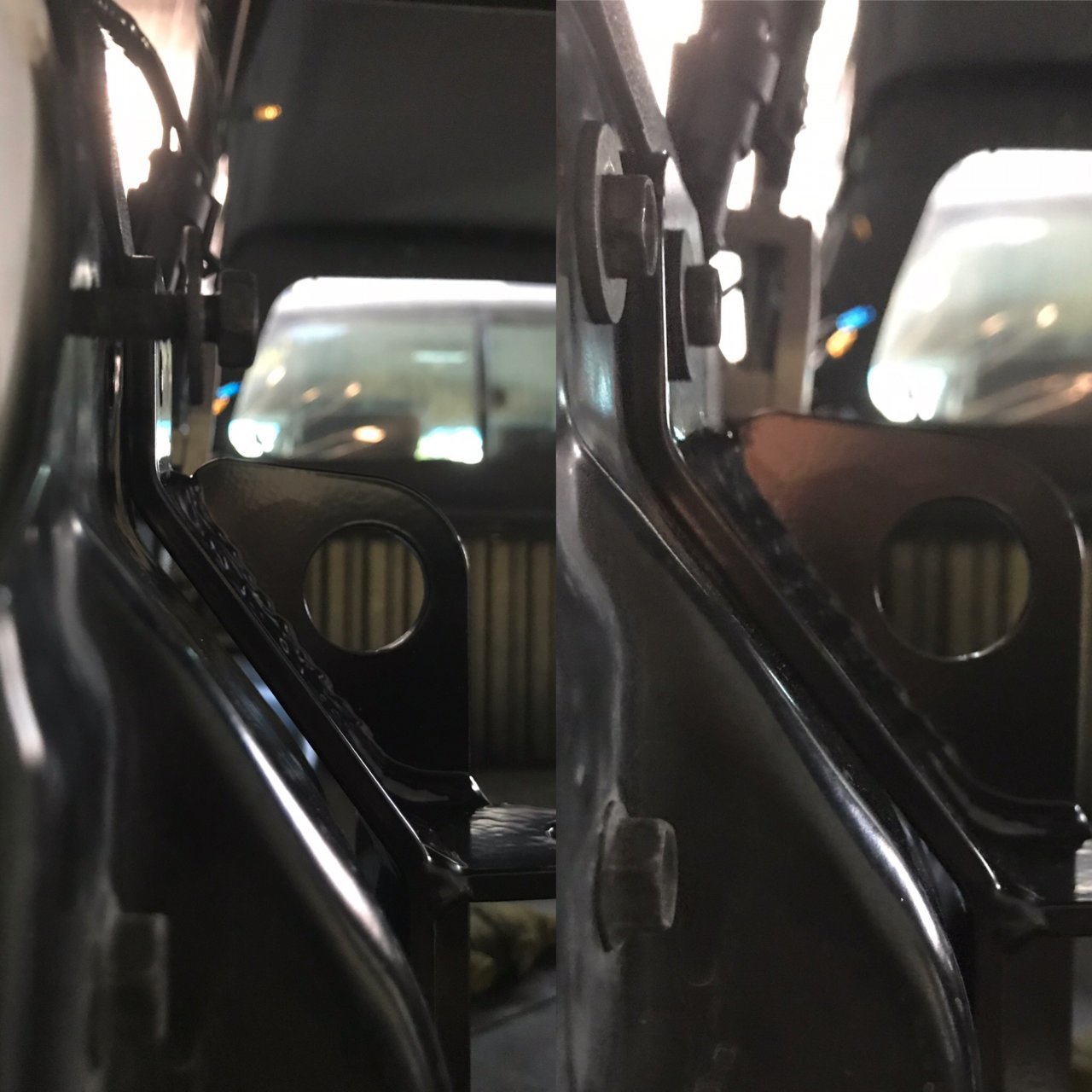

    Got some bed stiffeners for Xmas. Found the driver side of the bed was off pretty good compared to the passenger side. I love the new strap locations on the brackets, good quick mod!

    Thank you @rjbiii they look amazing compared to the old set of tires lol. I still need to get around to cutting about a 1" radius front and rear on the fenders/bedsides. I don't rub at all on the streets, but I can't move the steering wheel left or right when they are stuffed.

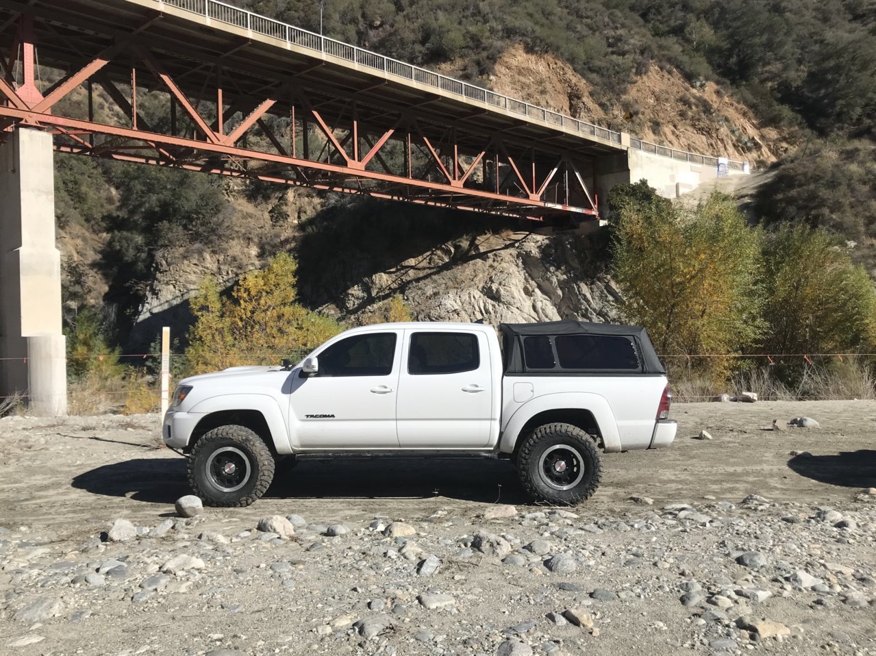

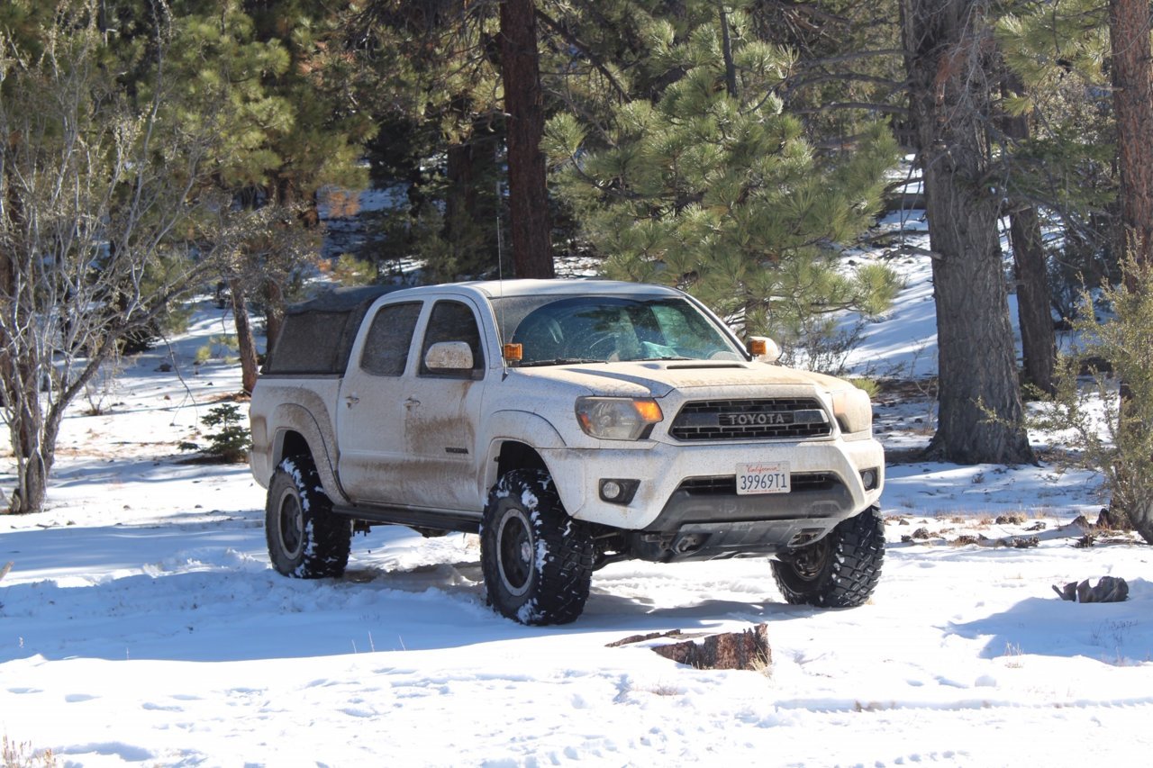

    Went up to Big Bear for New Years and had some fun on Gold Fever Trail. Still need to cut the damn flares so I can hit some real trails again. I'm the worst procrastinator lol.

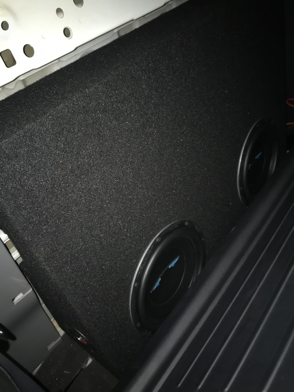

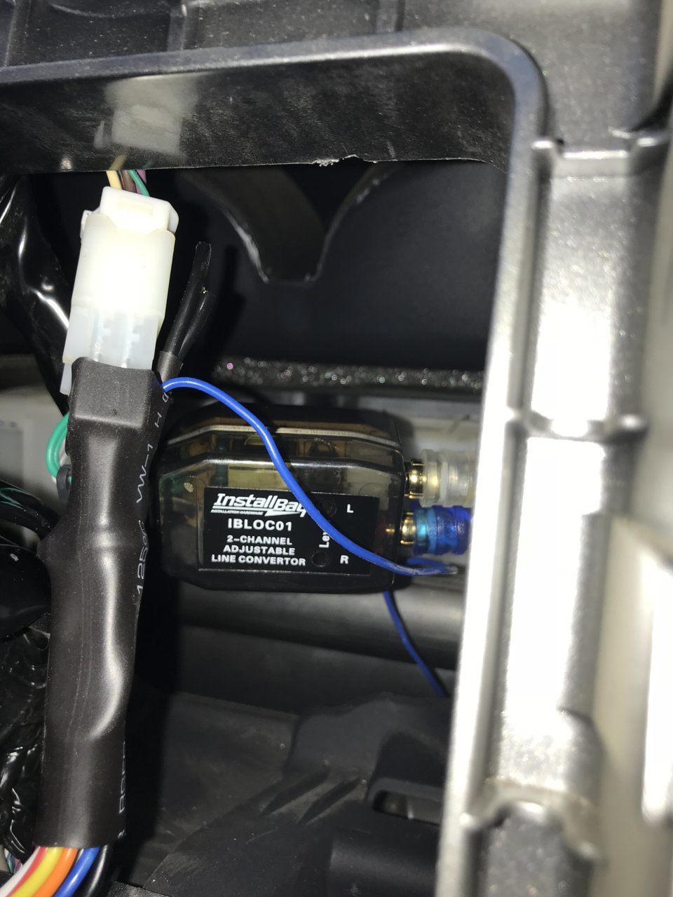

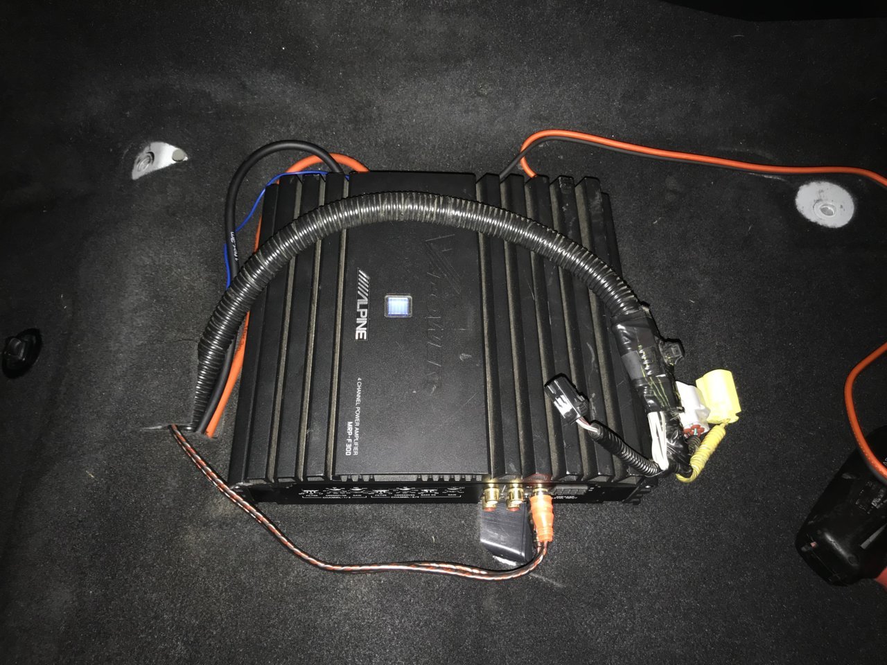

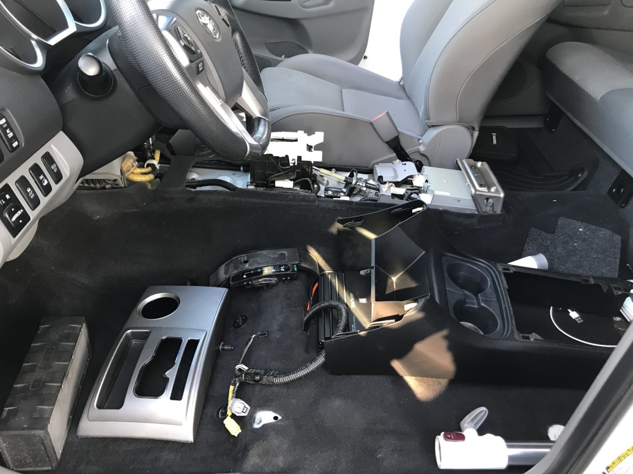

    Spent the better half of Sunday afternoon wiring in my sound system. Went with an alpine amp under the driver seat, and a custom box with two 8” image dynamics subs. Bought a plug and play harness off eBay for the rca jacks to the oem headunit, and installed a bass control knob in the center console! It sounds great for now, eventually I will get some good door speakers and wire those into the amp.

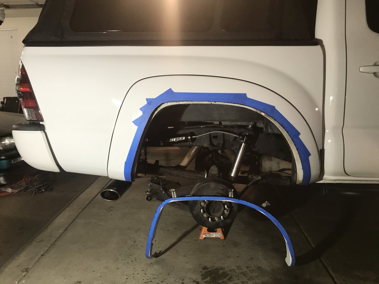

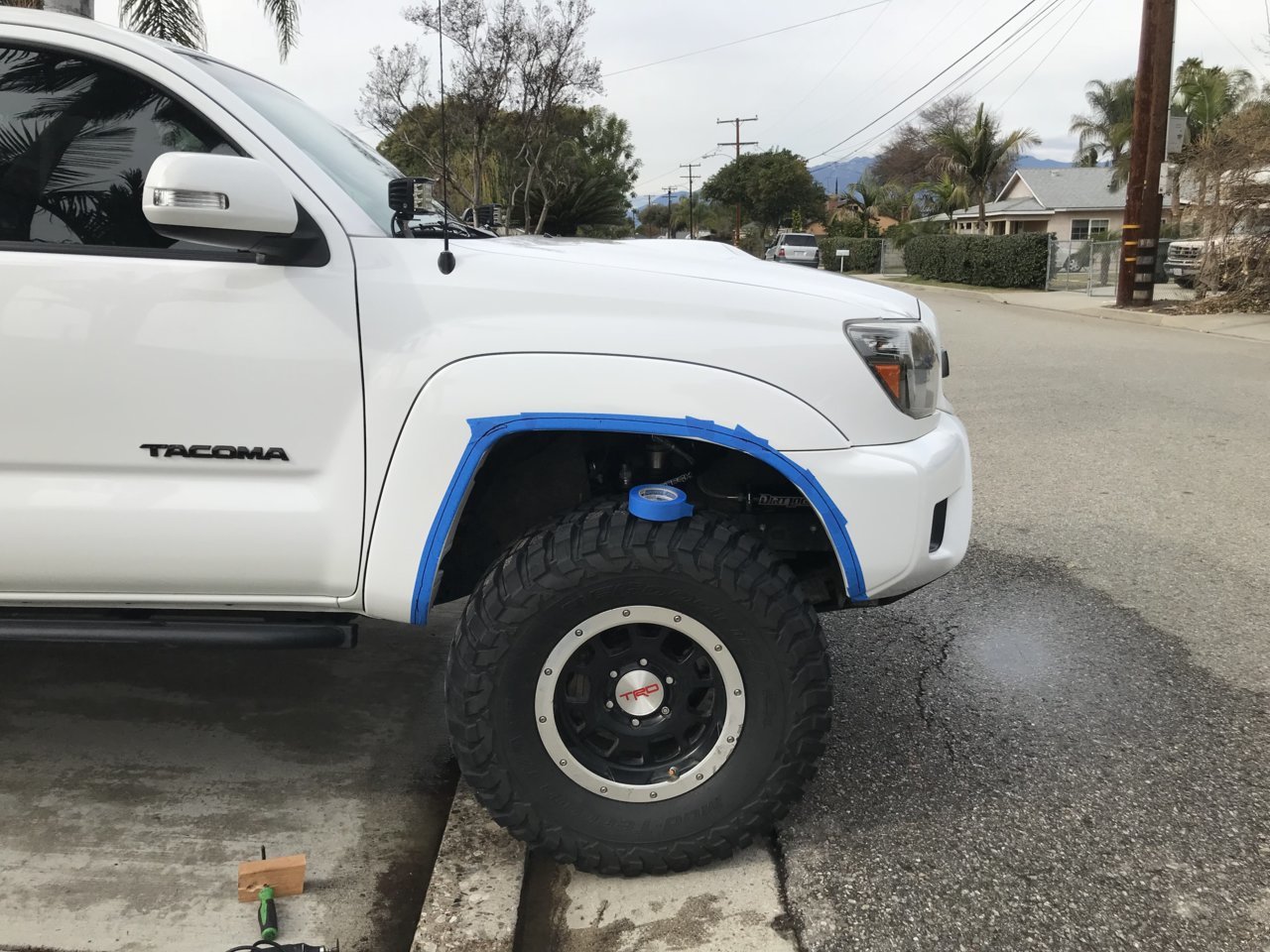

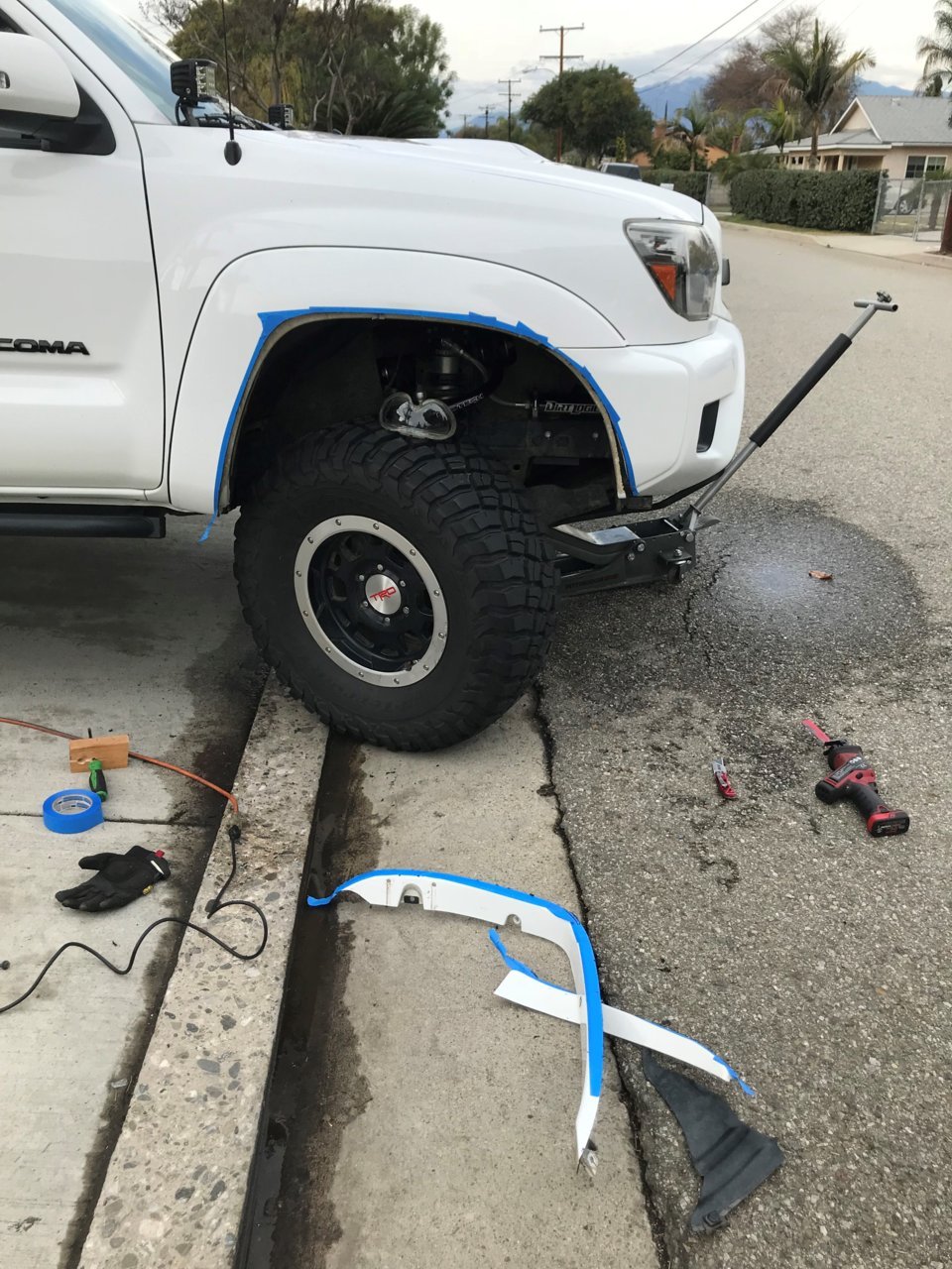

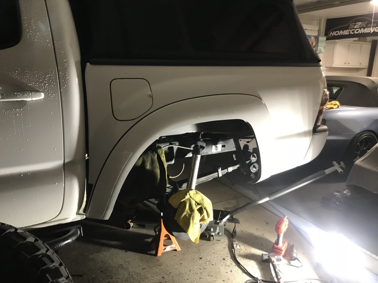

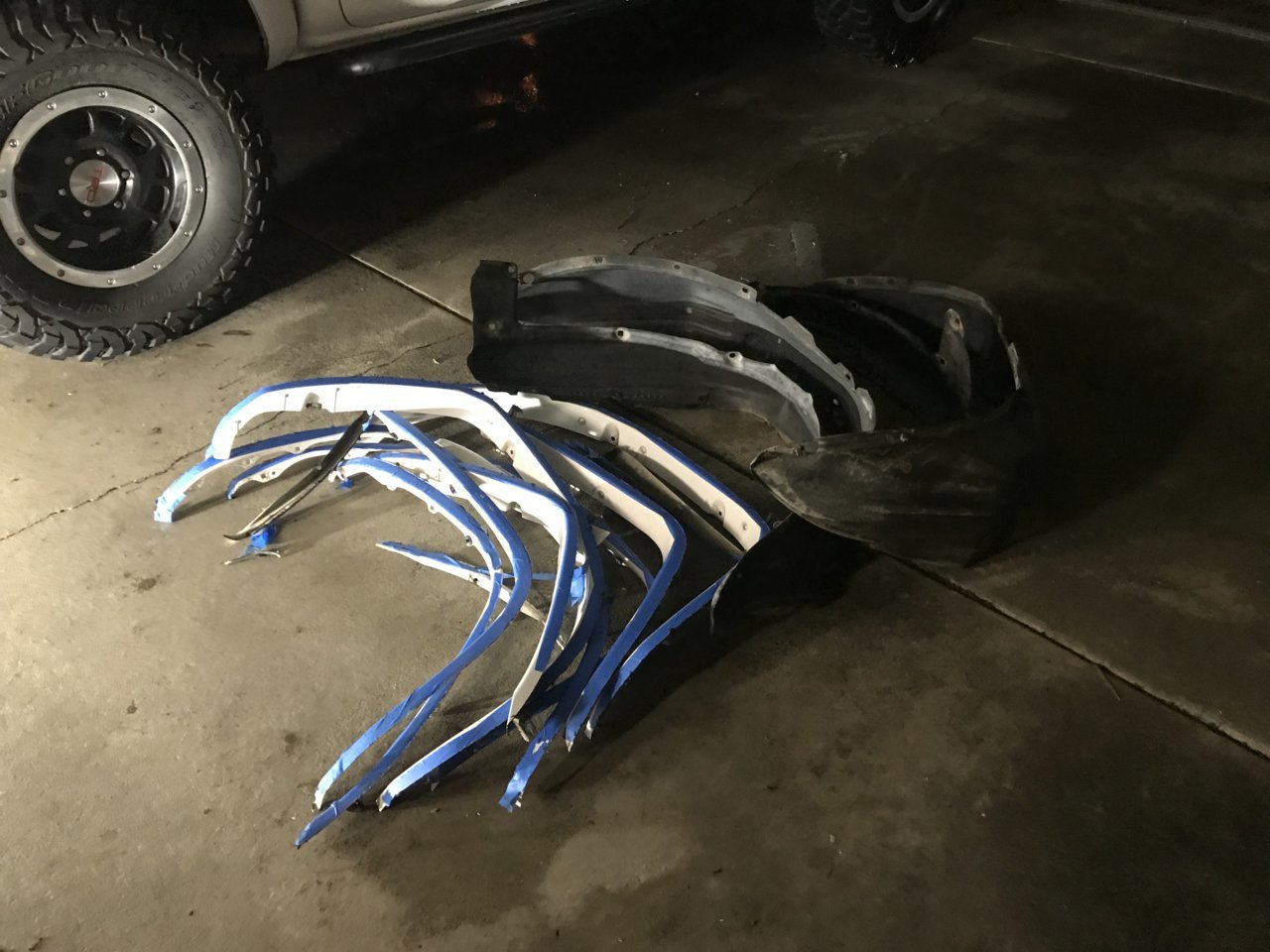

    I went all in this weekend. Cut 1" off the flares, removed flares, cut 1" off the fenders. Scary as hell but the outcome was totally worth it!

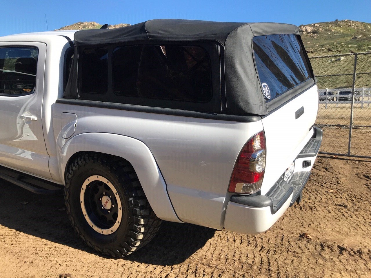

    Front and rear are officially complete!

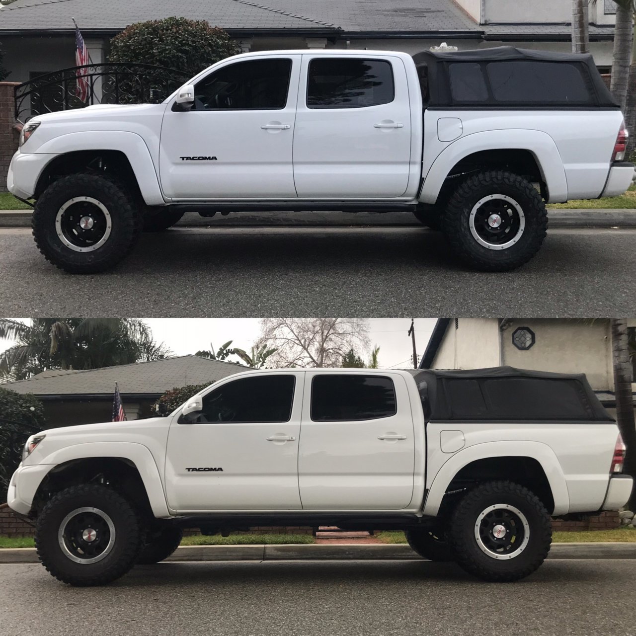

    Before and after comparison

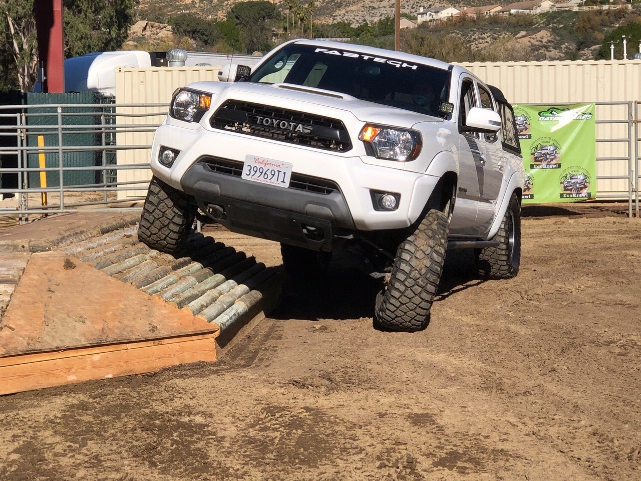

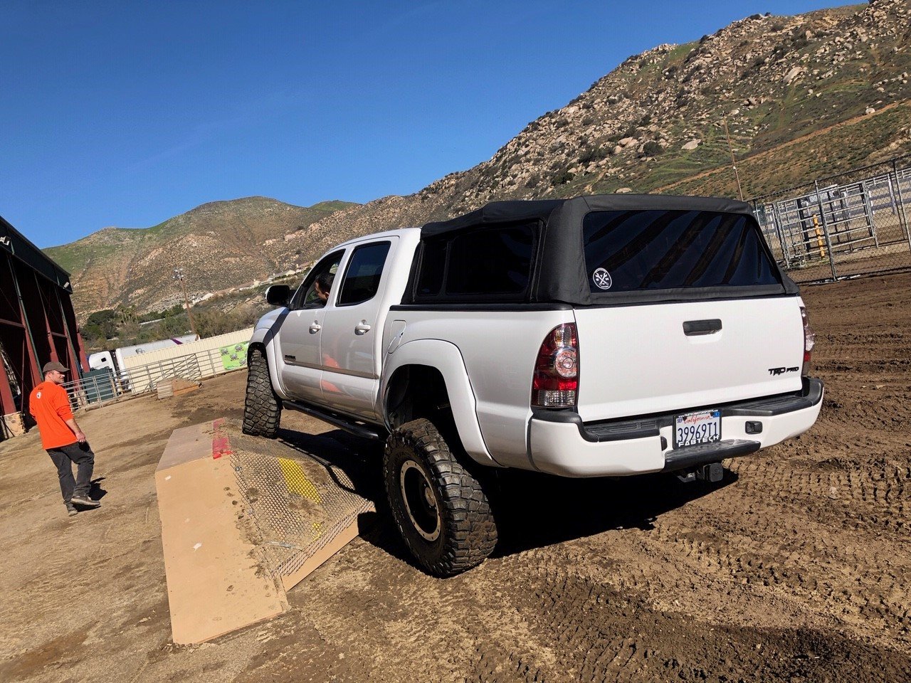

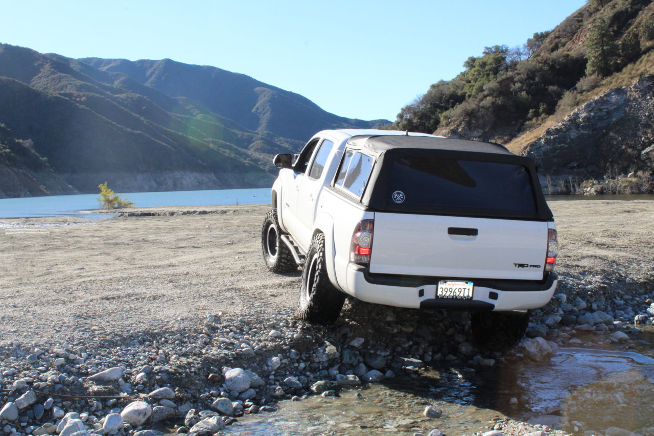

    Not bad for stock shackle setup in the rear. I got up to the red line on another try, but the rear tire lifted about a foot from the ground. I plan on getting some spring hangers and longer shocks next...
