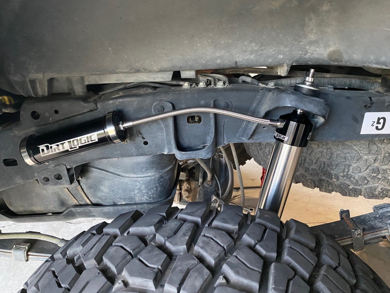

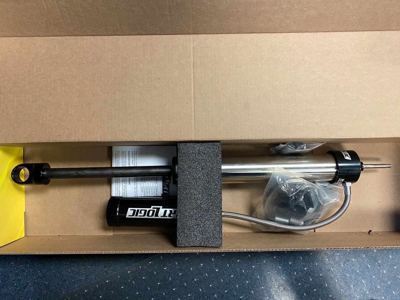

    Longer shocks are in! They are 27.3" extended / 16.9" collapsed. Cant wait to get these on and gain full use of my @ARCHIVE hammer hangers

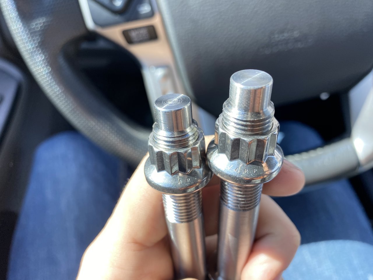

    Rear ARP 12 point upper shock stem nuts!

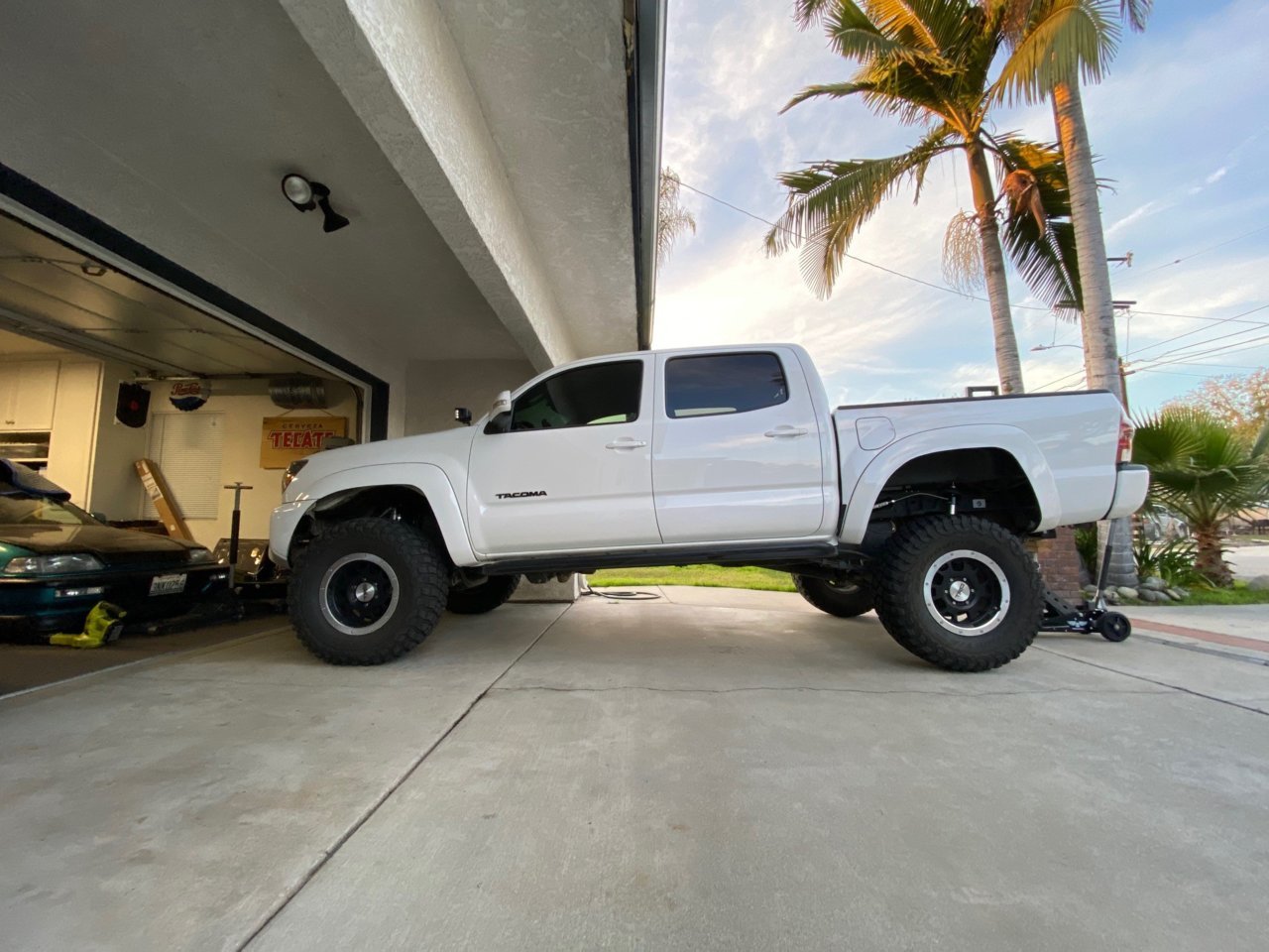

    Here she is drooped out as much as the stock leaf springs allow (they are pretty flat, and limit droop). The shocks have about another 1.5" of downtravel that I'm sure I will see on the trail when its flexed out! I also opted for an ARP 12pt nut to top off the install :cool:

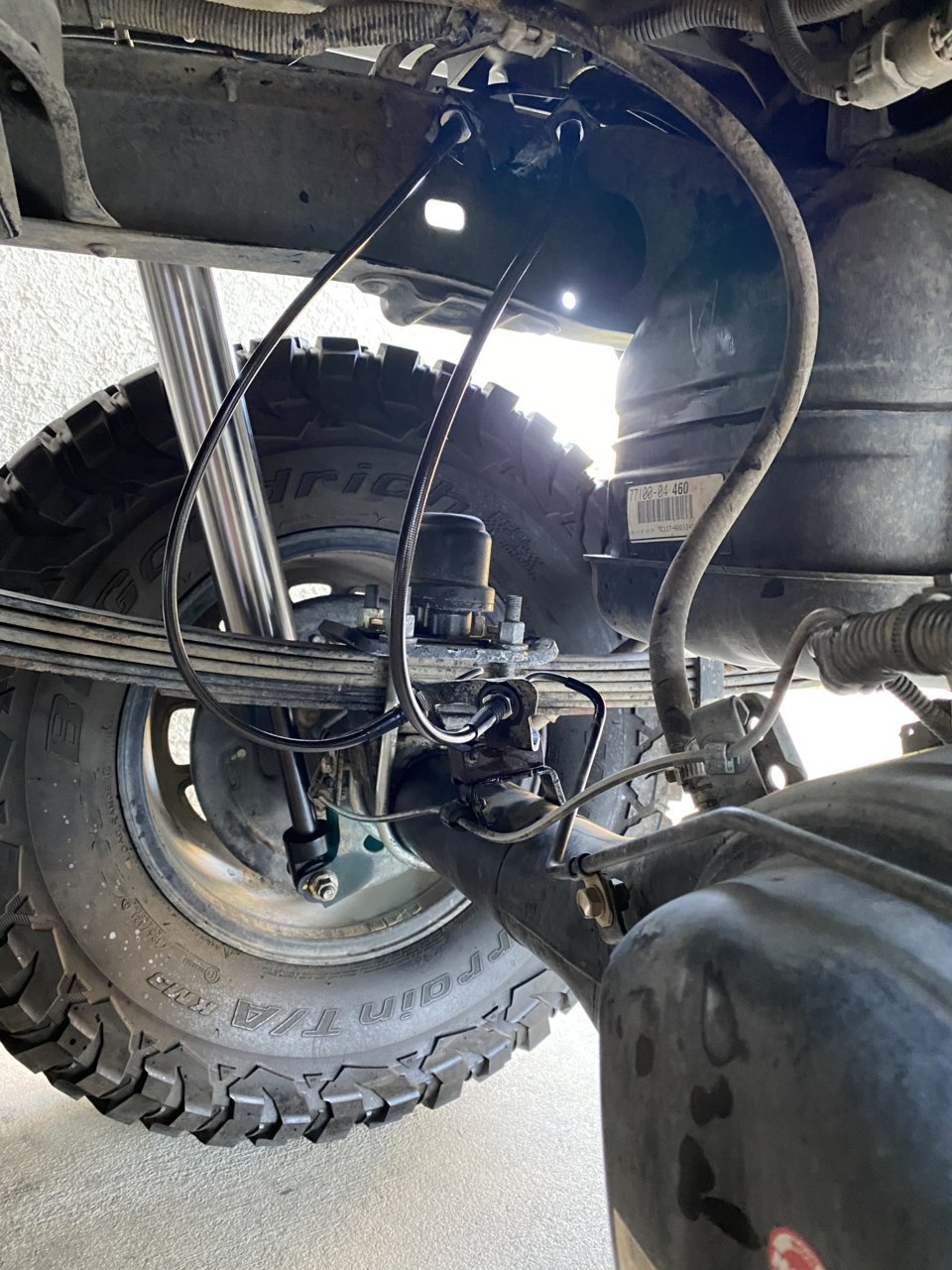

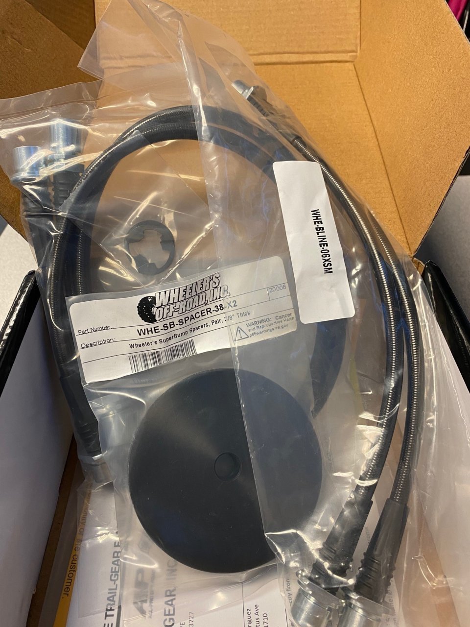

    @Wheeler's Off-Road Inc Front brake lines, rear +4 brake lines, and 3/8 superbump spacer. Rear will be complete as soon as I get these on!

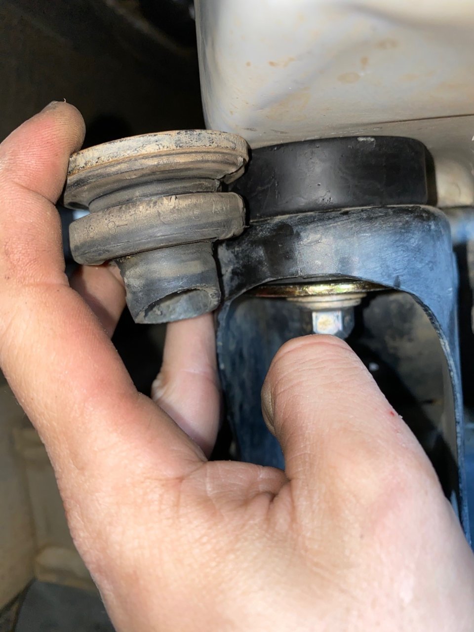

    Radiator support bushings replaced!

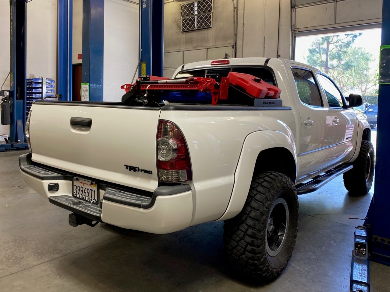

    We just wrapped up a new Cargo Rack at work. I get to keep the prototype since they used my truck to base the rack on and take pictures for the catalog.

    Lookin' good as always! How was the radiator support bushing install? I've been thinking I need to do this but not sure if it's a simple home garage kinda task.
  20. Mar 17, 2020 at 7:38 AM
    #220
    greenEFSI
    greenEFSI [OP] TacoSupreme____
    Jun 29, 2016
    #190830
    1,564
    Gio
    West Covina, SoCal
    '15 TRD Pro Super White
    The rad support bushing is really easy, but you definitely need a jack and decent sized 2x4 to get it done.
