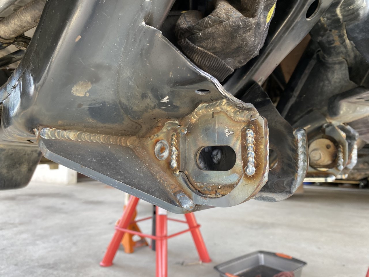

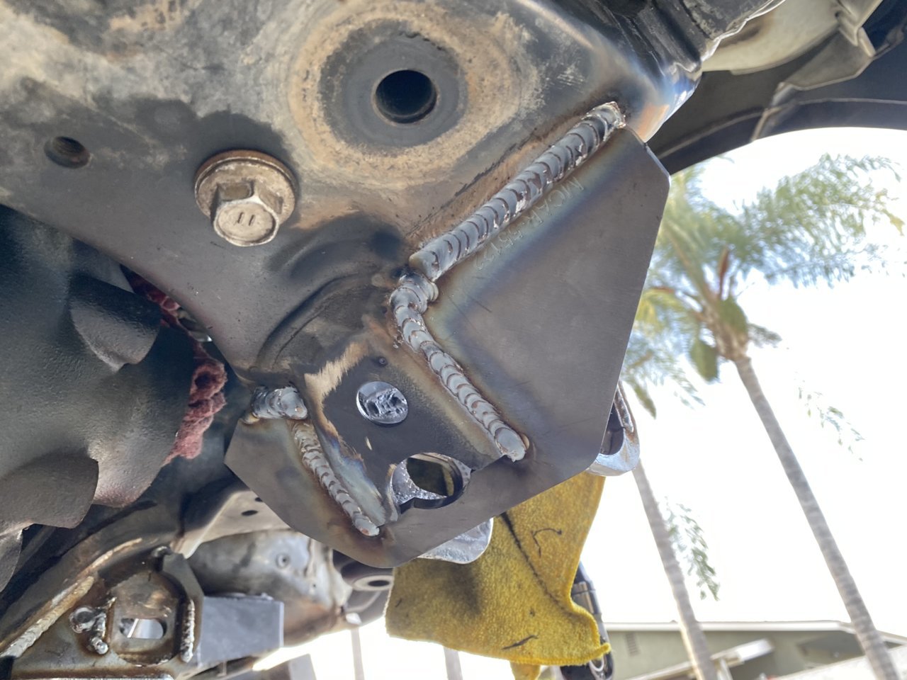

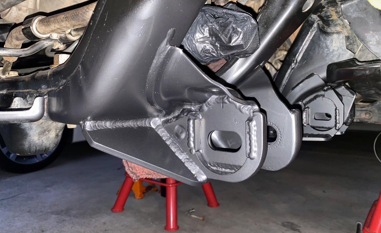

    TIG’d custom lca reinforcements

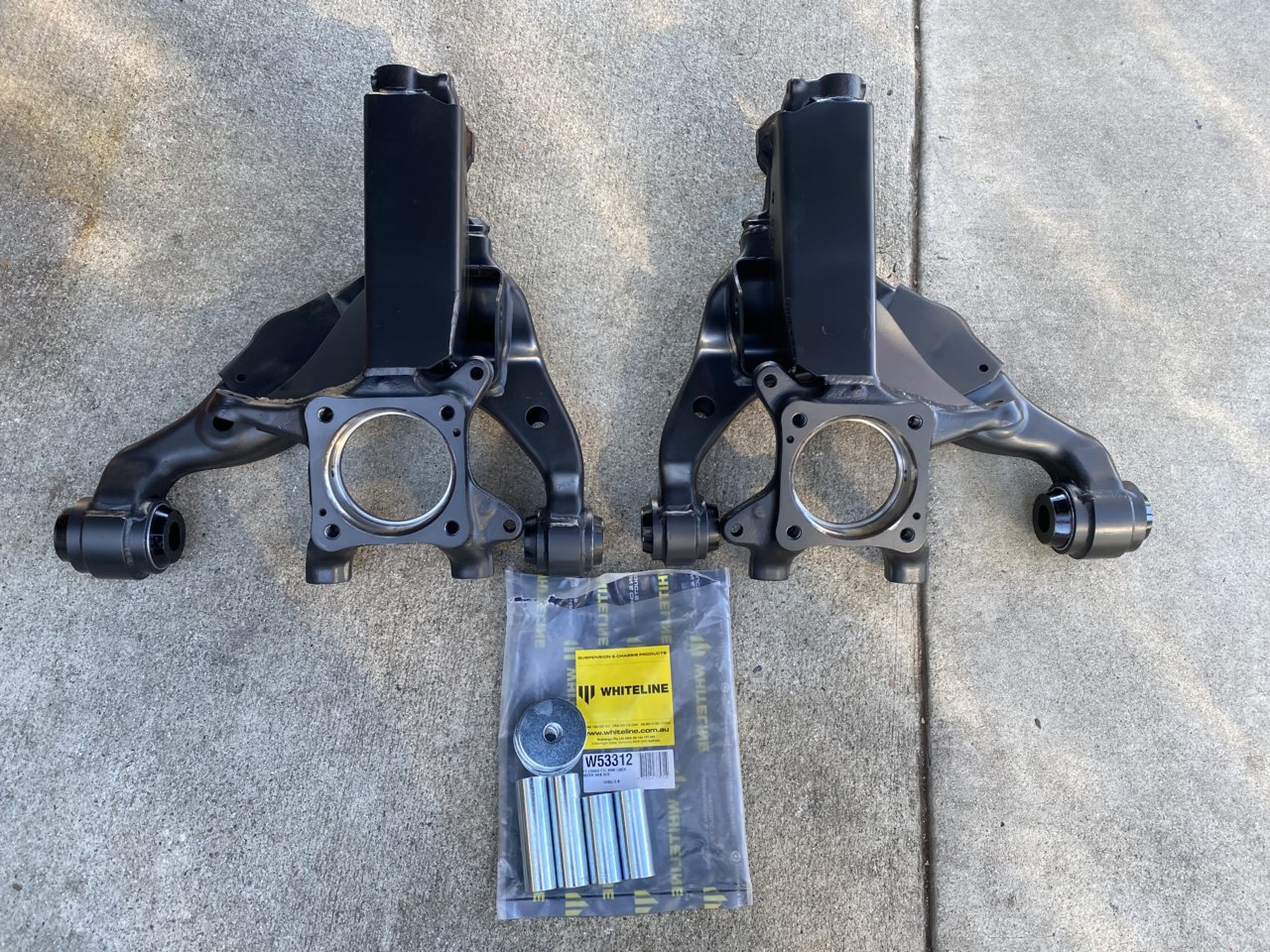

  2. Jan 1, 2021 at 12:11 PM
    #262
    greenEFSI
    greenEFSI [OP] TacoSupreme____
    Jun 29, 2016
    #190830
    1,560
    Gio
    West Covina, SoCal
    '15 TRD Pro Super White

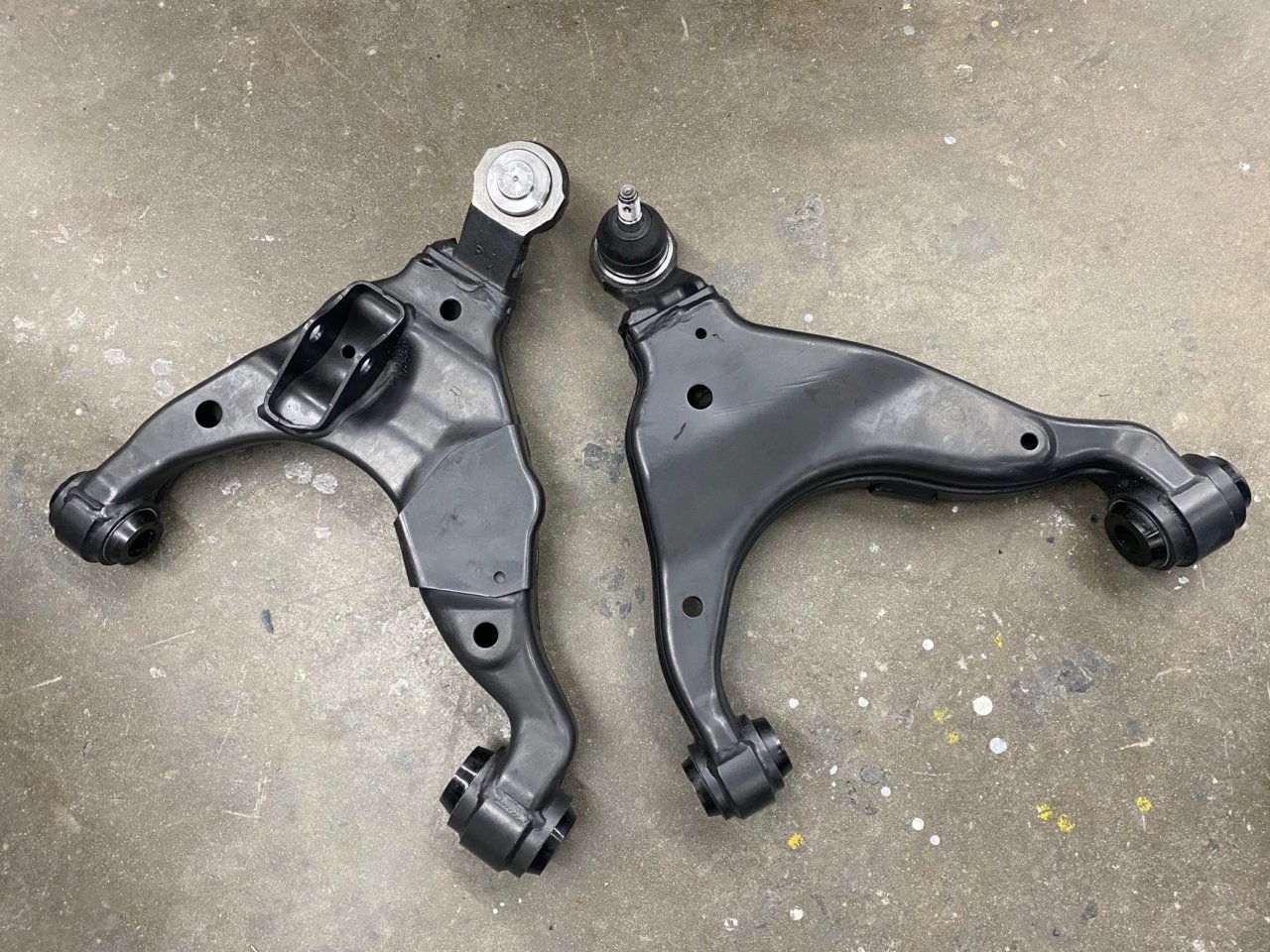

    Spindles & lca’s prepped and painted with steelit. Whiteline lca bushings pressed in!

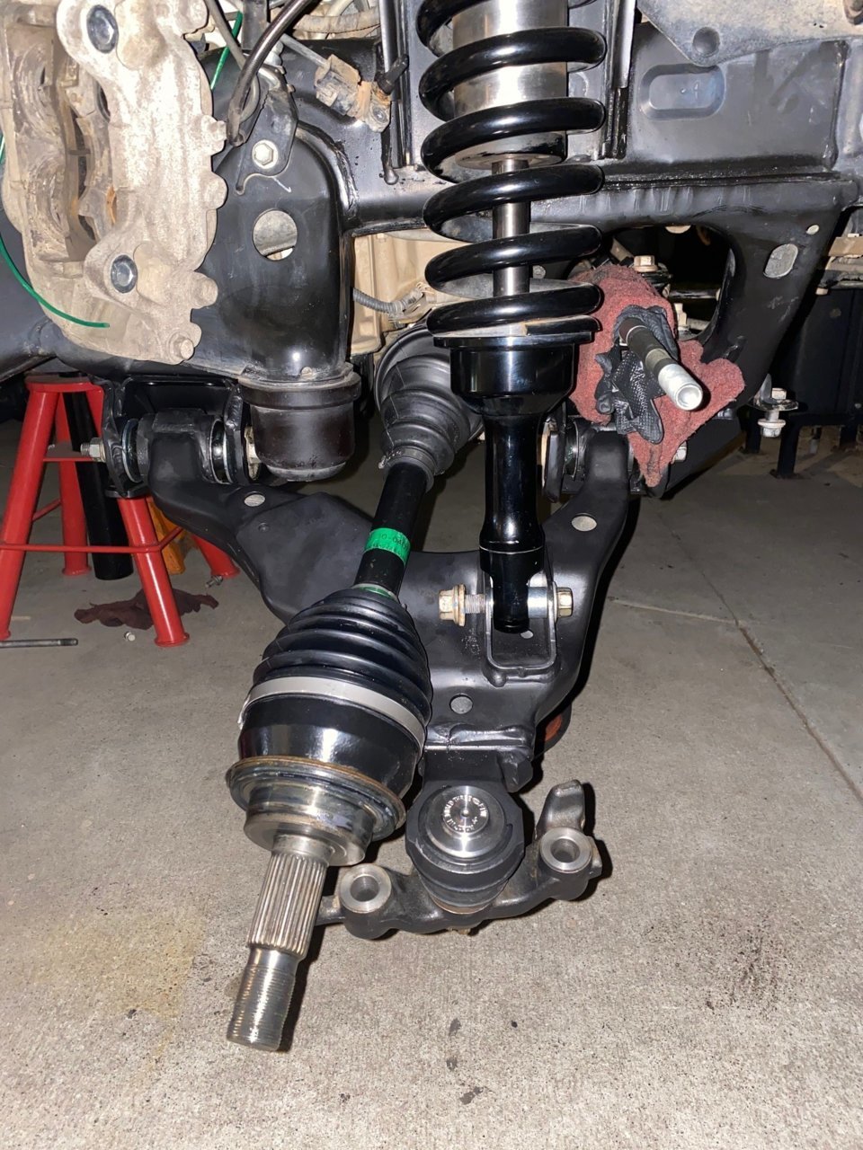

  5. Jan 13, 2021 at 7:33 AM
    #265
    greenEFSI
    Jun 29, 2016
    #190830
    1,560
    Gio
    West Covina, SoCal

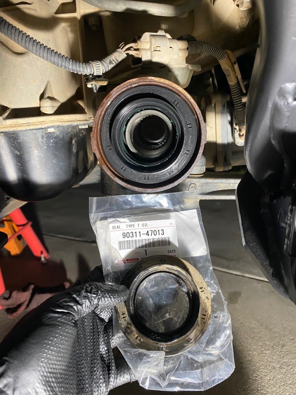

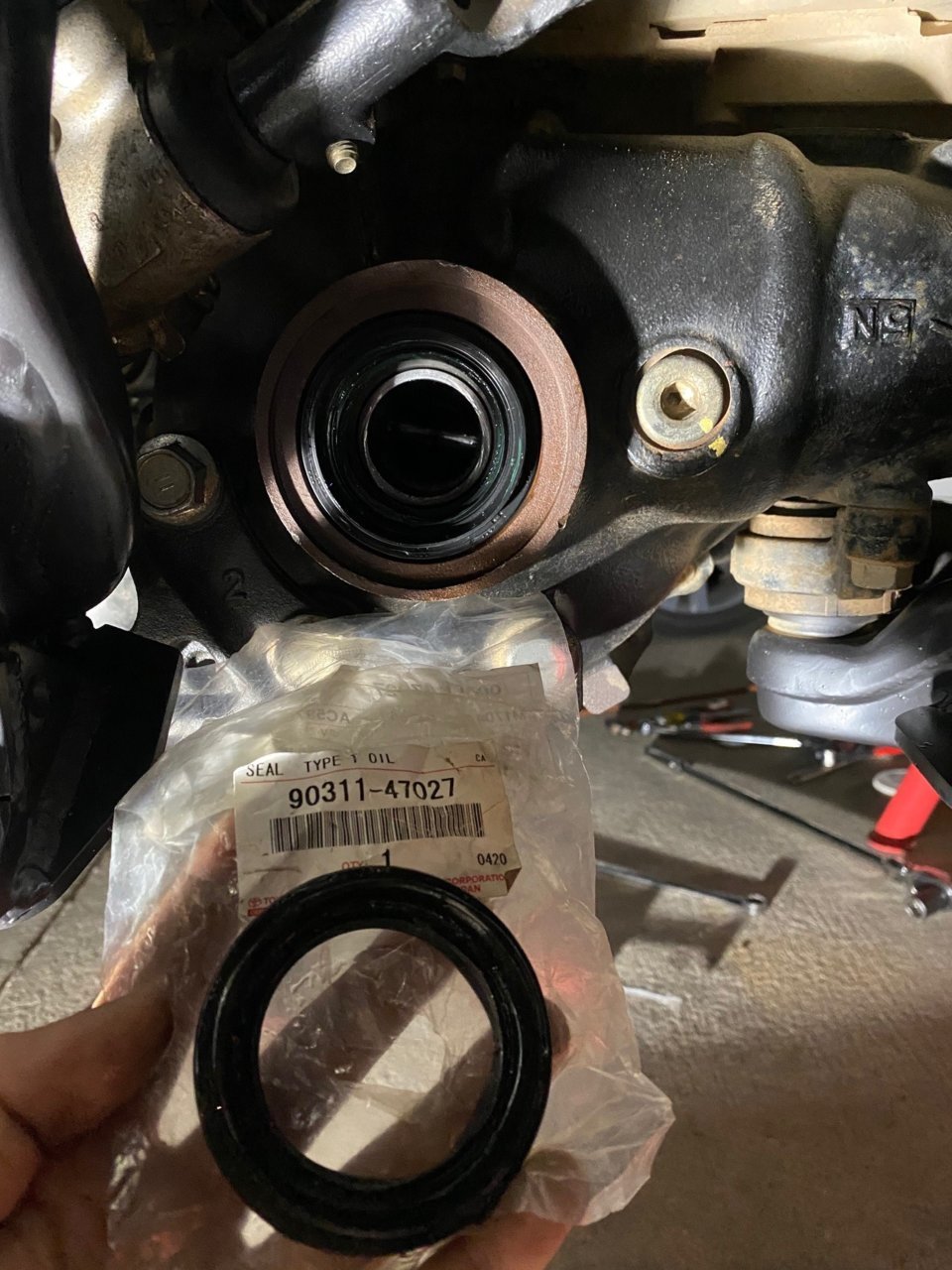

    I made some great progress the last few days! New Sankei 555 ball joints pressed into the lca's, new axle seals installed on the front diff, and installed the lca's and axles onto the truck. Hopefully I only have a few more late nights before its back on the ground and ready for an alignment :cool:

  7. Jan 18, 2021 at 8:59 AM
    #267
    greenEFSI
    Jun 29, 2016
    #190830
    1,560
    Gio
    West Covina, SoCal

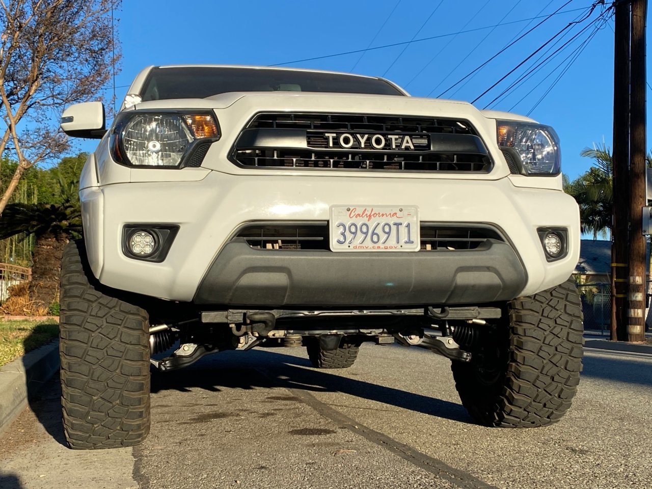

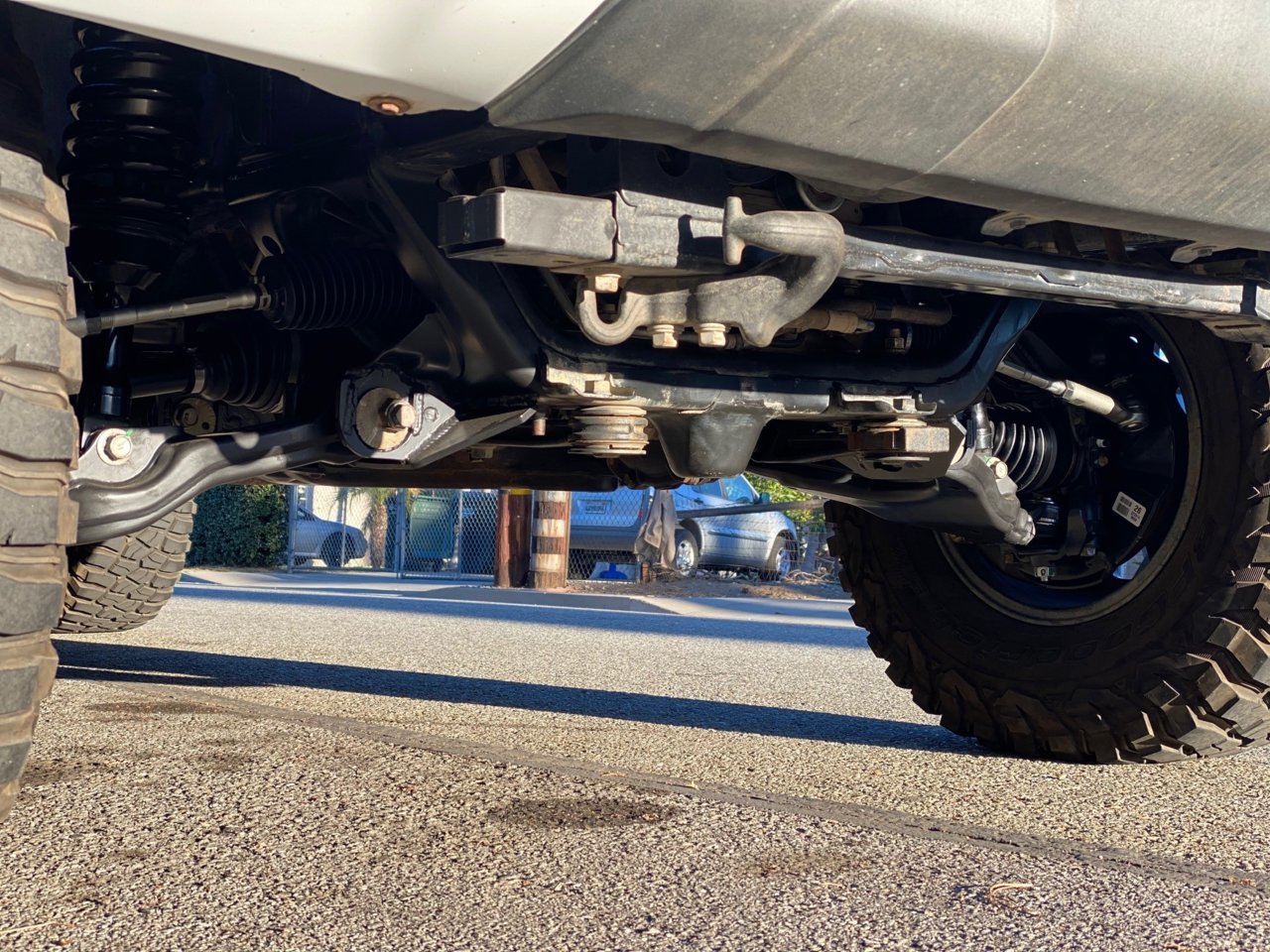

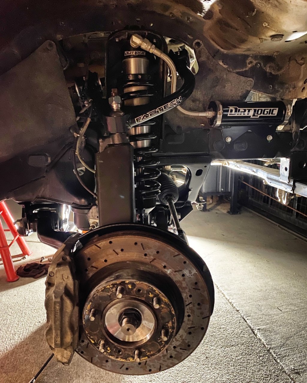

    Lots of hours put into this front end build, and it's almost done. Ready for an alignment and then the skid plates go back on.

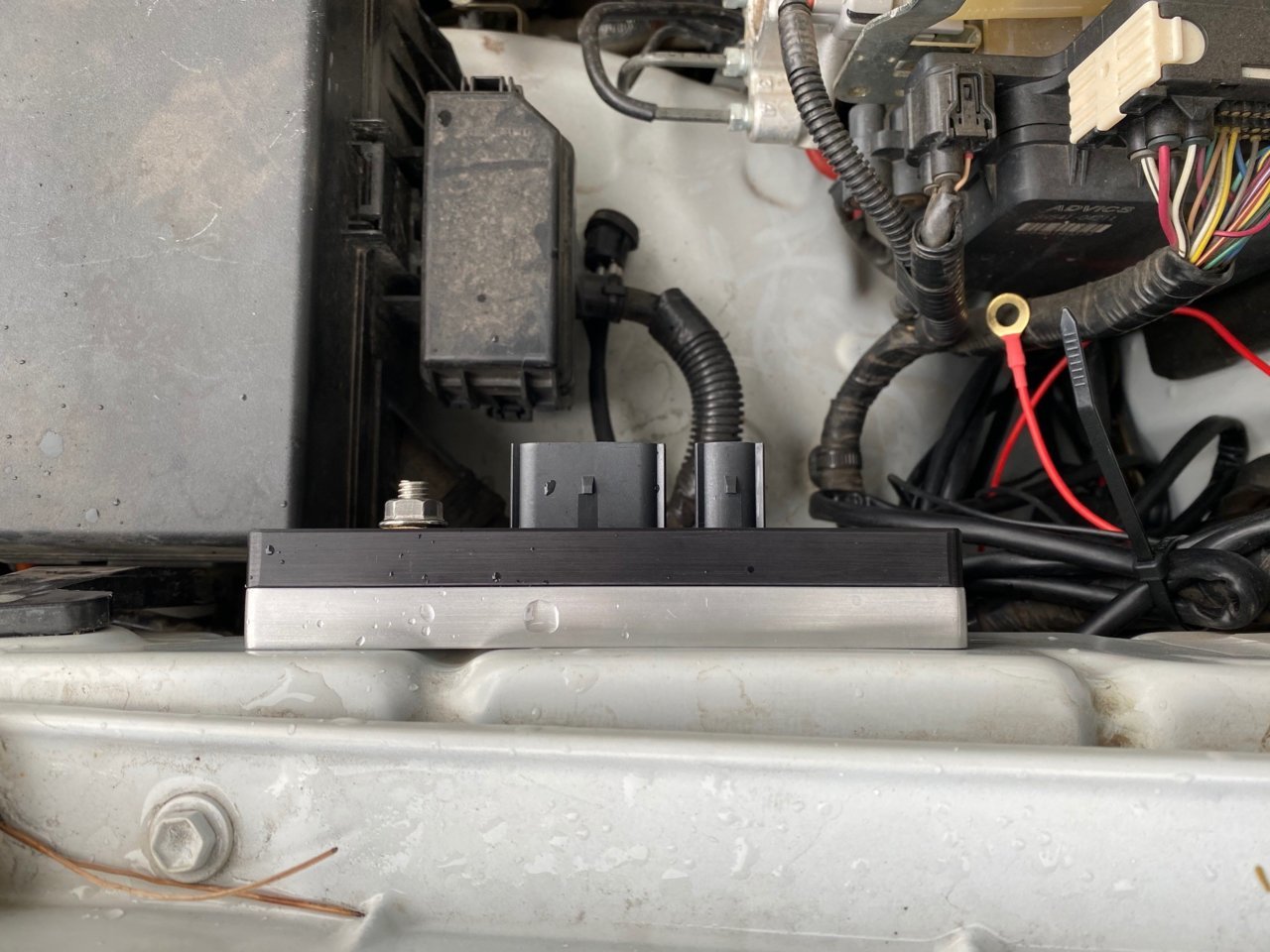

  8. Jan 28, 2021 at 8:04 AM
    #268
    greenEFSI
    Jun 29, 2016
    #190830
    1,560
    Gio
    West Covina, SoCal

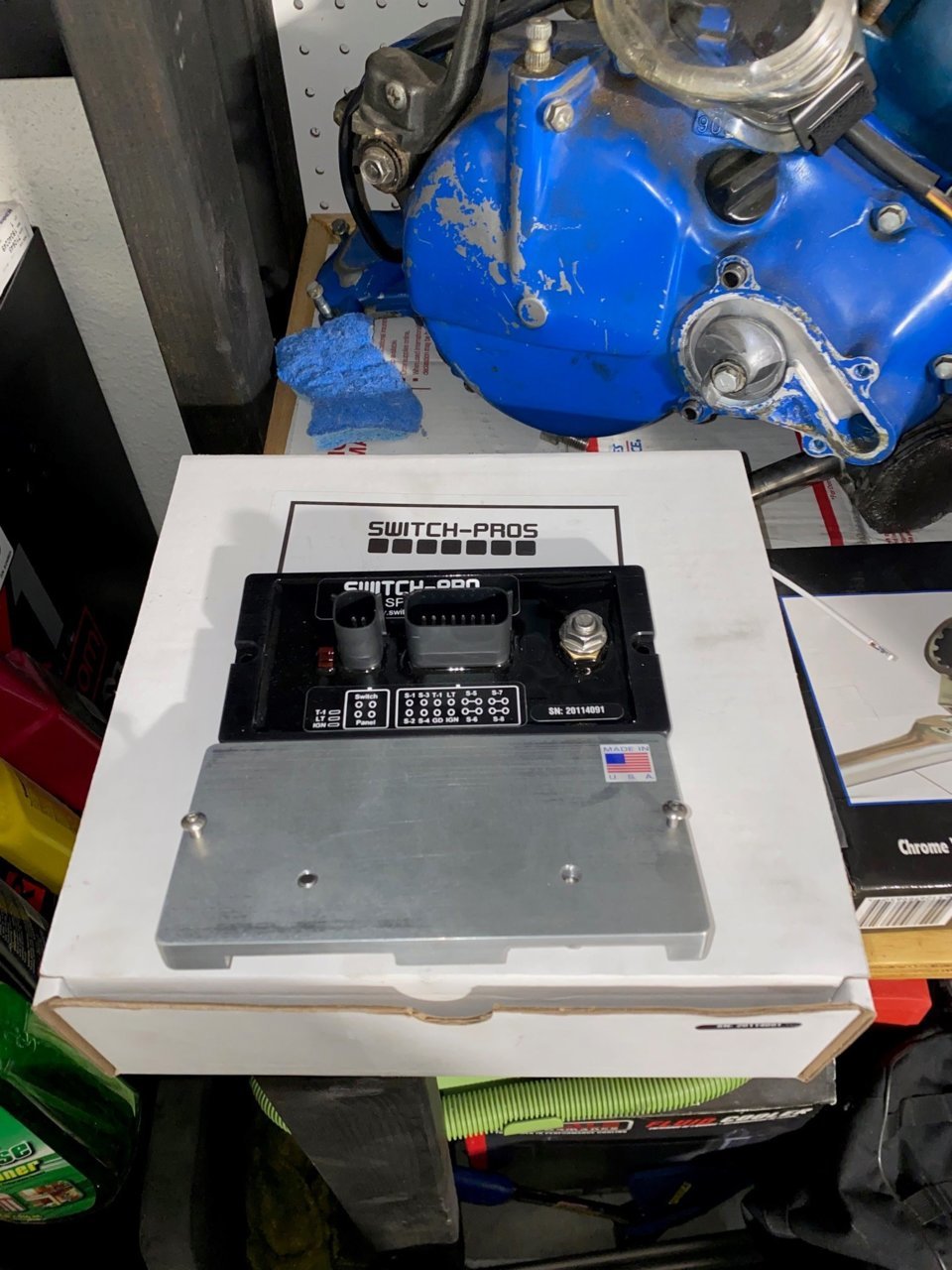

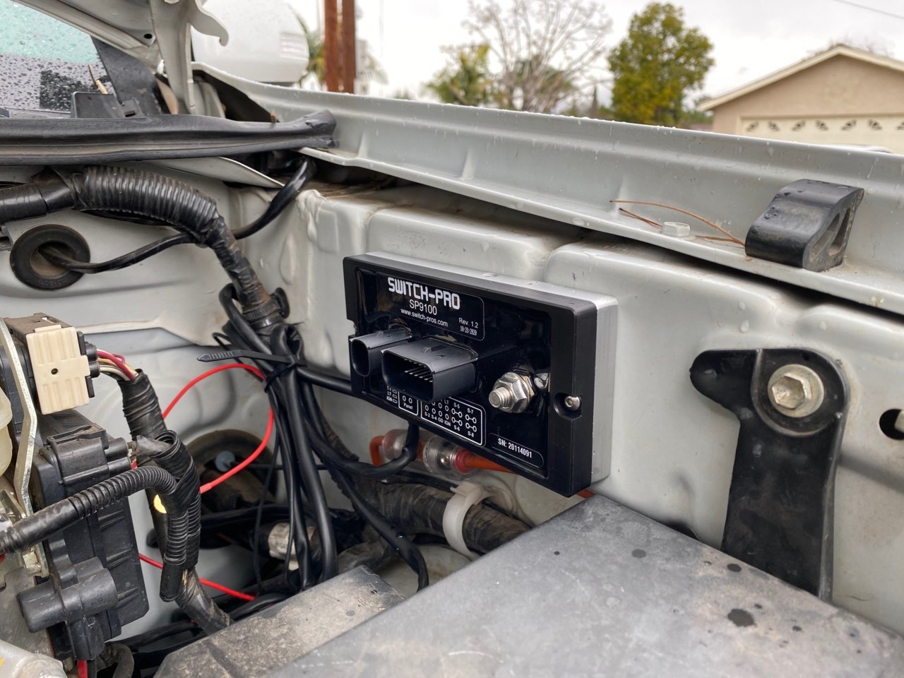

    My buddy has been working on a custom mount for my switch pro :cool: (ignore the ziptied wire, it's the rear squadron flushmount wiring I ran up to the front lol)

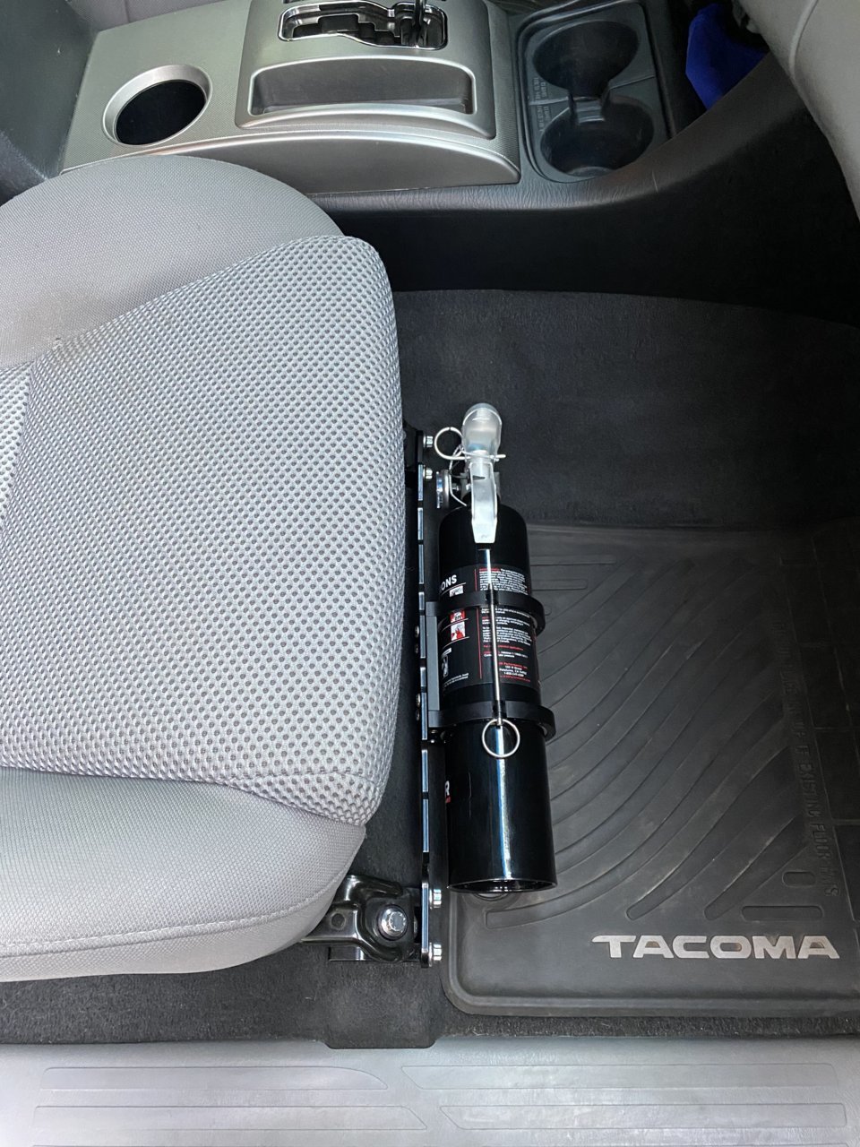

  10. Feb 4, 2021 at 8:59 AM
    #270
    greenEFSI
    Jun 29, 2016
    #190830
    1,560
    Gio
    West Covina, SoCal

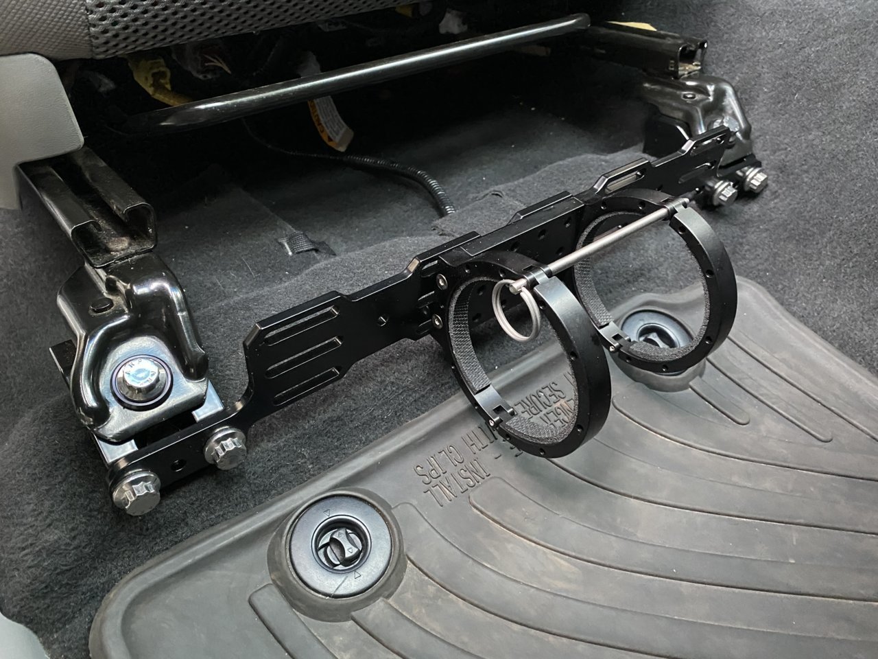

    New DDI quick release mount and H3R performance Fire Extinguisher setup.

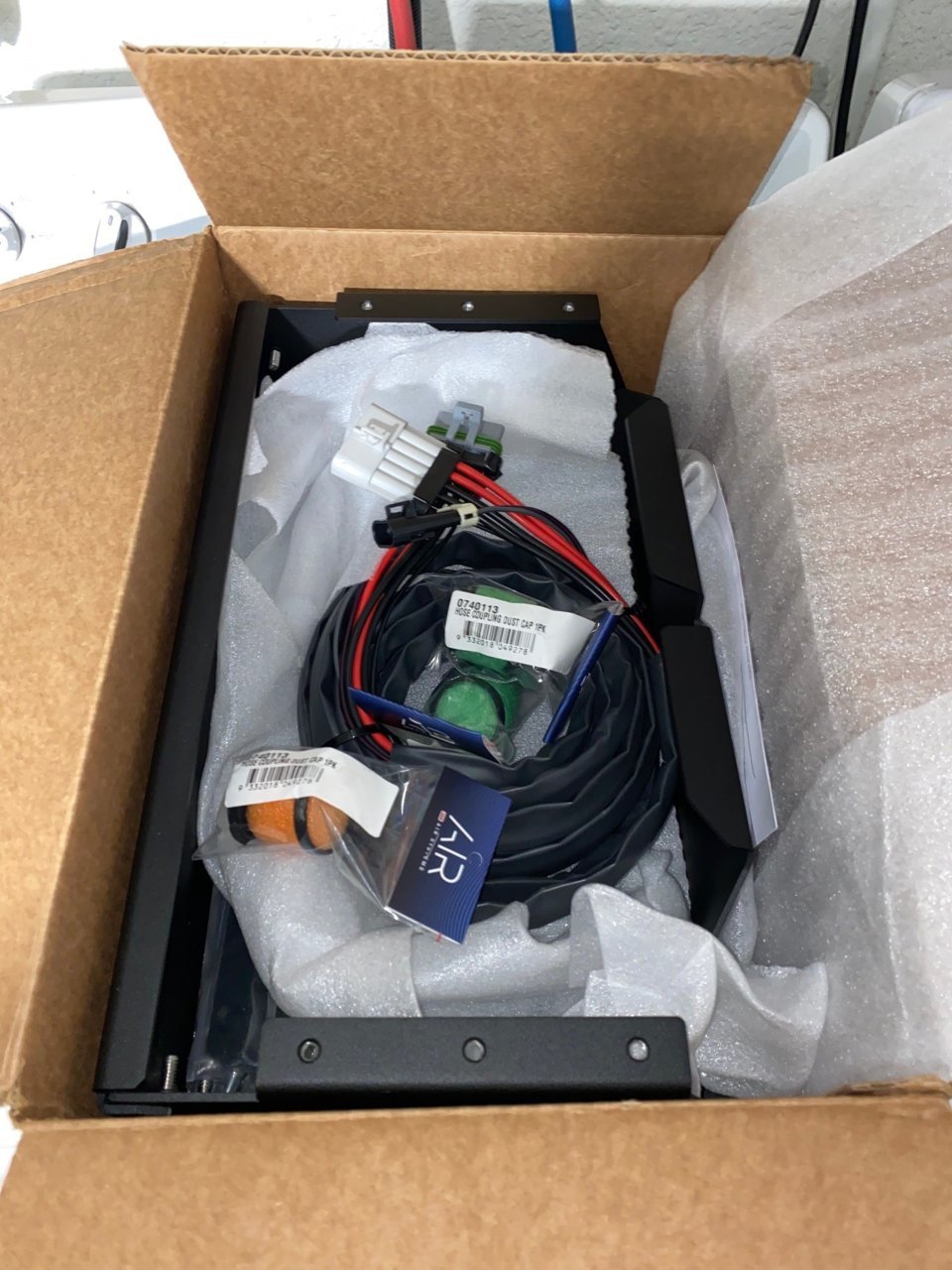

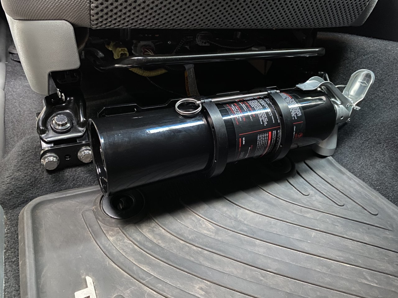

  11. Feb 5, 2021 at 9:49 AM
    #271
    greenEFSI
    Jun 29, 2016
    #190830
    1,560
    Gio
    West Covina, SoCal
    I've got everything ready to install. Now I need to plan out the custom hardline for the relocated air chuck...

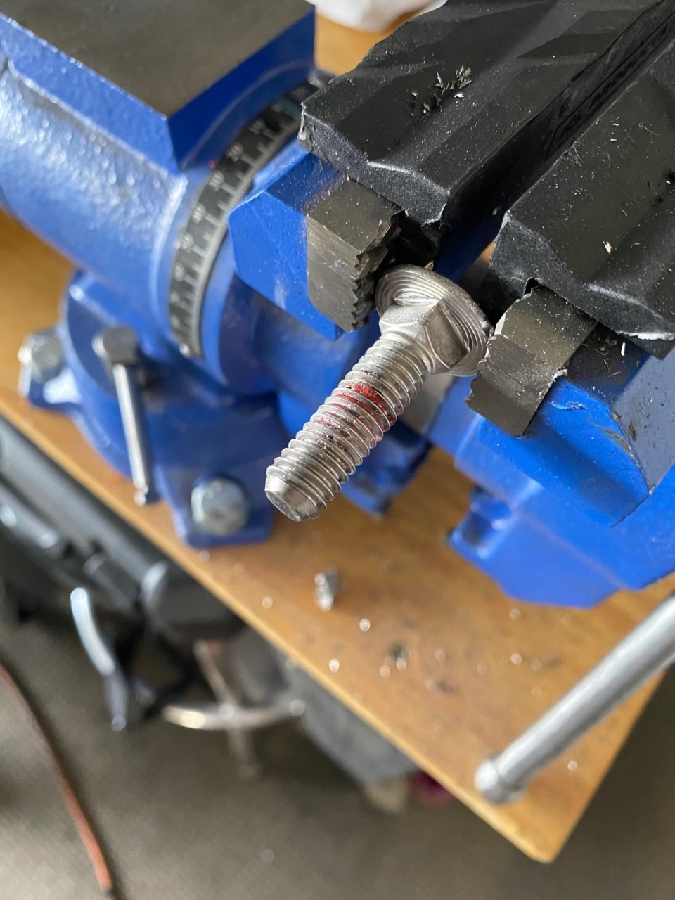

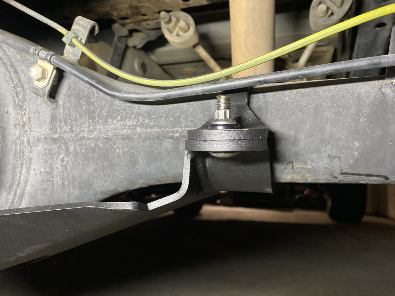

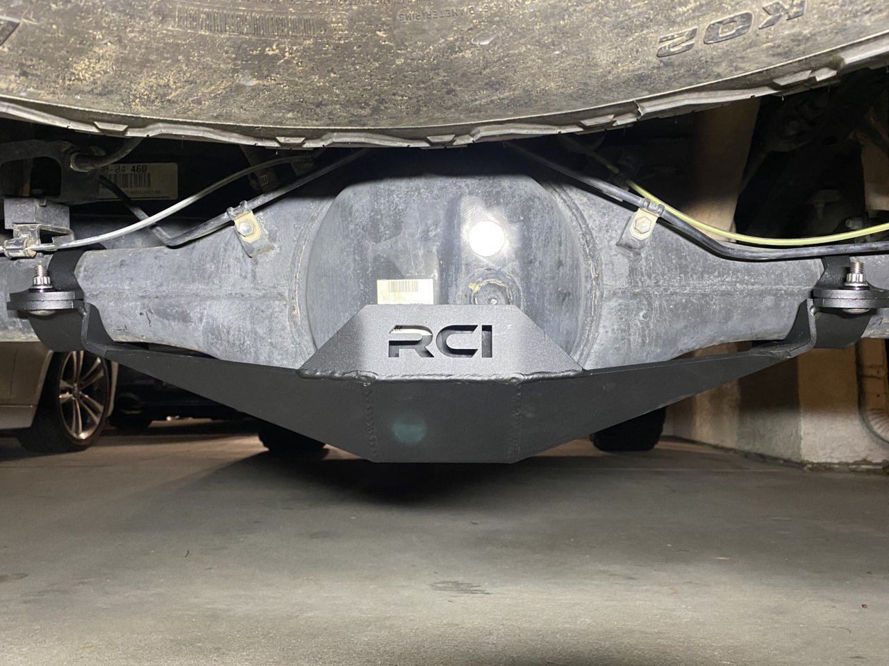

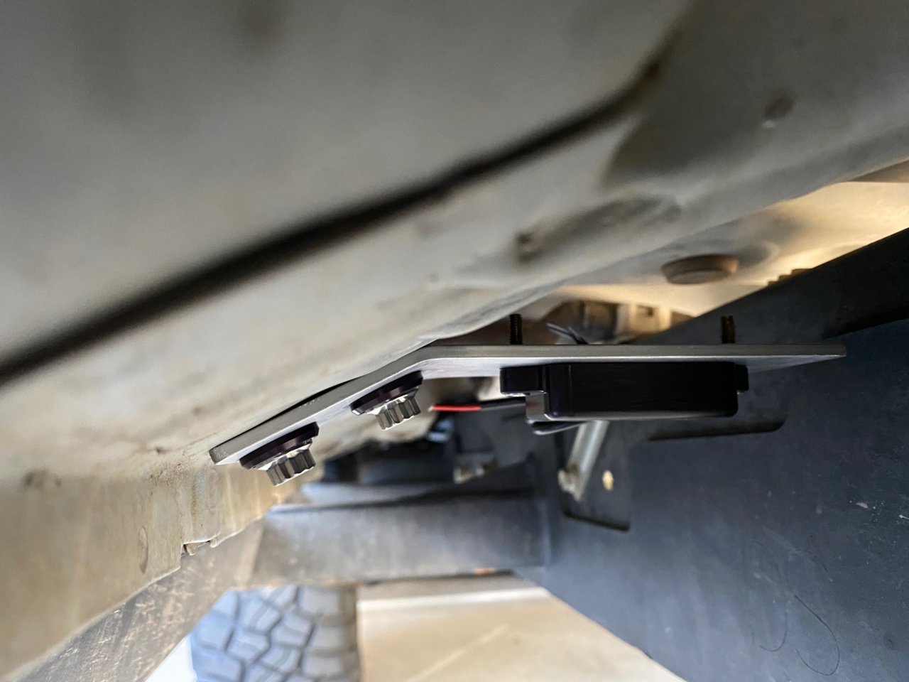

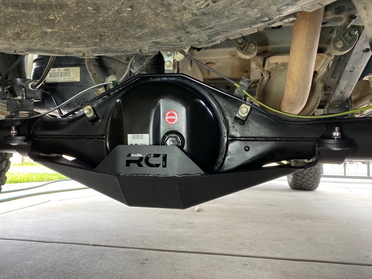

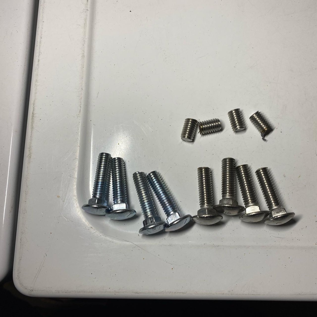

    Rci rear diff skid with custom arp nuts and stainless carriage bolts combo. I wanted arp nuts but wasn’t happy how they looked on the zinc plated hardware. So I picked up stainless carriage bolts but they were too long. Cut them all down to the size I liked and threw them on!
    13txtaco likes this.
  13. Mar 5, 2021 at 8:01 AM
    #273
    clenkeit
    clenkeit Well-Known Member
    Apr 30, 2019
    #291841
    2,442
    Colin
    Lakewood, CA
    2010 White DCLB TRD Sport
    ^Looks SO much better. My only suggestion would be to round off those sharp edges created by cutting the bolt down. Not only are they a bit of a cut hazard but ripe for encouraging cross threading.
    greenEFSI[OP] likes this.
  14. Mar 5, 2021 at 9:00 AM

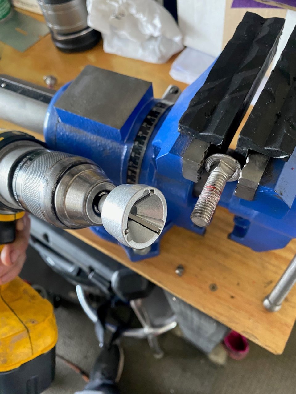

    I ordered up an external chamfer bit :thumbsup:

    I've seen those recently and they look really interesting - probably really nice to have. I've always just hit them with a file or grinder wheel or whatever I have on hand at the moment.
    Gotta link to what you bought?

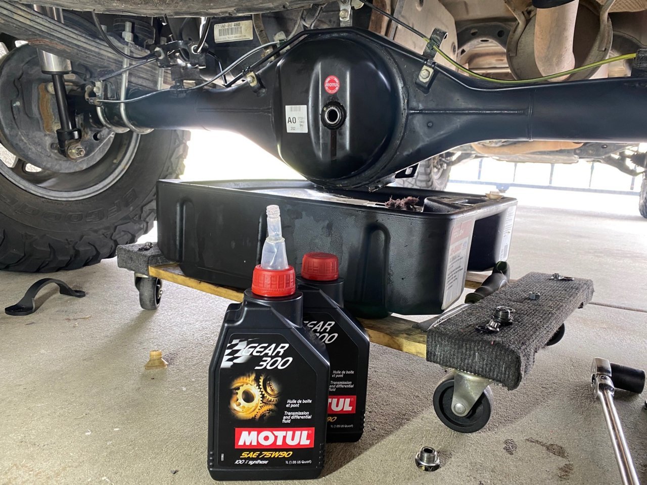

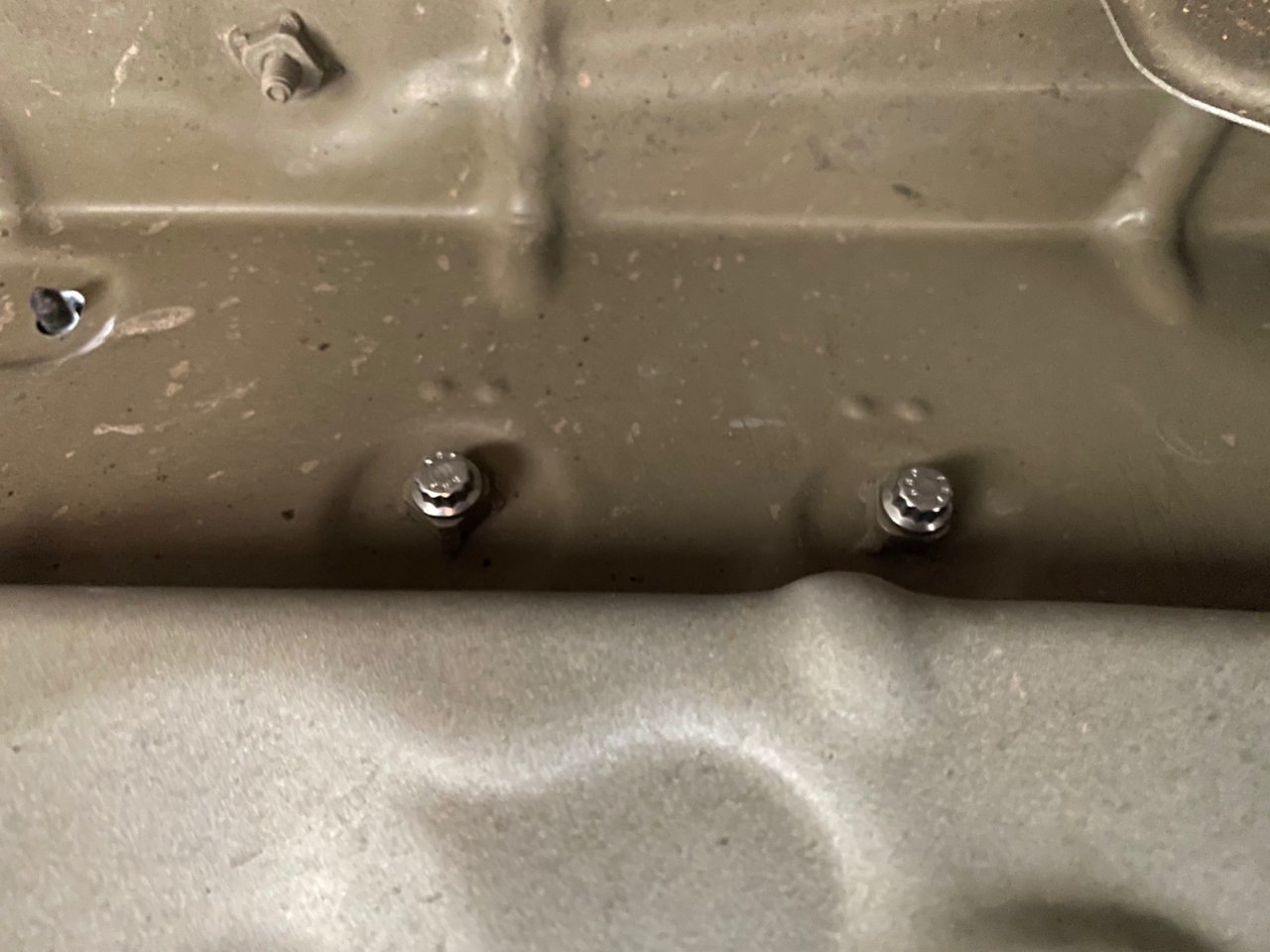

    Dropped the rci skid, cleaned the axle, chamfered the bolts and changed the fluid. Prepping for moab next month, lots to do!

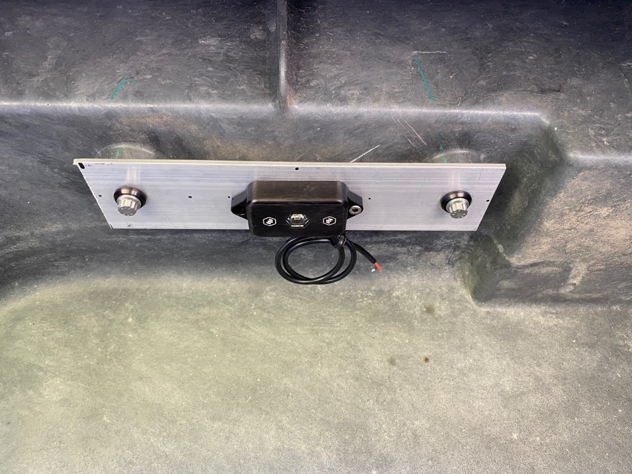

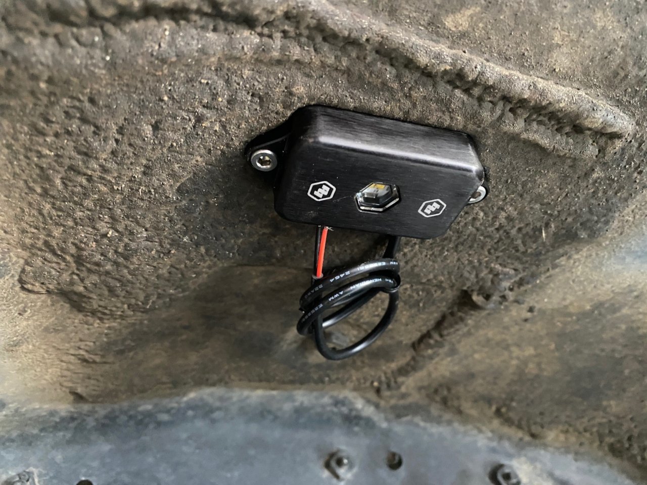

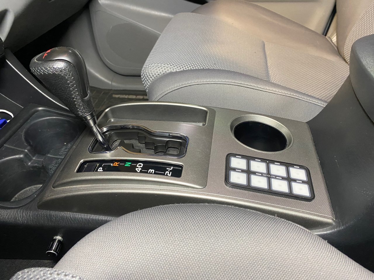

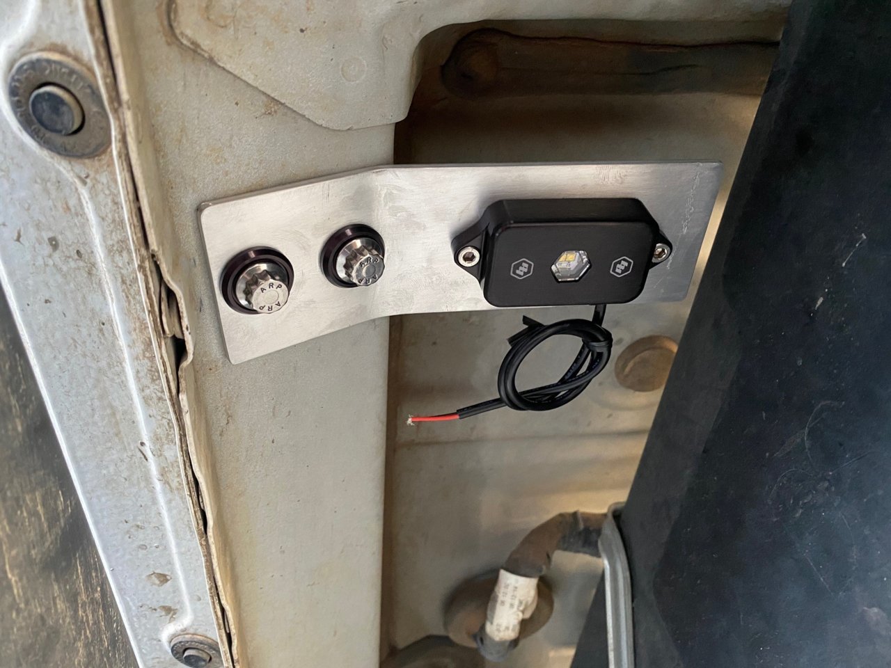

    Got around to mounting my @Baja Designs rock lights. The mounts are pretty rough and still need some fine tuning, but I was waiting for the wiring parts to come in. Once I make the harness I'll be able to finish the brackets and wire the switch pro. I also cut the center console to mount the switch pro within reach of driving positioning.

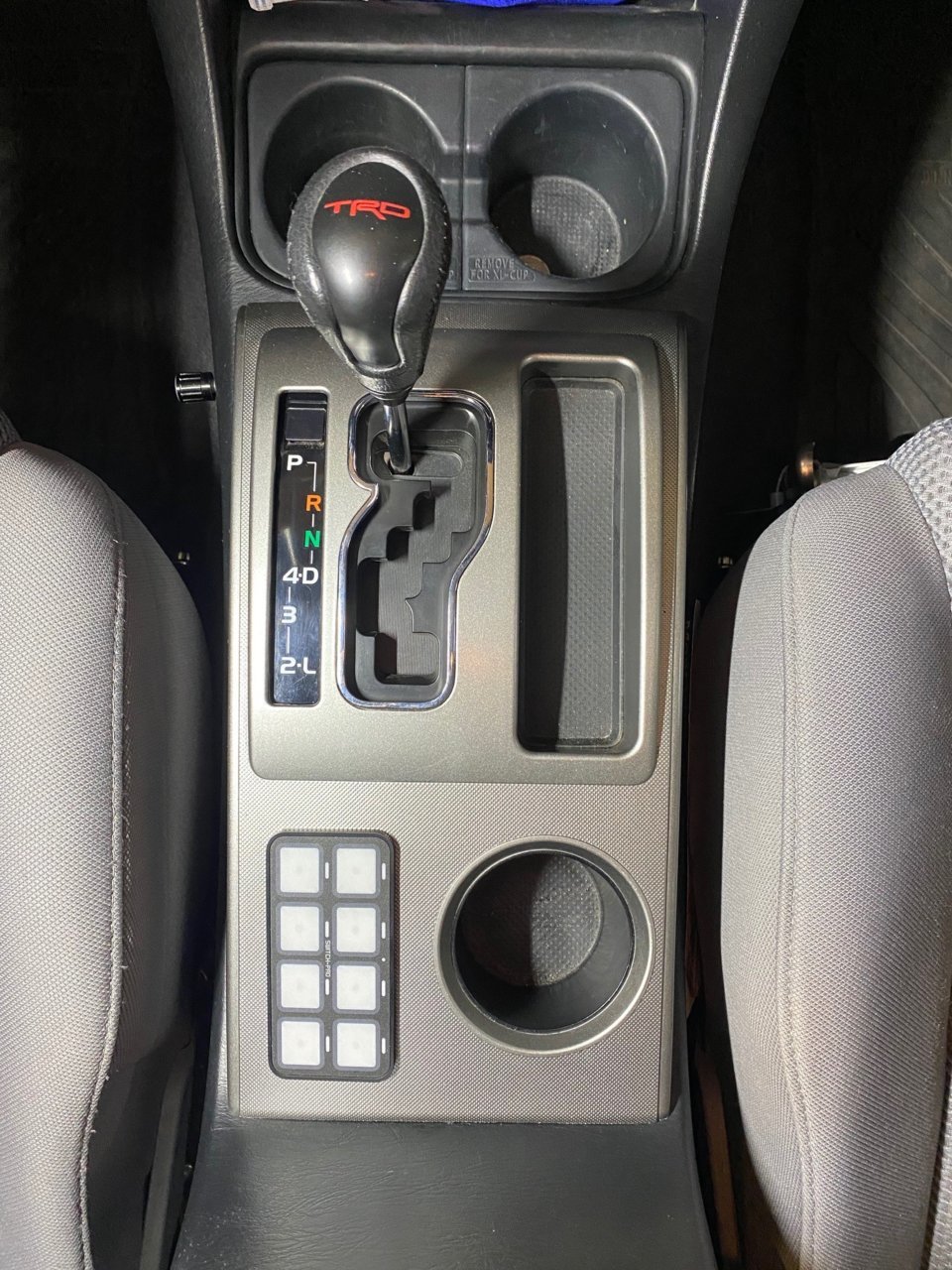

  20. Mar 24, 2021 at 11:30 AM
    #280
    clenkeit
    Apr 30, 2019
    #291841
    2,442
    Colin
    Lakewood, CA
    ^Been watching on IG. Those look great - super slick installation!
