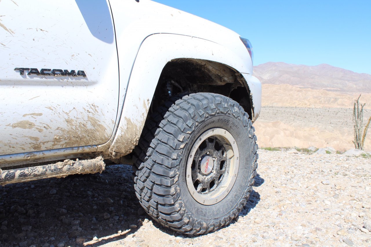

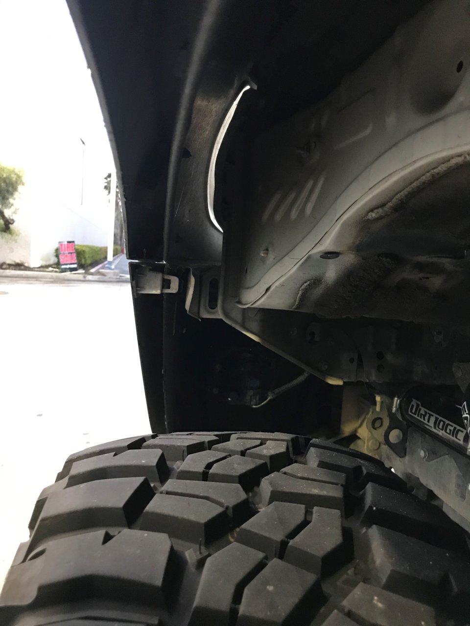

    Truck looks nice brother. Any close up pics of your front fender/flare cuts? I’m curious how the front bumper extension piece came out specifically. Is there a big gap? Any pics would be appreciated. Thanks.

    Thank you! Here is the only one I could find right now. Let me know if this is good or if you're wanting a different angle.

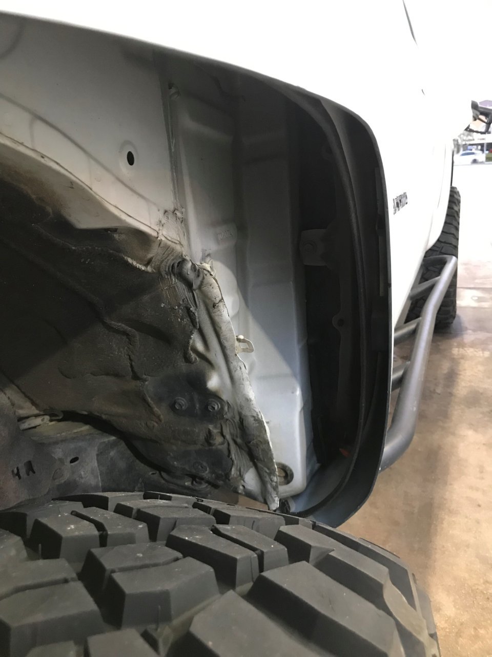

    If you can post up a closer look at how the cut looks on the bumper side of your front fender....that’d be appreciated!

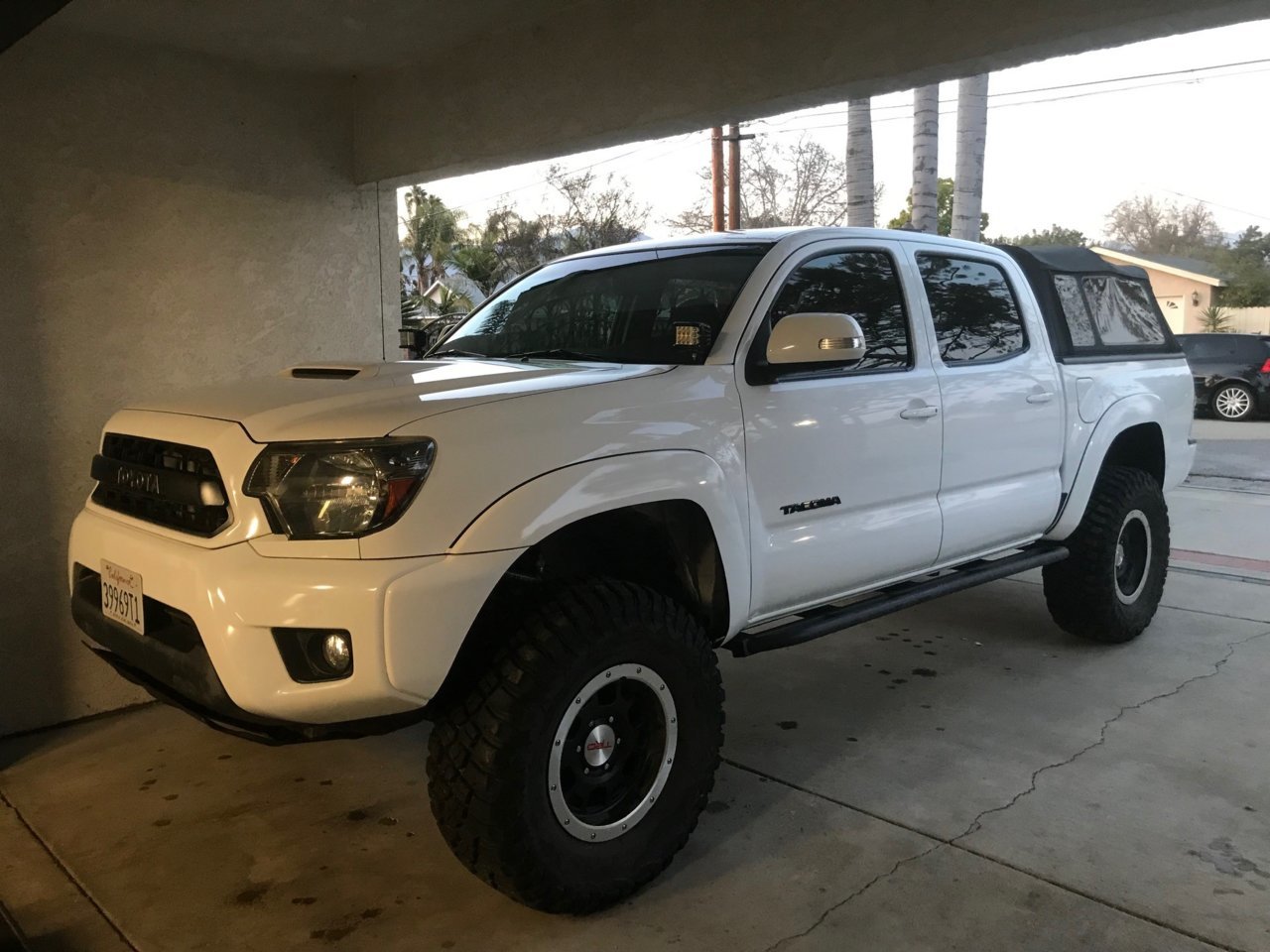

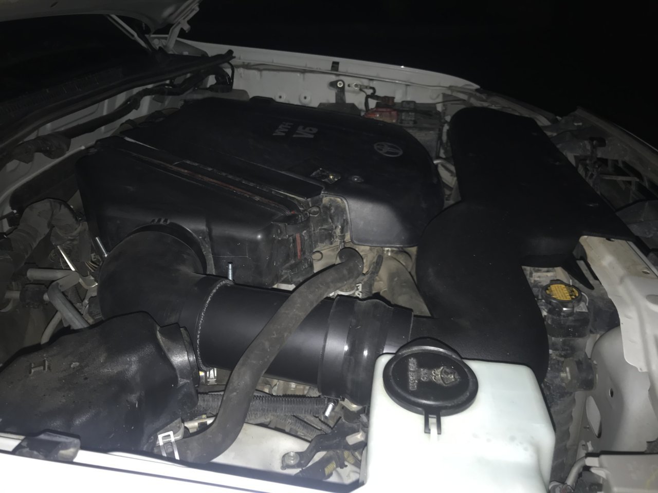

    Just finished up my custom intake setup. Still need to re-adjust the clamps but it got dark. No more worrying about dirt and water with the factory tube in the fender!

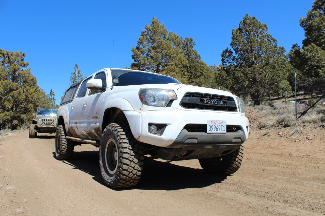

    @huli467 My apologies for taking so long! I had to use a self tapping screw and washer to secure the bumper to flare back to the fender flare and keep the factory gap the same.

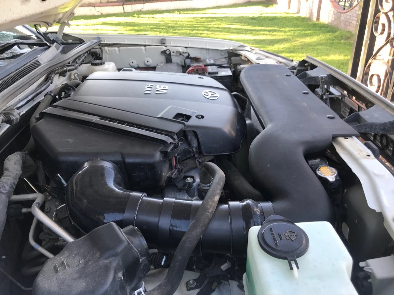

    I got around to cutting the original pipe in half and adding another coupler. This allows a lot more ability to flex and relaxed the elbow to the factory airbox. I might even look into getting a 45 degree elbow vs the 90 that's on it now, but that will be a project for another day.

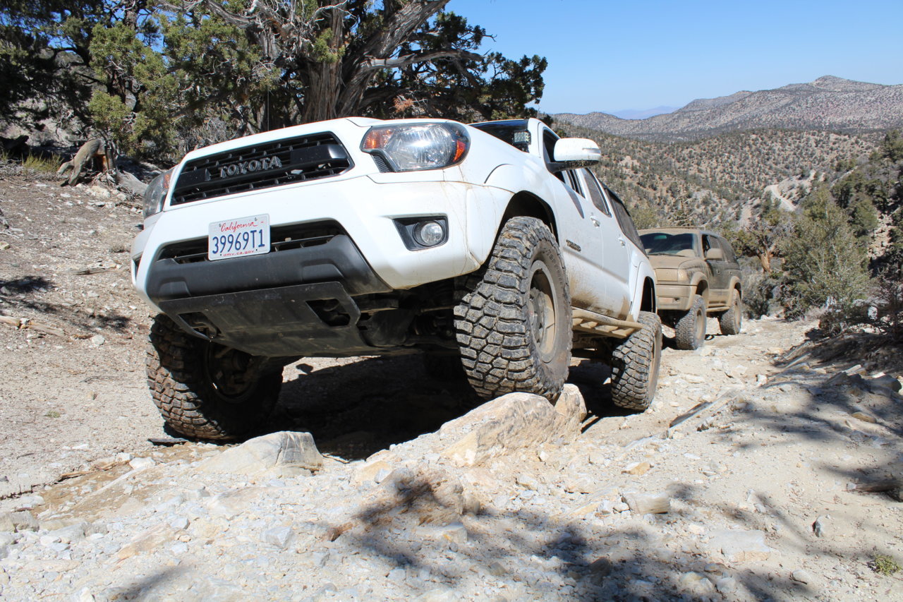

    Chopped the stock overloads into mini blocks and installed them last night :cool:

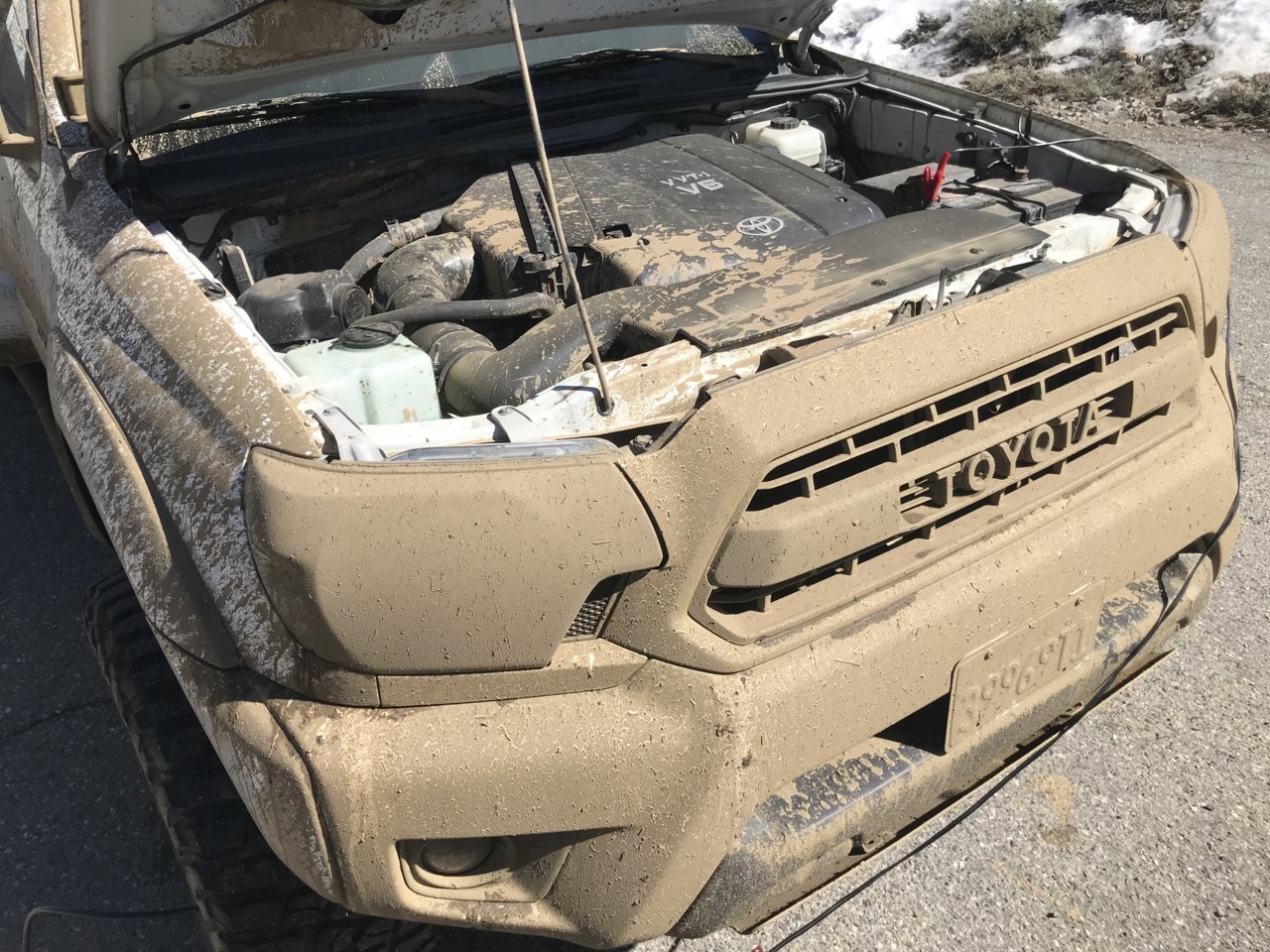

    Tackled heartbreak ridge in big bear. It was pretty intense once you get to the loop! Also put the new intake setup to the test and it checked out good :mudding:

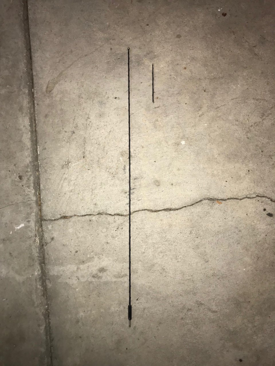

    I chopped the antenna down a few inches. Keeps the factory look and I don't have to reverse into the driveway anymore!
