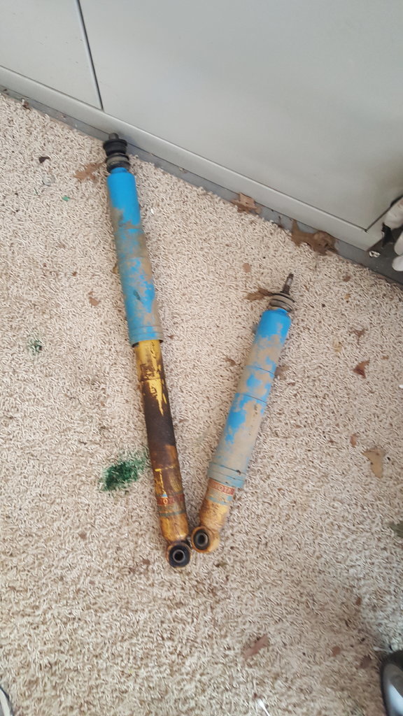

    Didnt get a chance to test my battery today, but I'm going to go tomorrow morning. I did get by Bilstein 5100s in today. Just wanting to level out the front and get alittle smoother ride. Only had time to replace the rears, but this is what they looked like. Now I see why it rode so rough haha. Passenger side is I completely shot, has no resistance or recoil20170711_120305.jpg

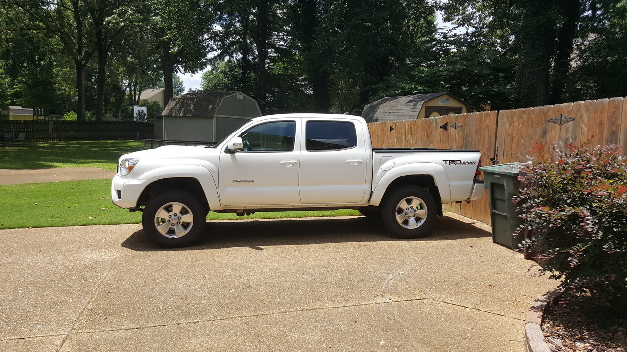

    Got the battery checked today, and everything was good with it. Still no progress on that issue, but I did get my front 5100s on. Set them at 1.75". Truck looks alittle nose high to me, but it is dead even from ground to the fenders all the a way around. I might do aal  eventually anyway so I didn't want to short change the front and have to redo them.20170712_123820.jpg
