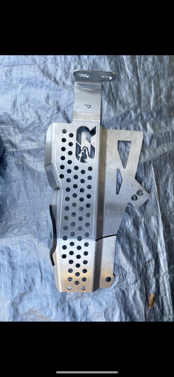

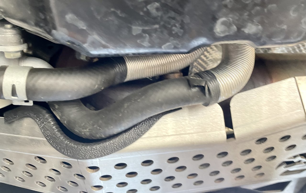

    4547EEC0-1533-4C9B-B1DE-5915F37DEE22.jpg I’ll go first…CaliRaised I sent you a message yesterday about fitment issues I had to work around but haven’t heard back.
    I have a TRD OR and had to ream out both sets of forward slots to get the shields to align and bolt up. Also passenger side cutout for transmission hoses rides hard against the line had to grind off approximately 1/8 to 3/16” material the length of the cutout (make deeper) and then I installed some edge guard material as a rub protection for hoses.
    Overall it is what I purchased a thief deterrent at a price point I felt was reasonable.
    I recommend that the slots and mounting holes all be lined checked for proper dimensions or they’re likely to get complaints.

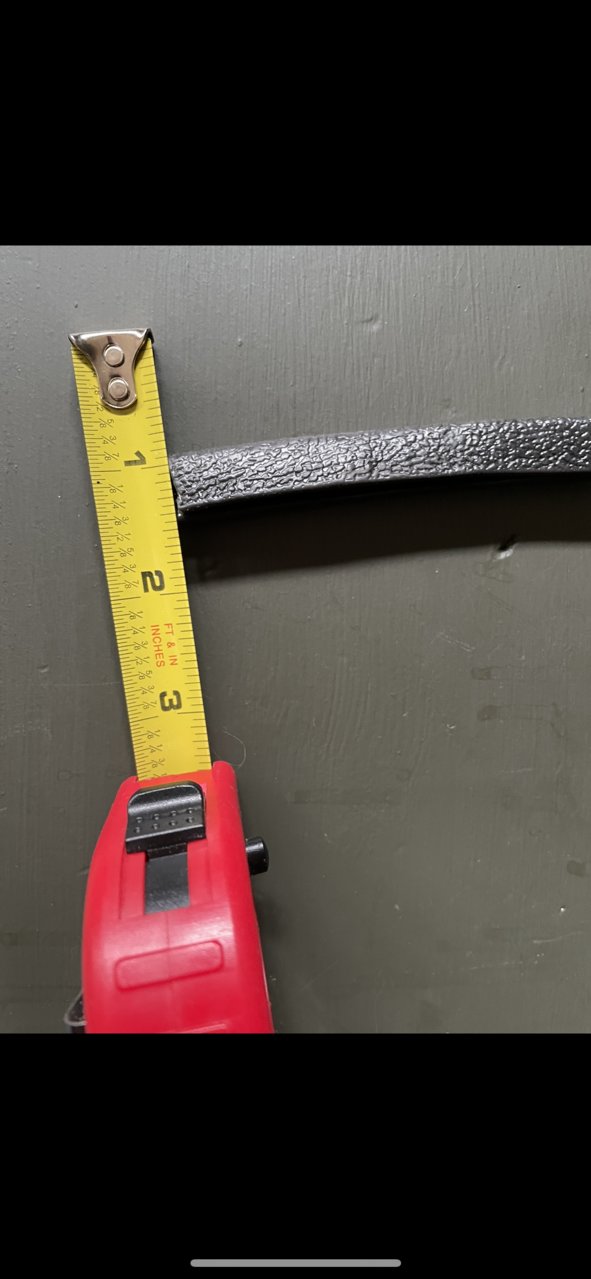

    What size edge guard did you use?? Mines coming today and I may want to do the same if it looks like it will be rubbing. Thanks for sharing your experience

    3/8”

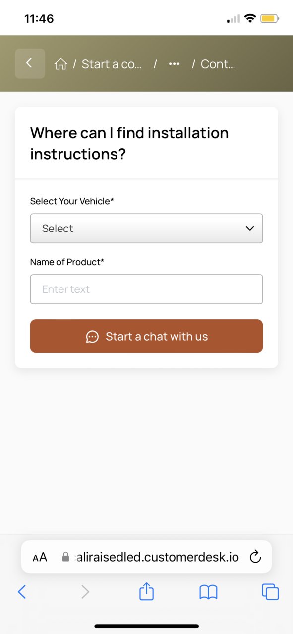

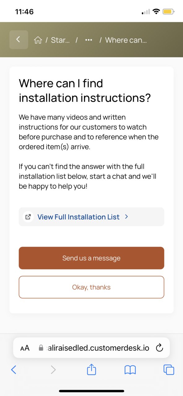

    Good Morning!
    I searched around trying to find a contact path on your site. It was after hours and I believe it was in the install question section and a chat feature. It asked if I wanted a reply by email or Text message. I chose text message. I left a message about the issues and these pictures.

    it was in these tools that I left a message.
