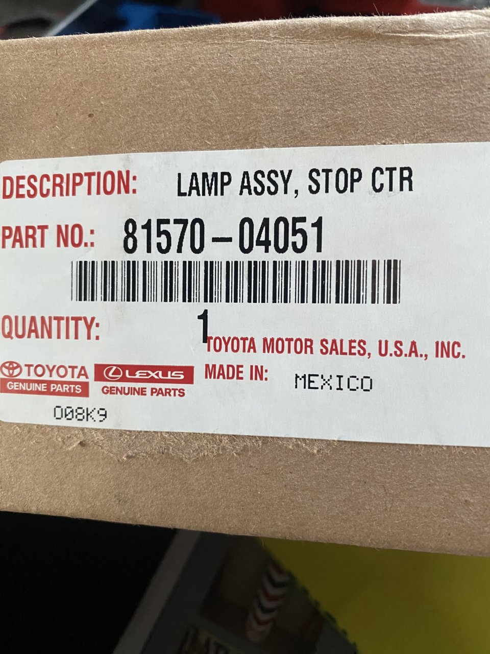

    They do have a updated number even after the TSB they updated it again. Just picked mine up last Friday but haven’t put it in yet. I’ll get ya picture of the part number tomorrow.

    For anyone wondering here is the updated part number on the lamp...

    Did the new 3rd brake light fix the leak for you without adding additional caulk?

    Mine just started leaking (or I just noticed it for the first time after washing my truck last weekend). Does the new one have a much thicker gasket than the original?
    I ordered the part this morning and will install it myself sometime in the next few weeks. Since I live in LA its not going to rain here for another few months, so I have plenty of time to install it.

    Yep as far as I can tell it fixed it! No additional sealing or anything

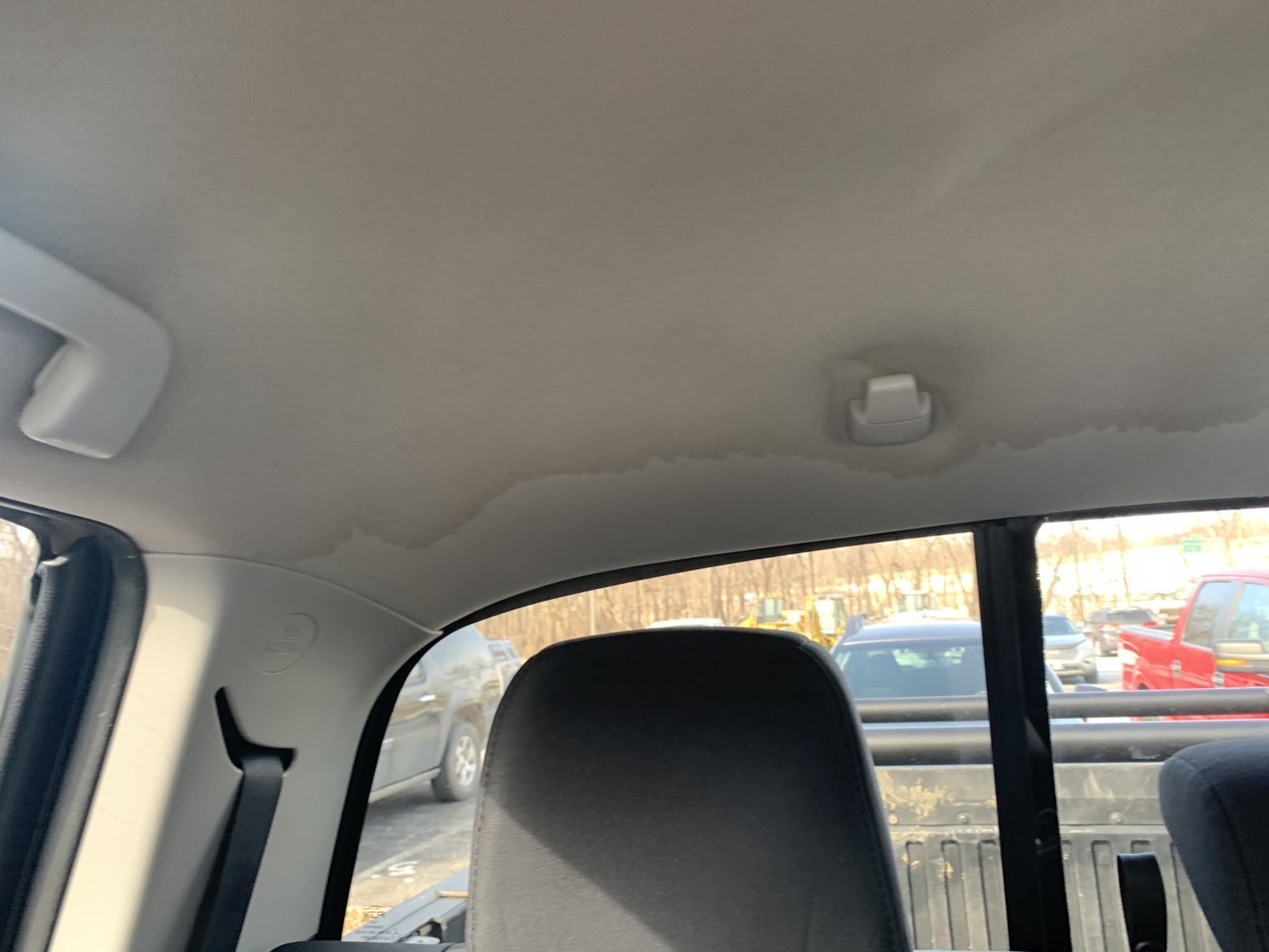

    Got in the truck this morning after a hard rain last night. Sure enough, wet headliner...
    This is bullshit! The truck is used with 90k on it.
    How can I fix this? Did replacing with the above part solve the issue?
  19. Aug 11, 2020 at 5:28 AM
    #59
    suaveflooder
    suaveflooder Well-Known Member
    Feb 28, 2018
    #245929
    1,291
    2021 4Runner Venture
    i’m on a probably 6-7 (3-4 months) washes on the new lamp with zero issues. They just added more “padding” to the light so it fits the body better. I’m willing to bet it will leak again as the new gasket ages, but it’s fixed for now.
    it’s not a bad job. Just time consuming. Have a couple beers ready, good music and take your time.
    don’t cheap out and do the silicon, just my opinion. If you are gonna do it, do it right
