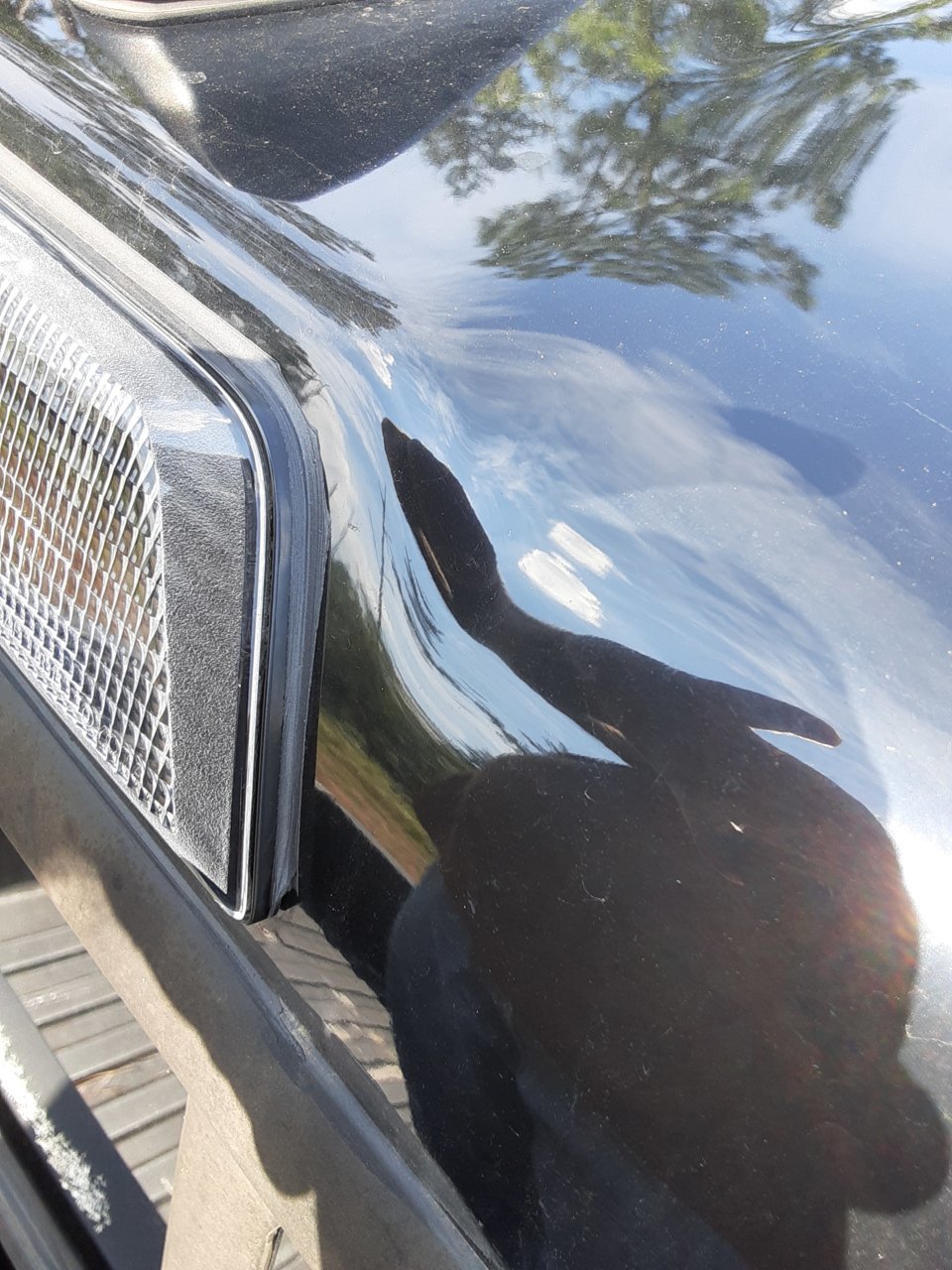

    I had the same problem on my 2017 Off-Road, took it to the dealer and said $500.00 "WHAT"???
    No way was i going to pay that for them to replace the light that leaks - don't you think it should have been a warranty claim?
    So i went to Home Depot and picked up GE 100% waterproof silicone (77027 00500 UPC).
    The light bolt/nut must have come loose or was never tighten all the way causing a loose seal big enough for me to be able to insert a credit card on the right side. I pried it back and used the tube of GE clear silicone all the way around the seal - actually I squeezed a lot within the light, after it drier; I went over it on the outside of it with my finger with the same sealant accept "black" - so far "LEAK PROOF" for under $10.00...
    https://www.homedepot.com/p/GE-Adva...one-Sealant-Caulk-Squeeze-GE500-3TG/100179996
