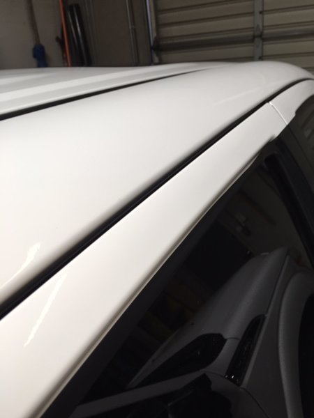

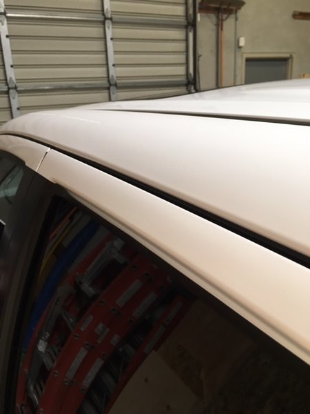

    Kind of wondering if anyone has experienced their window seals separating on the rear windows of the DC. I have informed my service manager but I will not take my truck in until the rear diff issue is resolved. There is no way in hell they are going to confiscate my truck until they figure this out. Mine is seeping and I'm also on the list for the CPS.

    Yes, I've noticed this on my 2016. I push it up where it's supposed to be and it separates where it connects to itself in the bottom rear.... Mine had a crack of about 1/4", so I filled it with silicone for now...
    Will likely see what they will do before the 3 yr. comes up... Maybe by then, they will acknowledge that it's an issue...

    I'm concerned about the repair for this, I don't want it looking like shit. Although it looks like shit right nowo_O
