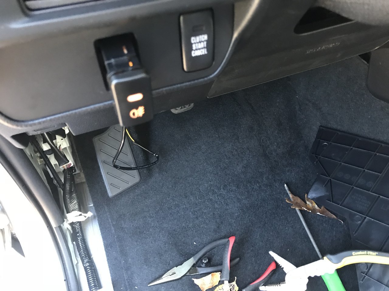

    I bought a ebay kit. All is good except for the switch. Its too large. I have looked at several on Amazon, just not sure which one to get.IMG_0243 (1).jpg
