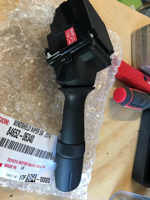

    Installed my Intermittent wiper today on my 2019 SR Access Cab. Wasn't as simple for me as it should have been based on the comments, lol. The two halves of the steering wheel column cover were well put together steadfast, took a little prying and a good deal of pulling to get them apart. Getting the non-intermittent wiper off also took a while, tried using a small allen wrench to pop the latch free, putting a screwdriver at the end of the latch was awkward that wasn't working either. I finally got it off by wedging in a small screwdriver,at the top side edge of the latch, prying up on the top edge slowly as I wiggled and pulled on the wiper assembly, and it popped right out. I put it back on and then took it off again just for practice, it was really easy, 2 seconds once I found a technique that worked for me.
    Getting the cover back together took a while as well, it looked like it was together, but the right screw hole was misaligned. Once I got it aligned and together, I noticed turning the steering wheel a rub on the lower cover, so I disassembled and reassembled and made sure I had everything aligned with good clearance.
    I'm good at nuts and bolts and electrical, but taking apart plastic truck parts is a new one for me so I took my time and was cautious so I wouldn't break anything. It turned out great in the end, tried out the wipers (even before i reassembled everything) and they work perfectly. Nice to have intermittent wipers again!
    Bought my new intermittent wiper switch online from McGeorge Toyota $120.88 + $12.33 shipping, no tax:
    https://toyotaparts.mcgeorgetoyota.com/oem-parts/toyota-wiper-switch-with-intermittent-wipers-listing-is-backwards-8465206340/?c=Zz1zdGVlcmluZyZzPXNocm91ZC1zd2l0Y2hlcy1hbmQtbGV2ZXJzJmk9ODUxOTI4NTUmcj0zJmE9dG95b3RhJm89dGFjb21hJnk9MjAxOSZ0PXNyJmU9Mi03bC1sNC1nYXM=

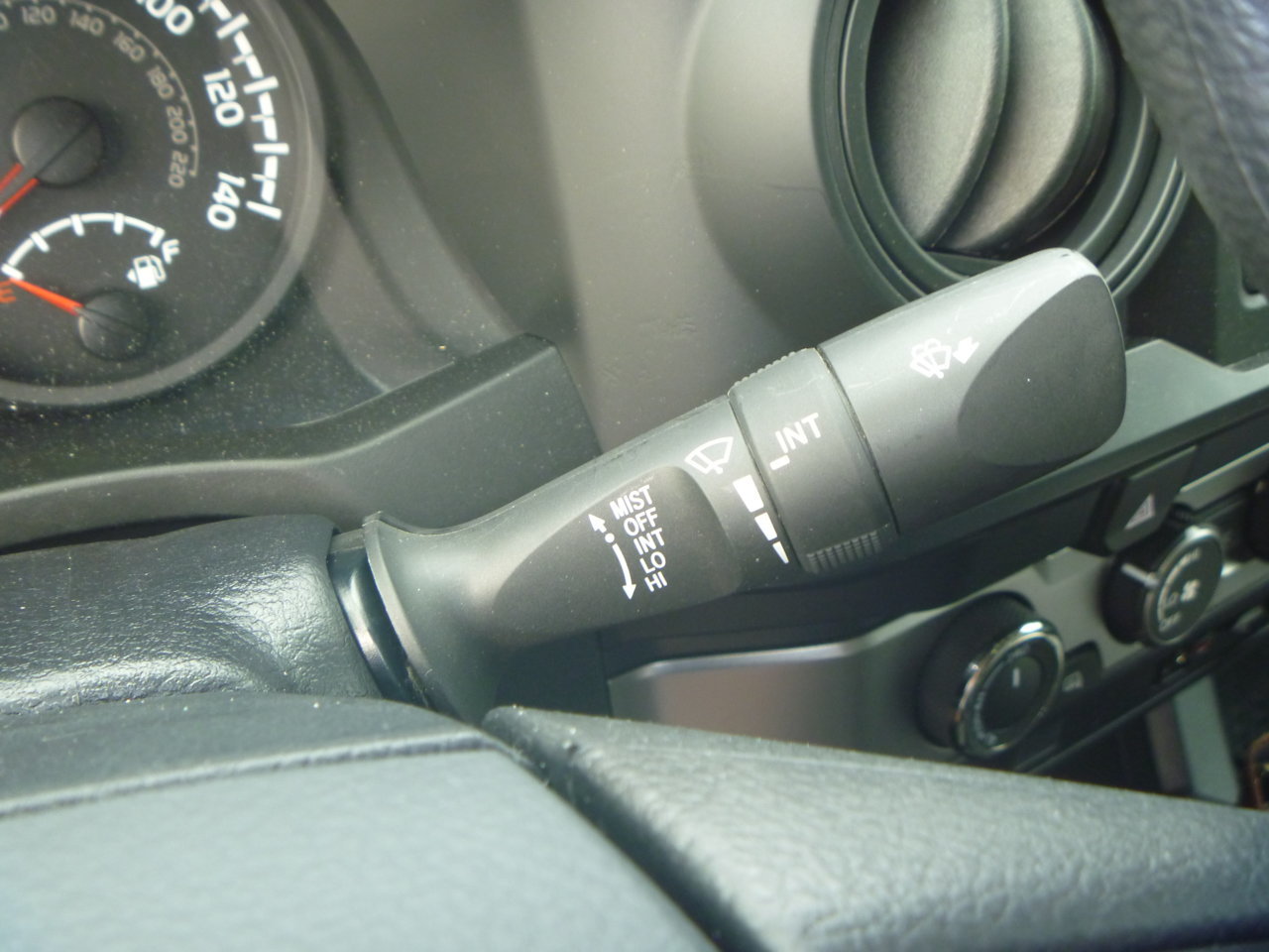

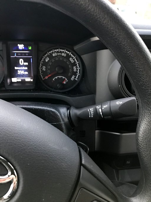

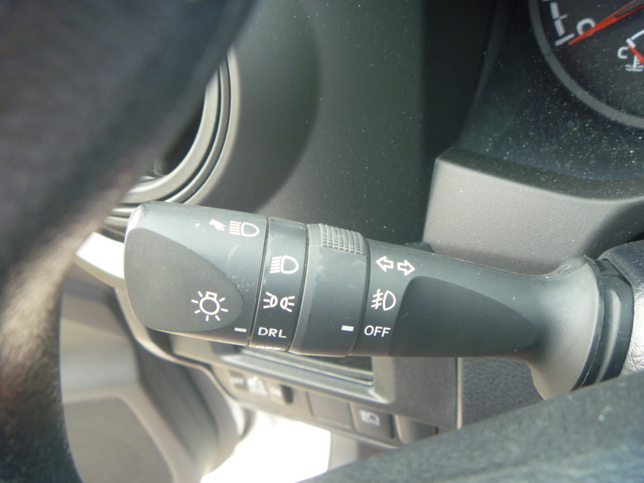

    I set out to upgrade my SR to intermittent wipers and while searching for the best price I found the entire stalk assembly including the headlight stalk with fog light switch for $119 used. Pics showed it to be pristine and it was advertised as being from a 2019 Taco. It turned out to be as advertised. I sat on it for a couple of weeks before installing it because the videos on YouTube and the write-up elsewhere on this board looked quite intimidating. I finally decided to dive in, damn the torpedoes full steam ahead. Turned out to be super easy. Took my time, went slow and made sure I did it right. Even the steering wheel came off effortlessly. Only difference I ran into was the 2019 does not have the metal clamp holding the assemble to the steering column like the vids and the writeup showed. Instead it has 2 plastic clips, one on top and the other on the bottom. Super easy to release. It all went back together as easy as it came apart and works flawlessly. I then ordered everything I need for the fog light, got the light from a fellow forum member, now2 I'm just waiting for the weather to warm up and clear a bit before installing them. If anybody is contemplating replacing the stalk assembly like I did to add fog light, do it, it's easy.

    Me too but I wanted them to integrate with the Taco lights, i.e. turn off when you use your high beams, etc. and I didn't want to add an aftermarket switch to the dash. Having the switch on the column is much more convenient.
