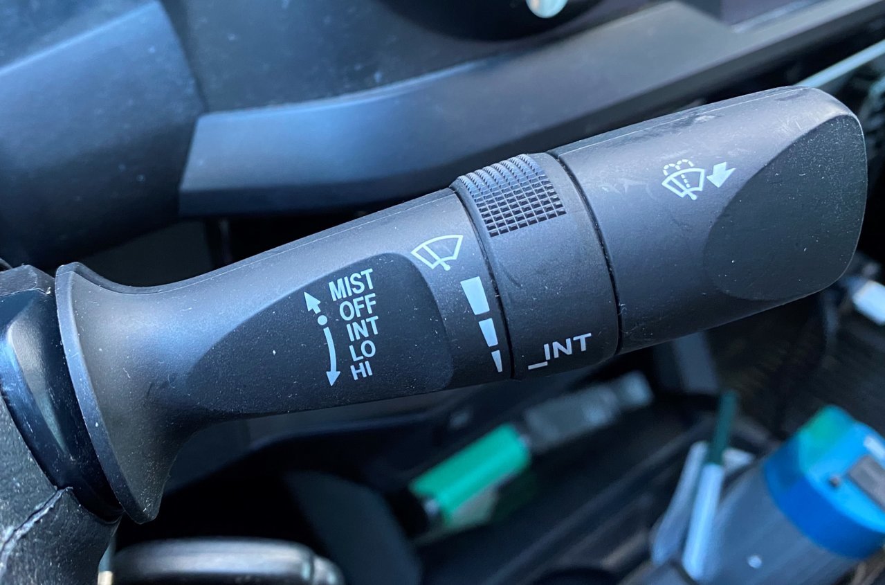

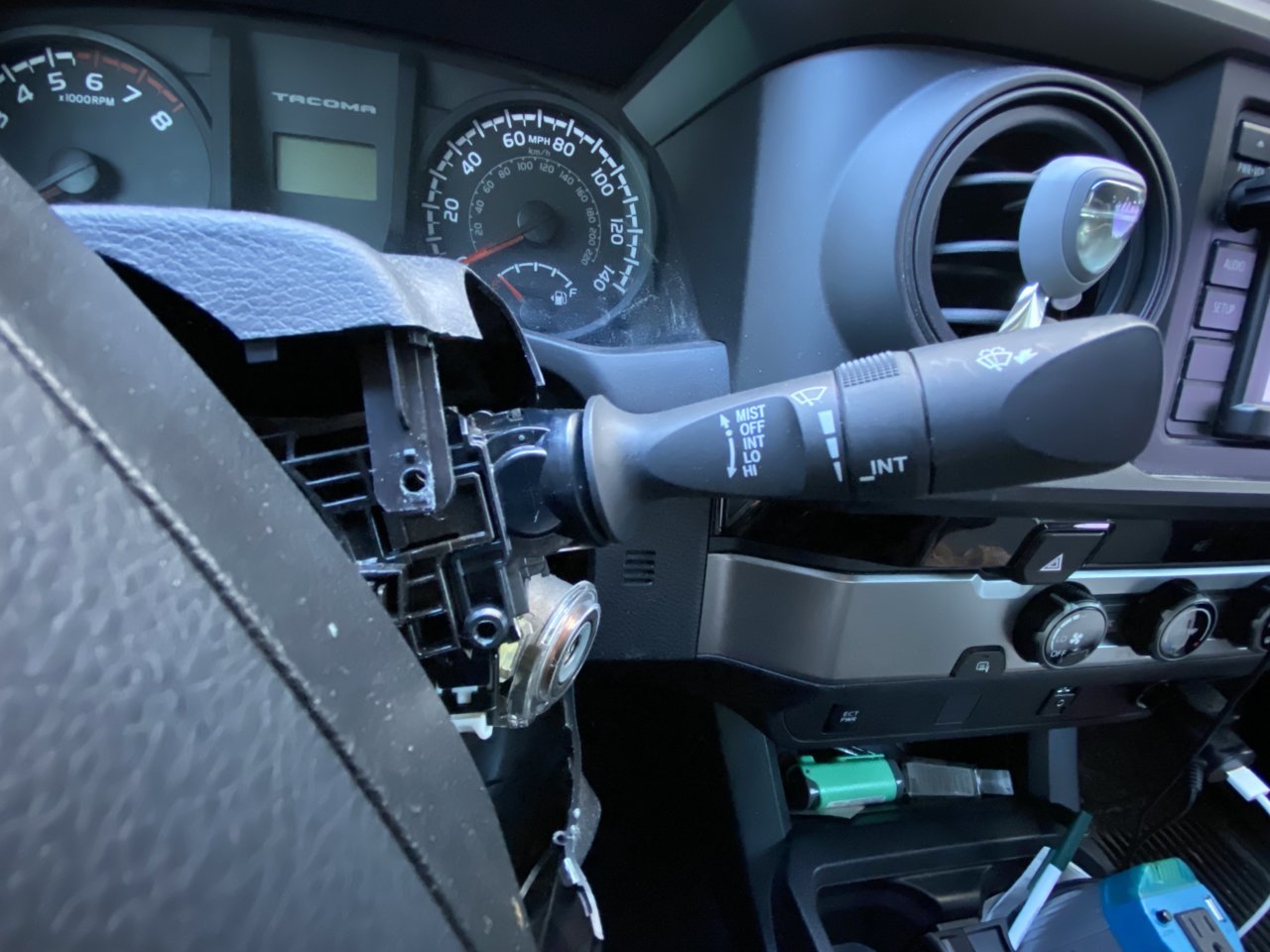

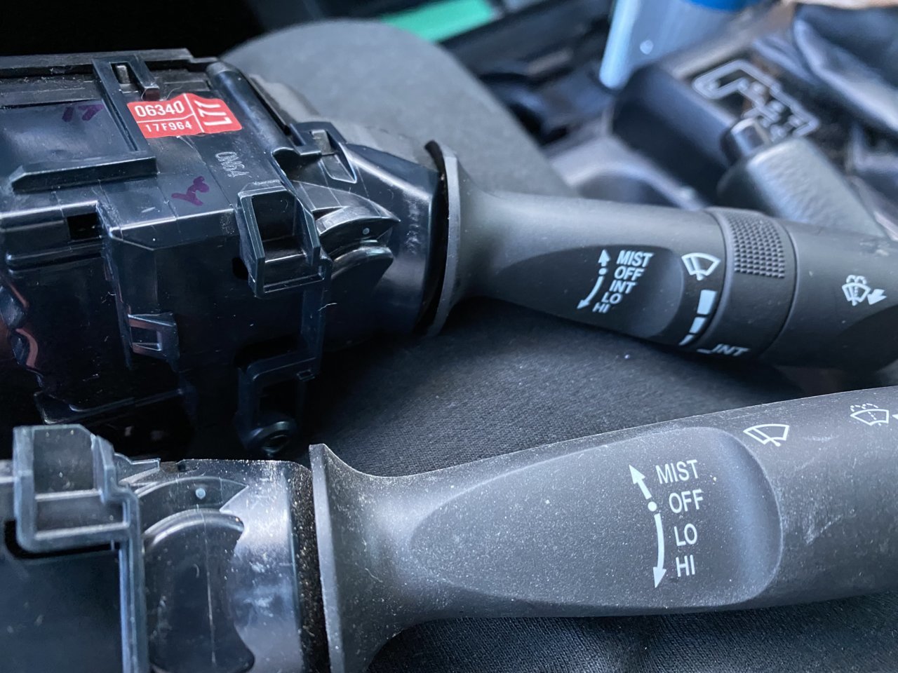

    WHY DID I WAIT SO LONG!!!??? Easy swap out. Actually purchased a 2014-2019 corolla headlight and wiper switch assy for under $60. You search for tacoma specific and sellers usually want 40-50 more for just the variable intermittent switch. Let it RaiN!!
    Also, the 06340 part is noticeably heavier than the 04160 part that you remove. Once I got the screws back in, the gaps in the plastic were no longer seen as they are in the one pic.
