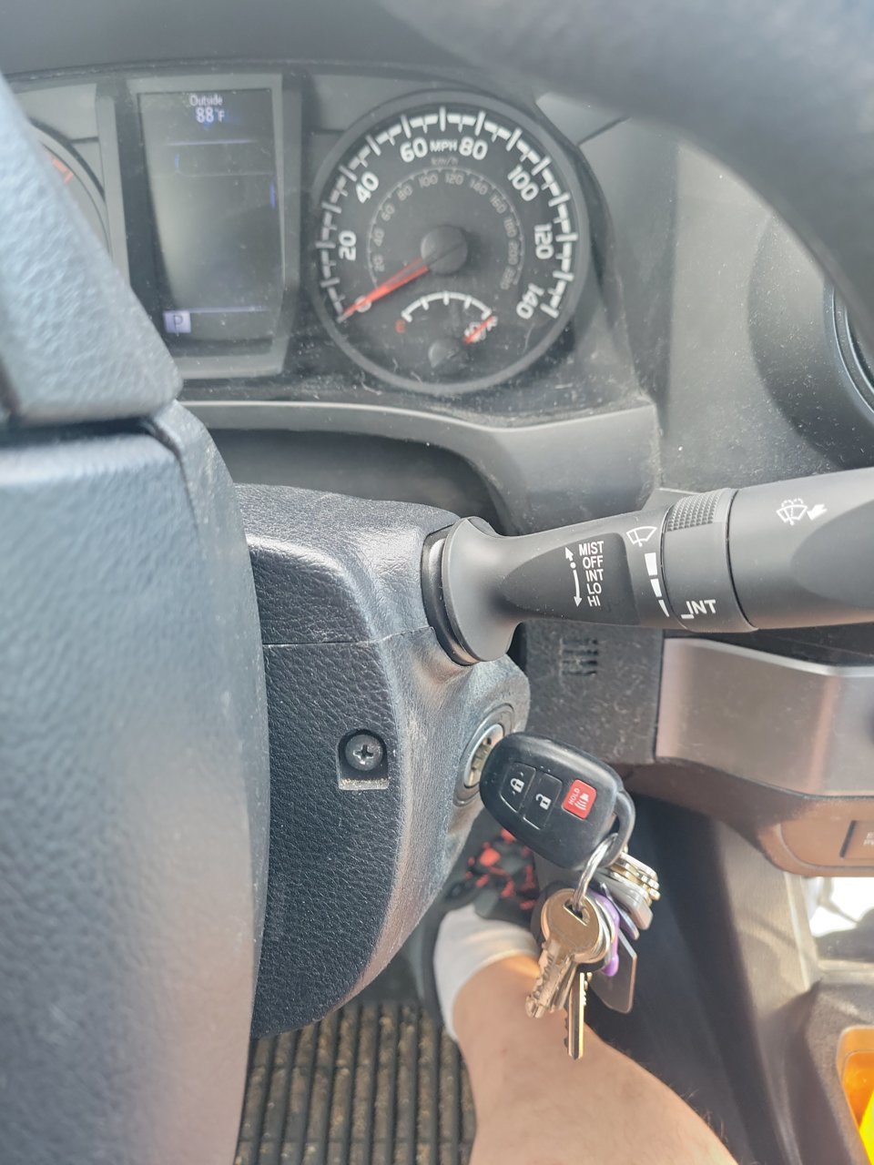

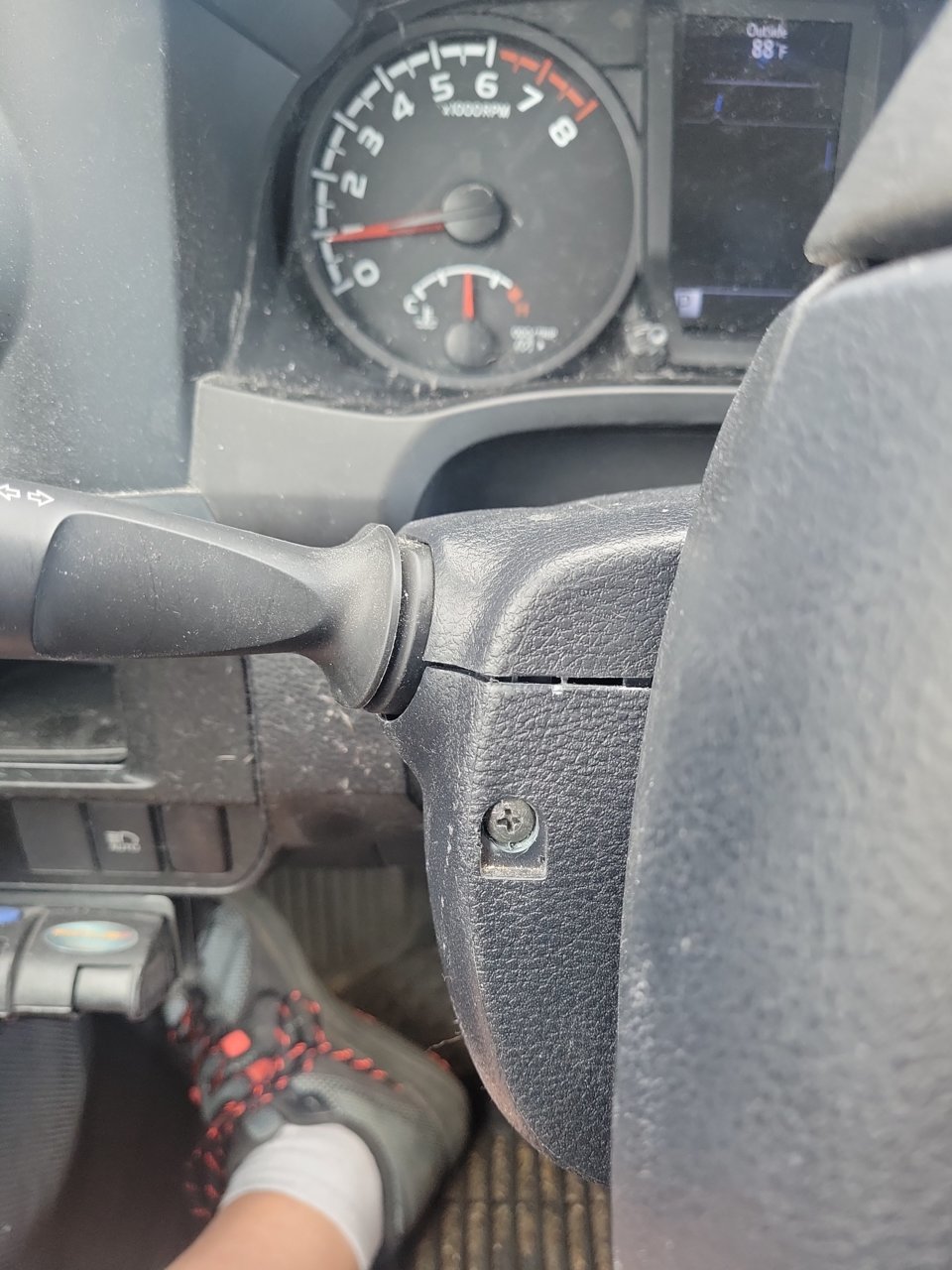

    Thanks for the thread. I went ahead and did this yesterday, took about 10 minutes to do bc of the limited room to work in. Only thing is it looks like there is a little gap on one side of the wheel vs the other (the screws are definitely in properly. Should I take back apart and redo or does this look fine?

    You definitely have one of the little clip inserts not quite in all the way. Won't hurt to take the screws back out just don't tighten them down until both are in.

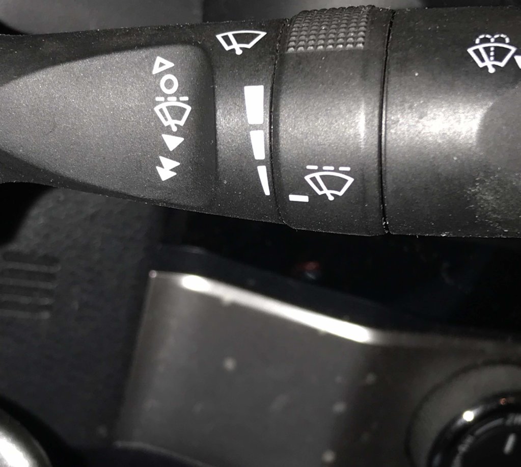

    Just did this on my 2017 SR, with a $36 3rd-party switch from ebay. Notice how there's no lettering on it, compared to the others. The first one arrived with no packing, and a tab broken off. They quickly replaced it, also just thrown in a cardboard box, but nothing broken this time. It works fine, really nice to have the wipers turn on when I pull the spray switch. But in hindsight, it would have been less hassle to get a Toyota OEM from an online dealer. Also in hindsight, next time I will take both top and bottom covers and do a trial fit of the two pieces, away from the steering column, to know better how they should go back together.
