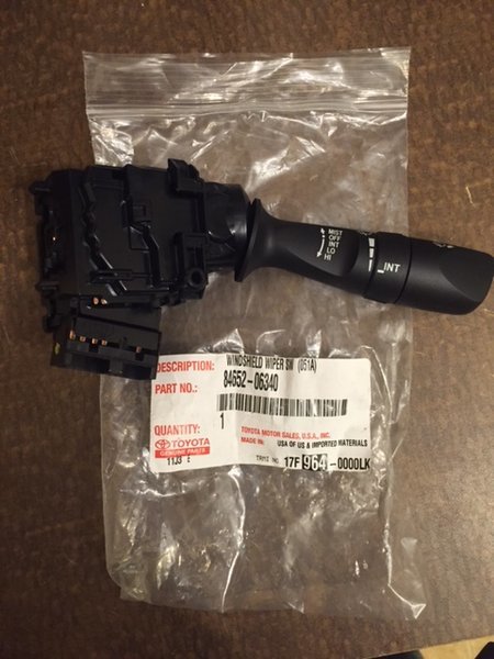

    Brand new in box, $120 shipped anywhere in the US PM me if you're interested. Sold my Tacoma before installing this and no longer need it.

    This is a factory switch that comes in the higher model Tacoma with intermittent wipers. Direct plug and play upgrade into the SR model that came with 2 speed wipers. OEM part and super simple upgrade.
