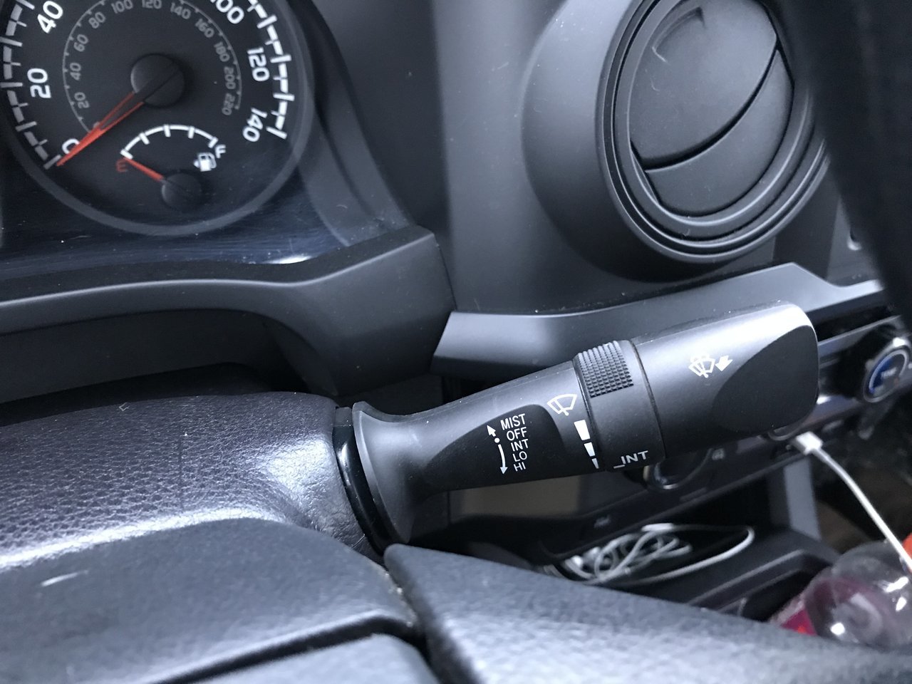

    Done. Extremely easy. Watch the tabs on the top column cover. It was getting stuck and not popping on like it should till I looked down and saw it. Might have to nudge it with a finger.

    Hey Everybody,
    Question, I swapped mine out, but the intermittent speed selection is backwards.
    At the narrow end, the time between wipes is longer, and at the wide end, the time between wipes is shorter.
    Any idea why it would be doing this? I plugged everything in according to the OP, and didnt think there was any other way it could go.
    Any help is appreciated.
    Thanks!
  9. Jan 5, 2018 at 2:50 PM
    #129
    Big Dustin
    Big Dustin Well-Known Member
    Mar 23, 2012
    #75436
    436
    Dustin
    Denver, Colorado
    '17 Tacoma DCSB SR 4x4
    5100's all around, OME 887 with 1/4" spacer, icon 3 leaf aal. 255/75/17 BFG KM's on 4runner pro's. Rigid led pods. Debadged and tinted.
    That's normal operation. I understand your thought process, and I agree with it. But you're good to go as far as Toyota is concerned!
