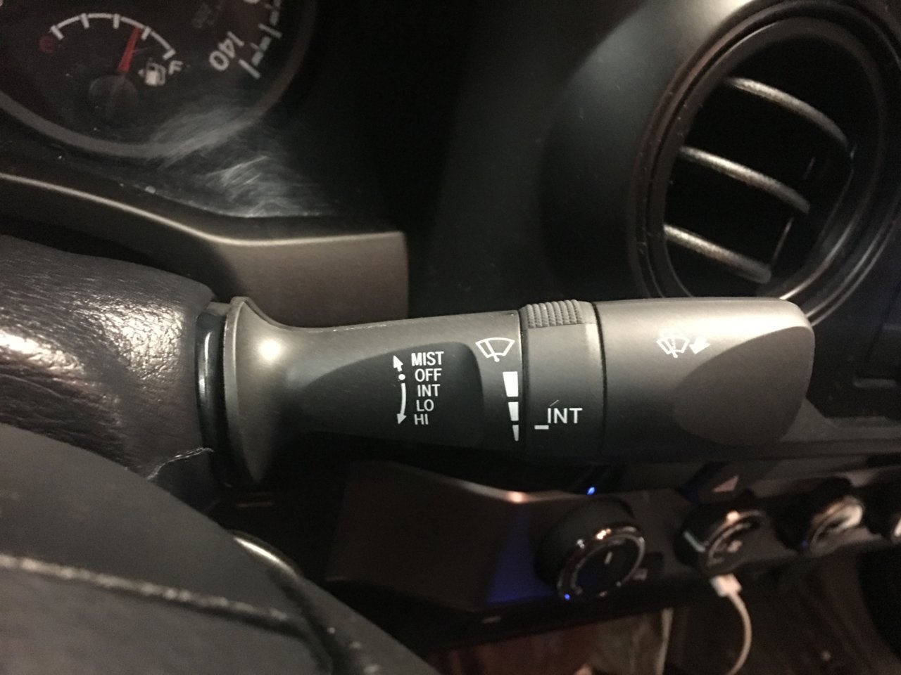

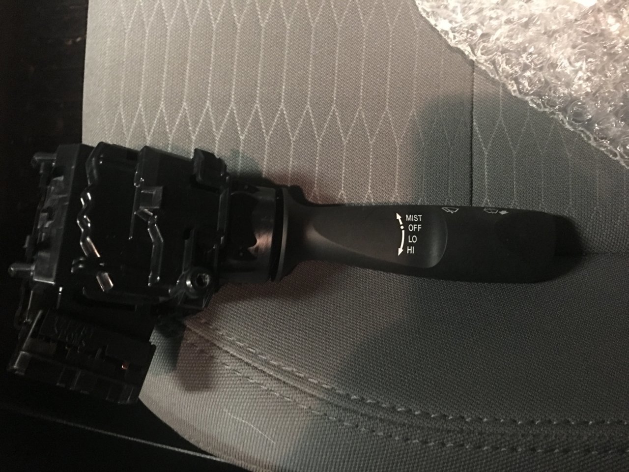

    Thank you moe204 and everyone else on this forum . Just did this intermittent wiper mod on my 2018 SR. Took me a while to get that black clip moved out (luckily I didn’t break it). But after that, easy as pie! Happy camper now. DDC0954D-0868-4003-93F5-405037F71B09.jpg
    The old switch...
