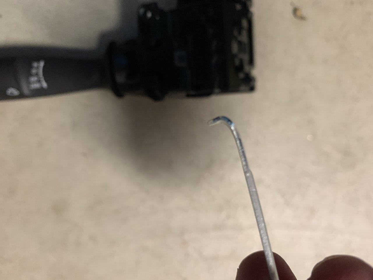

    I just bought one for $39 off a 14 Corolla which I assumed worked (and did work) based on this list of interchangeable parts: https://www.toyotapartsdeal.com/oem/toyota~switch~windshield~w~84652-06340.html
    The same wrecking yard wanted double the money for one off a Tacoma!
    The hardest part was pulling on that center post. I fiddled around with it then decided to bend the end of a thin piece of scrap metal in a vice to make a little puller.57730DBD-AC8E-4759-8F45-487F1816C0E4.jpg
